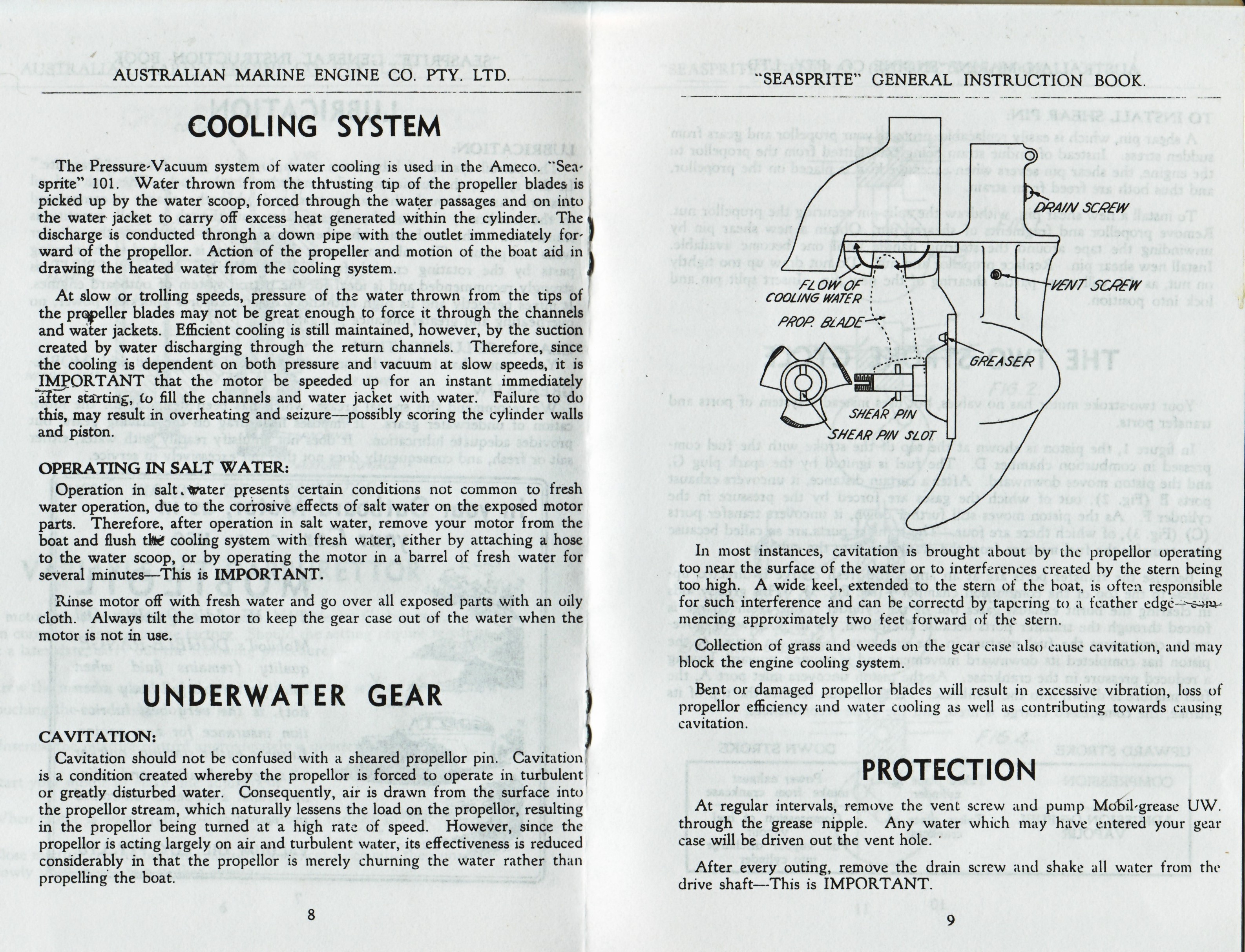

Does anyone have a picture of one with the head removed & one of the piston at BDC?
What moves the coolant?
Re: Australian Seasprite
Charles - It's only a 5 minute job to remove the head so I'll take those pics for you tomorrow Charles.
Water movement is under prop pressure. To better explain, I'll post some pics of that for you also.
Charles
Flat top piston and four transfer ports.......I have no pic sorry.
Prop + and - (push and suck) as per....
Sorry to jump in S
B[/color]

Pictures as promised Charles. In the first you can see an aluminium casting secured to the underside of the cavitation plate. The opening which forms the water pick up is also visible directly behind the upper prop blade, positioned as such to show that water is delivered under prop pressure.
The following three pics are provided to help better illustrate the design of the above-mentioned casting. Note all parts are spares (some unserviceable) from a Seasprite that spent quite some time under water.
Gearcase and water pick up castings.
Water pick up casting showing the intake forward of the prop.
Underside of same casting. Pick up chamber on the right ultimately leading to upper side of the barrel, discharge chamber on the left fed from the underside of the barrel.
Upperside of the barrel showing (from left to right) the fuel,intake manifold, upper exhaust chamber (closed off by a bronze cover plate as shown in the assembled photo) and water intake.
