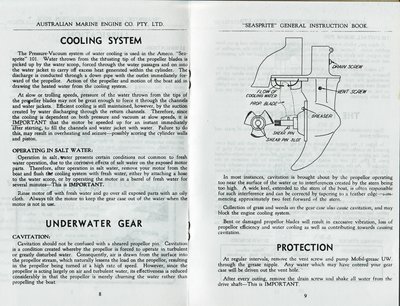

Does anyone have a picture of one with the head removed & one of the piston at BDC?
What moves the coolant?
Posts: 989
Re: Australian Seasprite
Charles - It's only a 5 minute job to remove the head so I'll take those pics for you tomorrow Charles.
Water movement is under prop pressure. To better explain, I'll post some pics of that for you also.

Charles
Flat top piston and four transfer ports.......I have no pic sorry.
Prop + and - (push and suck) as per....
Sorry to jump in S
B[/color]

Pictures as promised Charles. In the first you can see an aluminium casting secured to the underside of the cavitation plate. The opening which forms the water pick up is also visible directly behind the upper prop blade, positioned as such to show that water is delivered under prop pressure.
The following three pics are provided to help better illustrate the design of the above-mentioned casting. Note all parts are spares (some unserviceable) from a Seasprite that spent quite some time under water.
Gearcase and water pick up castings.
Water pick up casting showing the intake forward of the prop.
Underside of same casting. Pick up chamber on the right ultimately leading to upper side of the barrel, discharge chamber on the left fed from the underside of the barrel.
Upperside of the barrel showing (from left to right) the fuel,intake manifold, upper exhaust chamber (closed off by a bronze cover plate as shown in the assembled photo) and water intake.
Underside of the barrel showing (from left to right) exhaust port and water discharge.
Photo of the internals of the barrel (best I could do) from the crank case end showing all 4 transfer ports (as advised by B), fuel intake and the upper and lower exhaust ports. Several others on their their way to you via pm also.
Hope all helps.

Interesting & very different, would it be possible as it's in bits to do a brass rubbing of all the ports on a bit of paper cut to size to cover all the bore & label them, so all can understand all the port locations.
