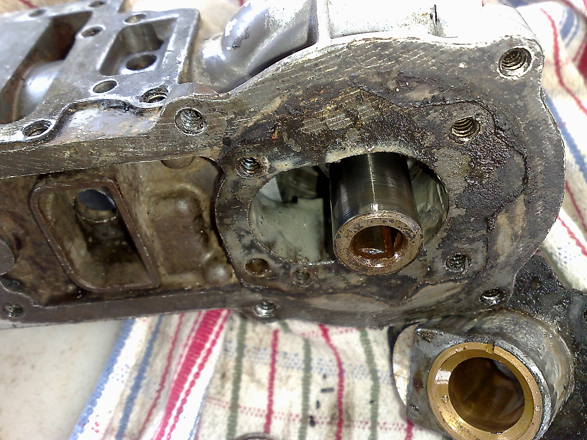

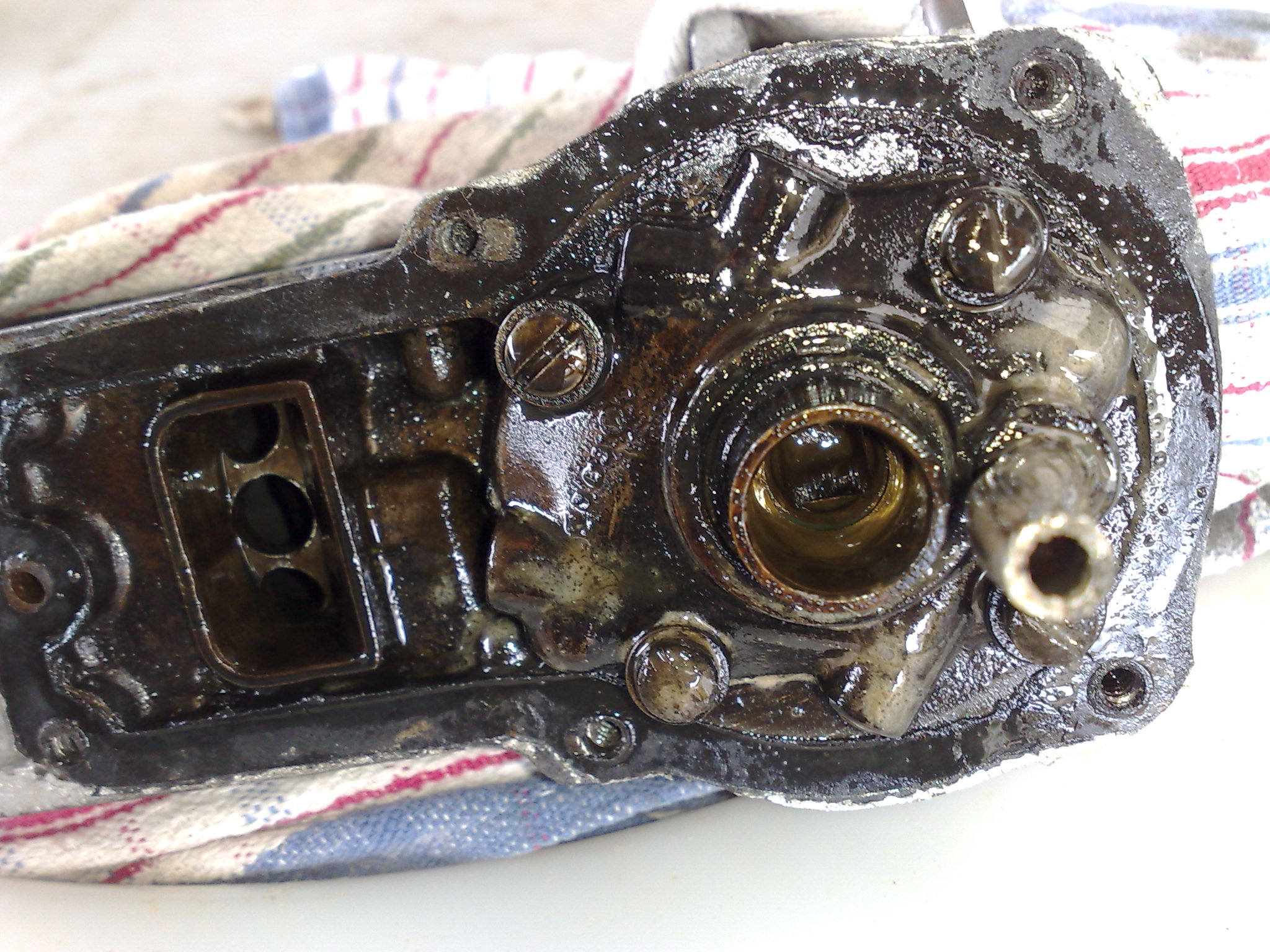

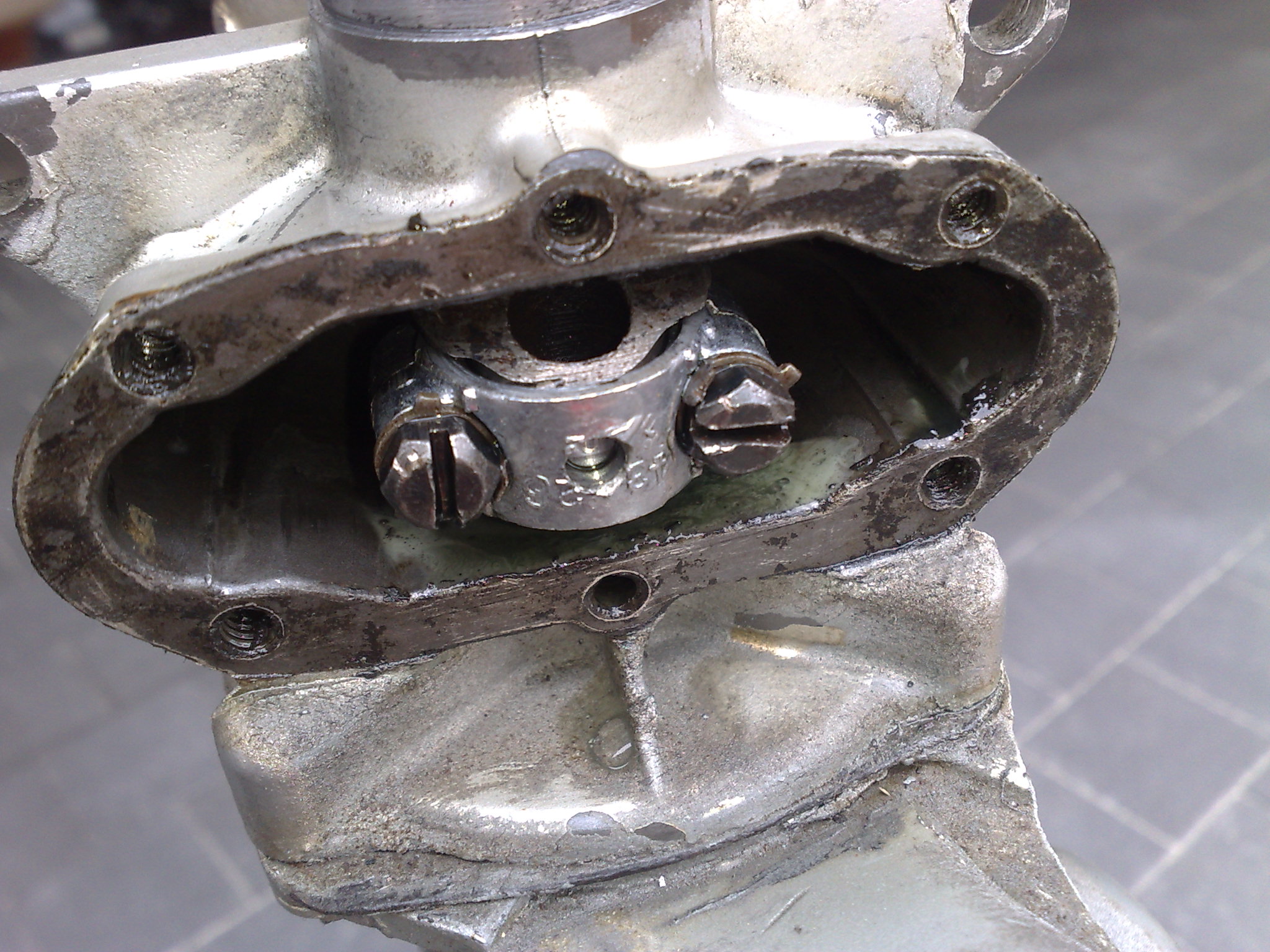

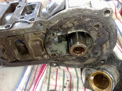

Woke up early and with coffee in hand went outside and gave an affectionate twist of the flywheel.
STIFF?
Plug out and water. Internal leak bugger!
I was going to just put off pulling the wee horse down until Xmas holiday and new year............glad I noticed now as it would be a mess inside if I had not noticed.
Water in combustion chamber and the crankcase.
The thing is a fresh water motor so cool!
The only place that water can get in would be from the lower bush assy. Correct as the gasket has stuffed up.

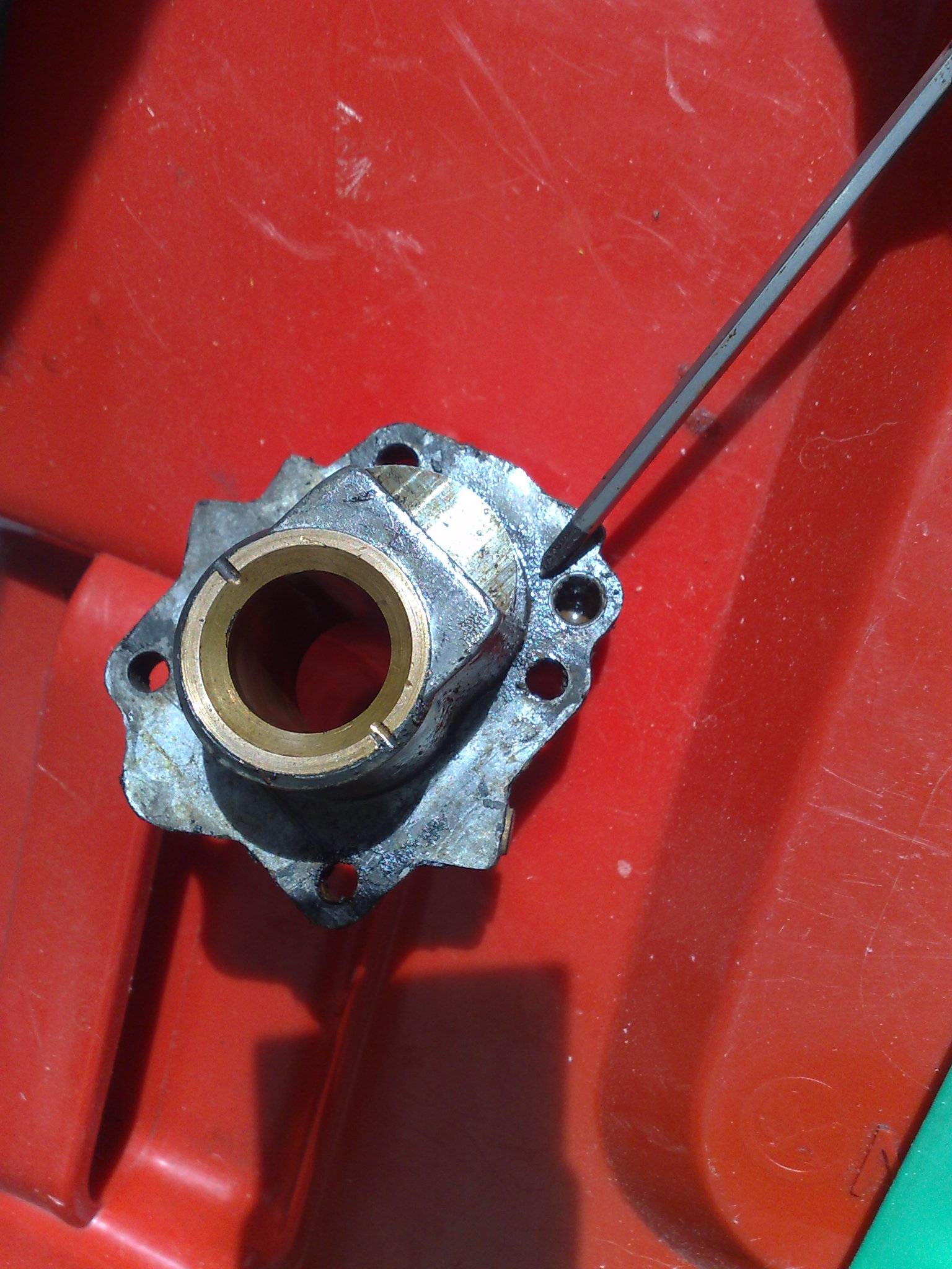

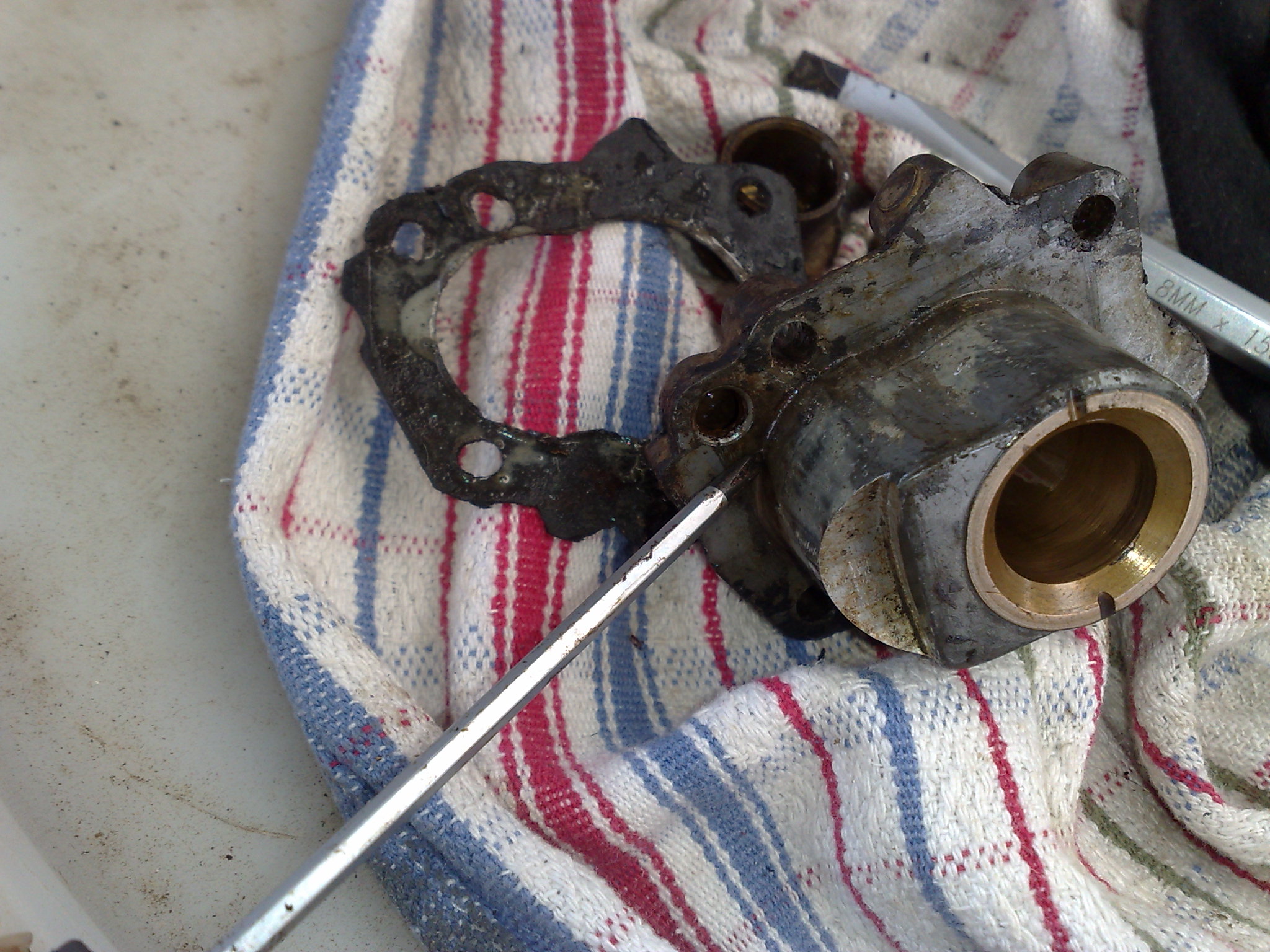

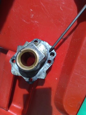

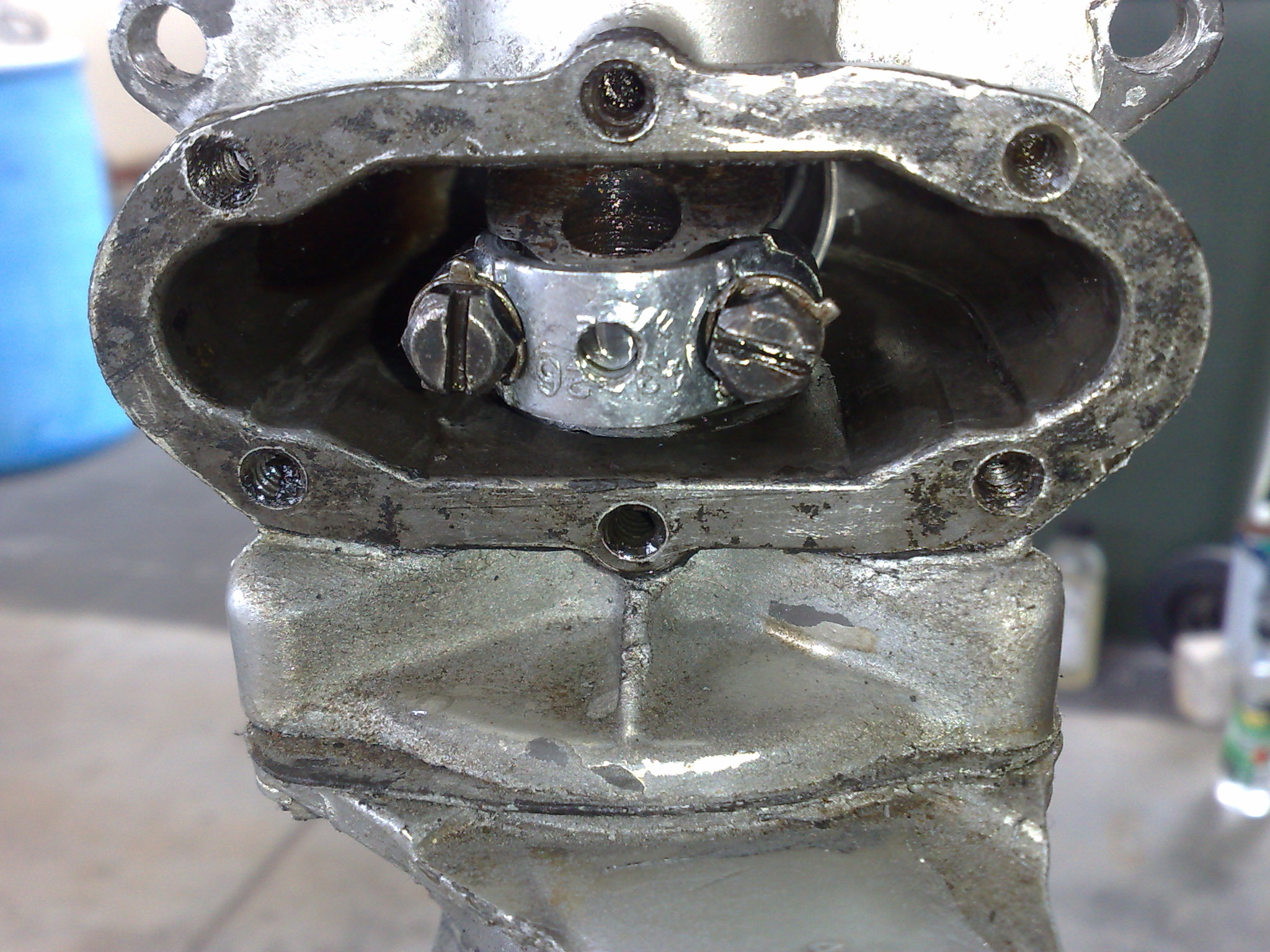

Next.
This where the gasket failed.
Now to hand make all the gaskets. I used to be very good at doing that a long time ago.........

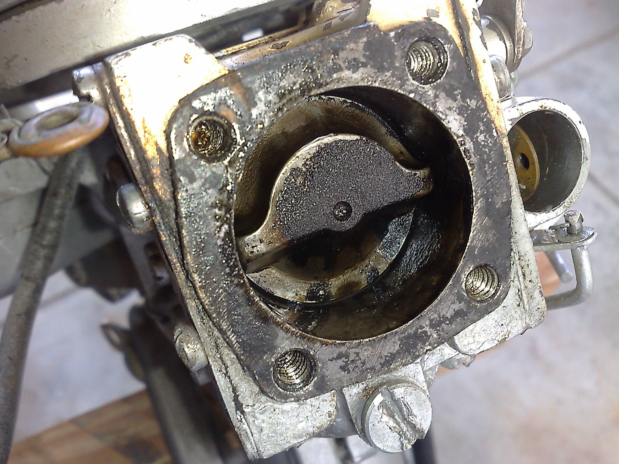

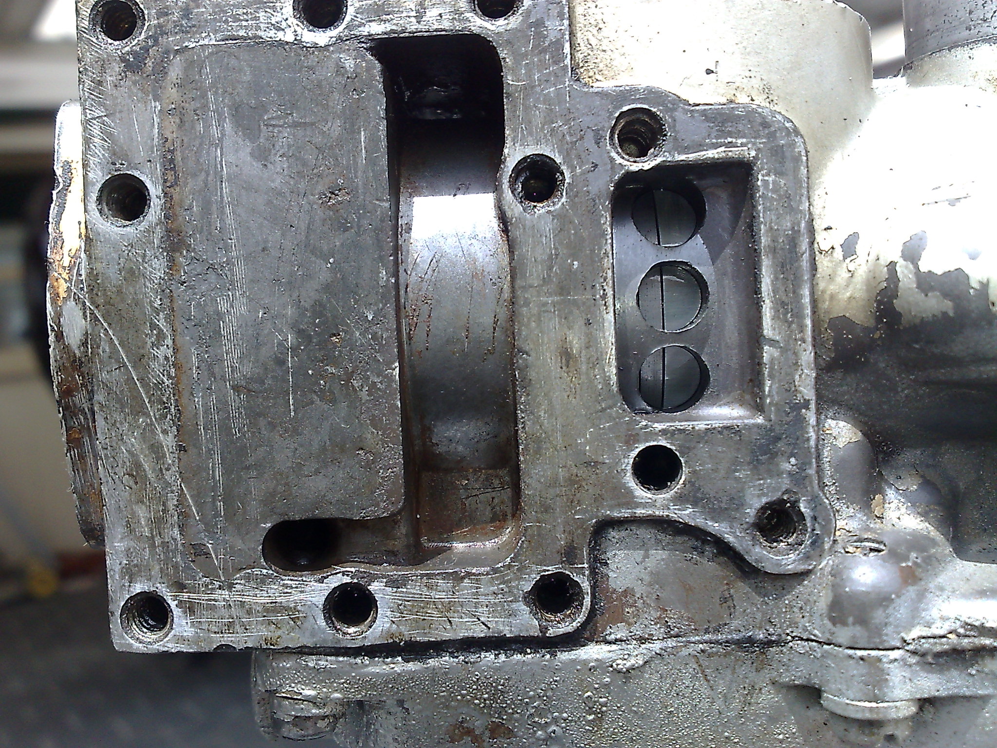

One more thang in that when you have an Old Horse serviced and running..........do not put off the basic check of......
Checking these things!
Over all of this time.....76 years and other owners...........tension is required aye.
