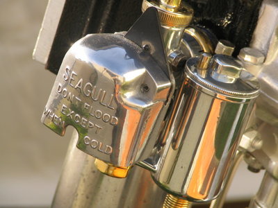

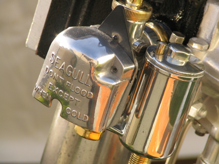

You also need to spend a few minutes polishing the carb.
- Stelios_Rjk
- Posts: 1458
- Location: Athens - Greece
- Posts: 4825
Re: The best way to get back home
The insides of that one must look like Rolex built it, if it's not just an ornament.
Hugo I've worked out how you can pay your rent if your coming over here, must order a couple of pallets of polishing soap!
- Posts: 758
Very impressive but do I detect a spot of dust on the top of the inlet cowl!!!

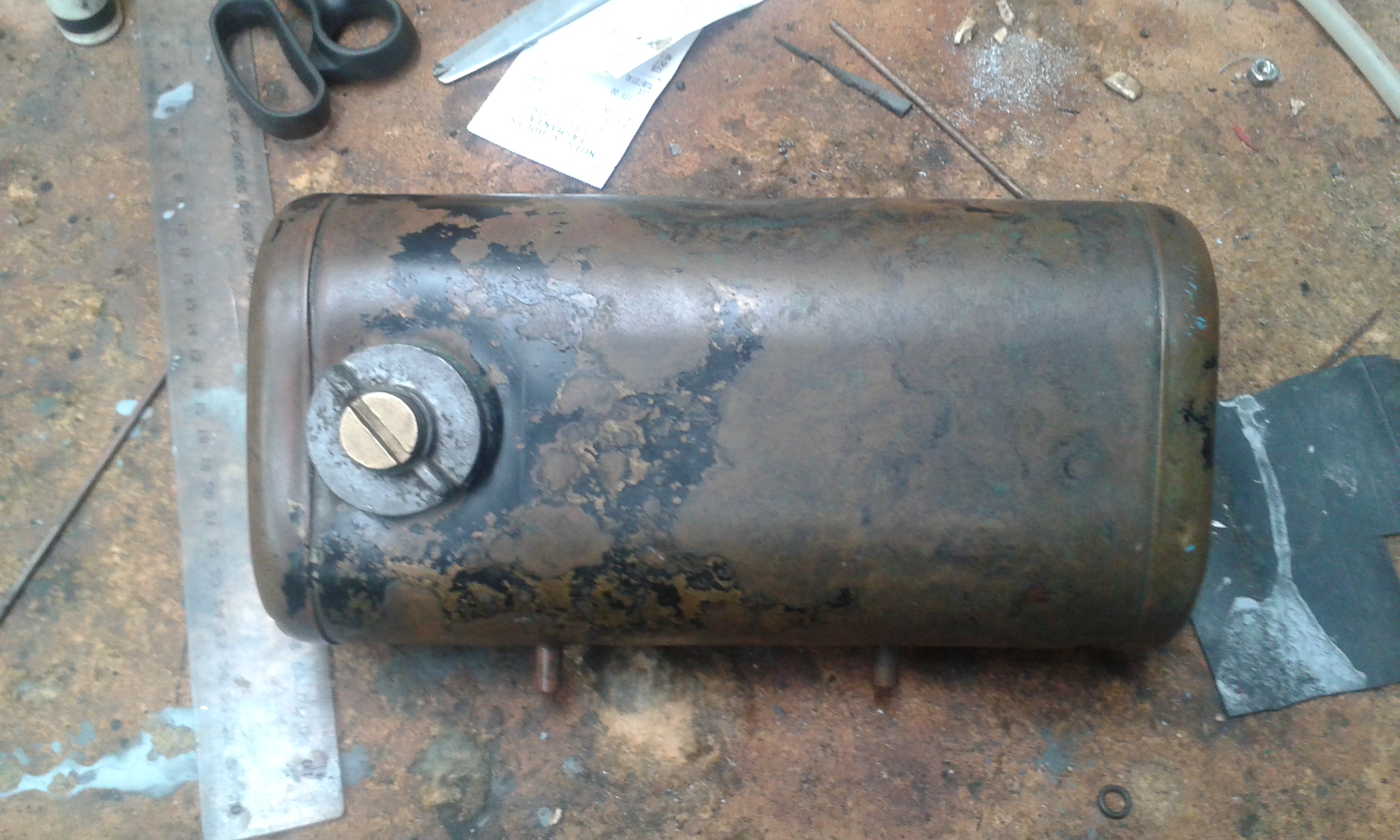

as I generally keep existing decals with out disturbing them does this mean I can get away with out touching this tank!!!!!!!!!!!!!! (off LS24747) I know its faint but if search a bit to the right of the filler cap wallah a faint shadowy line.posting.php?mode=edit&f=2&p=43827#

that tank is an ideal candidate for a "refurb".
Strip what paint is left and re-paint with a good quality primer.
Then check to see which dents you can reasonably fill with body filler (the cheats way but also the easier way)
Prime the tank again and re-check for any more dents,repeat as required.
2-3 coats of black and leave to dry for a day or two.
Then see how it looks when it's fitted back on the motor? (at this point you need to decide whether or not to apply a decal or leave as is)
Go on ,give it a go, you might surprise yourself.

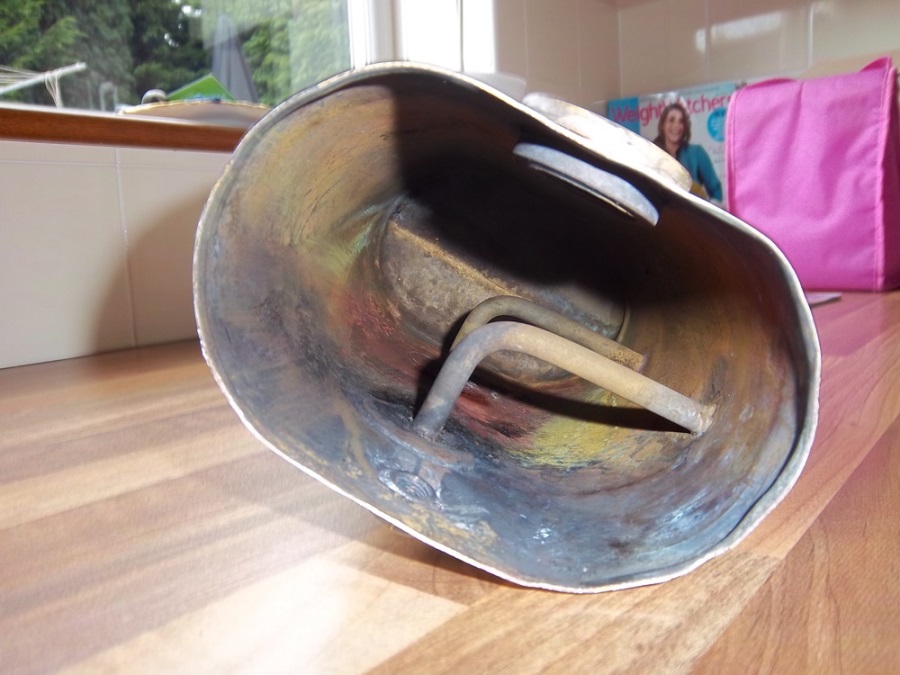

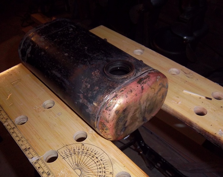

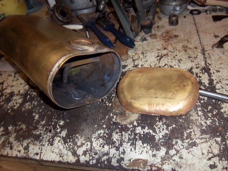

I have not tried touching in an original decal, but have teken the damaged end off one tank and replaced it with a good taken off another tank. Golden rule when removing use a large propane torch and apply loads of heat, and let the end fall off. DO NOT try and prise it off the flange will be ruined. Heres a few pics. H-A is the master of these! Check out his video on youtube.

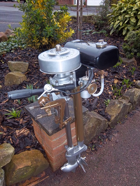

I sold this one (SJM310)onto thin down my collection and the buyer assured me he would look after it. A couple of months later it was back on the bay with a stoved in tank end, yes the one I spent many hours making like new
Yes i have taken an end off a tank before and screwed it up good and proper.
Taking it off was the easy bit, getting it to stay in place was something else? (havn't found the right solder yet)
Gas torch not a problem as i have one at work that easily does the job (makes it look silly really)
