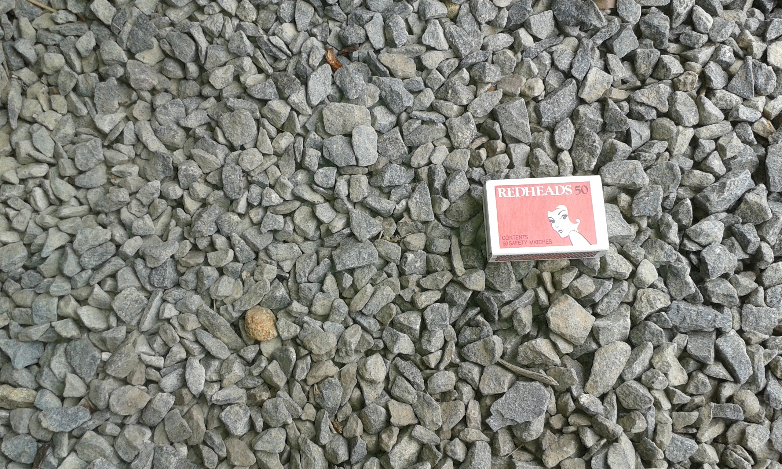

Took a couple of photos, first of blue metal and the second of gravel . The blue metal comes in various sizes all the way down to 5mm. The example in the photo is 25 mm.
The photo of the gravel is from a Tasmanian road. I have some 30 kl of this to drive to reach our house so I often have a grumble at the state of the pot holes and washout that need negotiating. About once ever 6 months the council runs a grader you and down the road to reshape it.

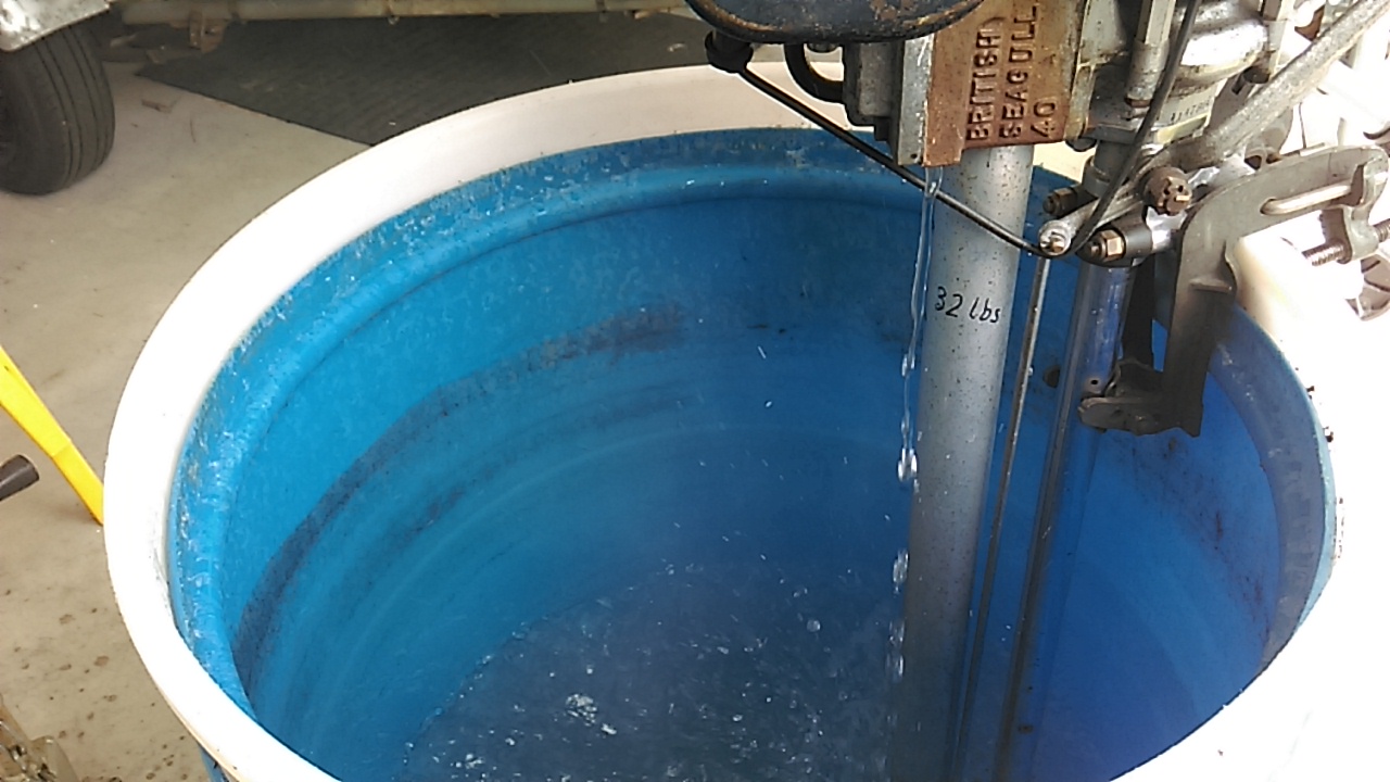

Adrian,I have the same gravel on my driveway like you do. I will do some more cleaning this coming weekend. The idea of cleaning the tank with degreaser and call it good - resonates with me well tonight
I think I may try to start it up this weekend too.....would like to see if I will get good stream of cooling water going trough the motor....and how it will run in an idle.
Thank you for your input guys!!

OK...I have everything back together, and today I started the motor.
Test went well and I am ready to install it on the boat.
....could not attach video
