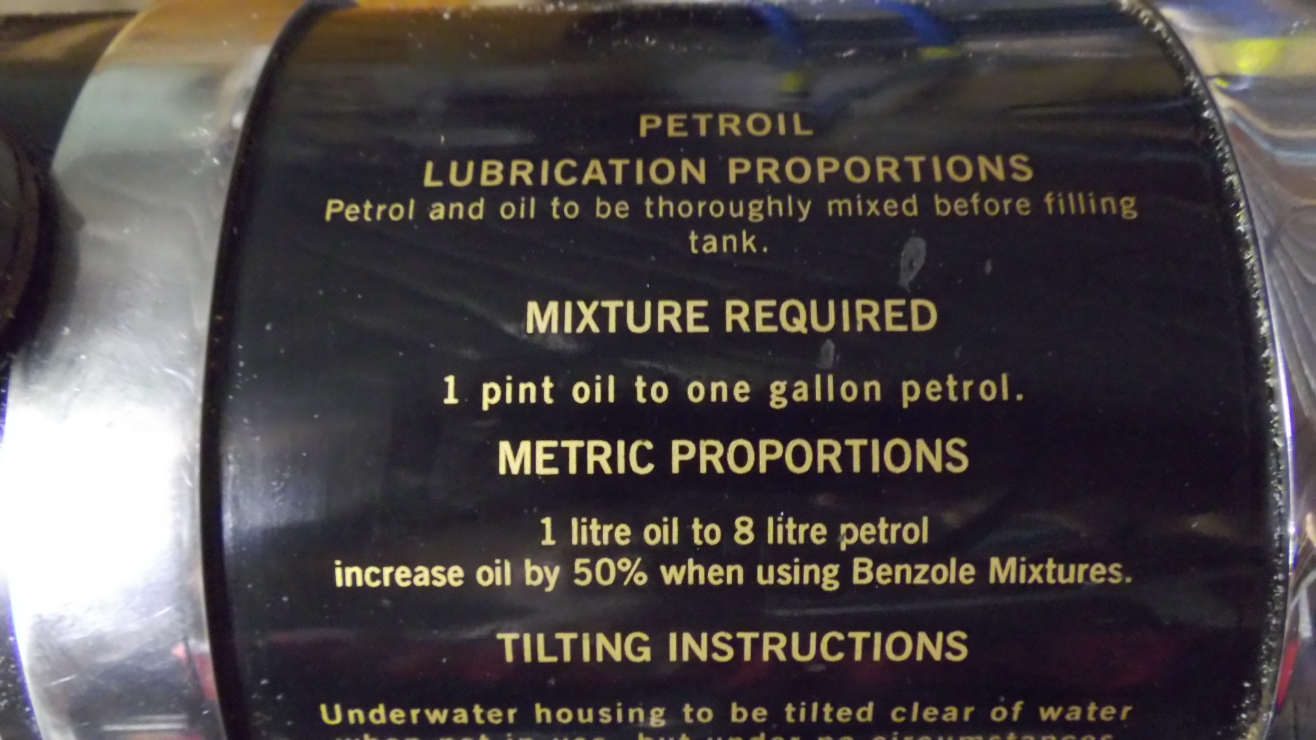

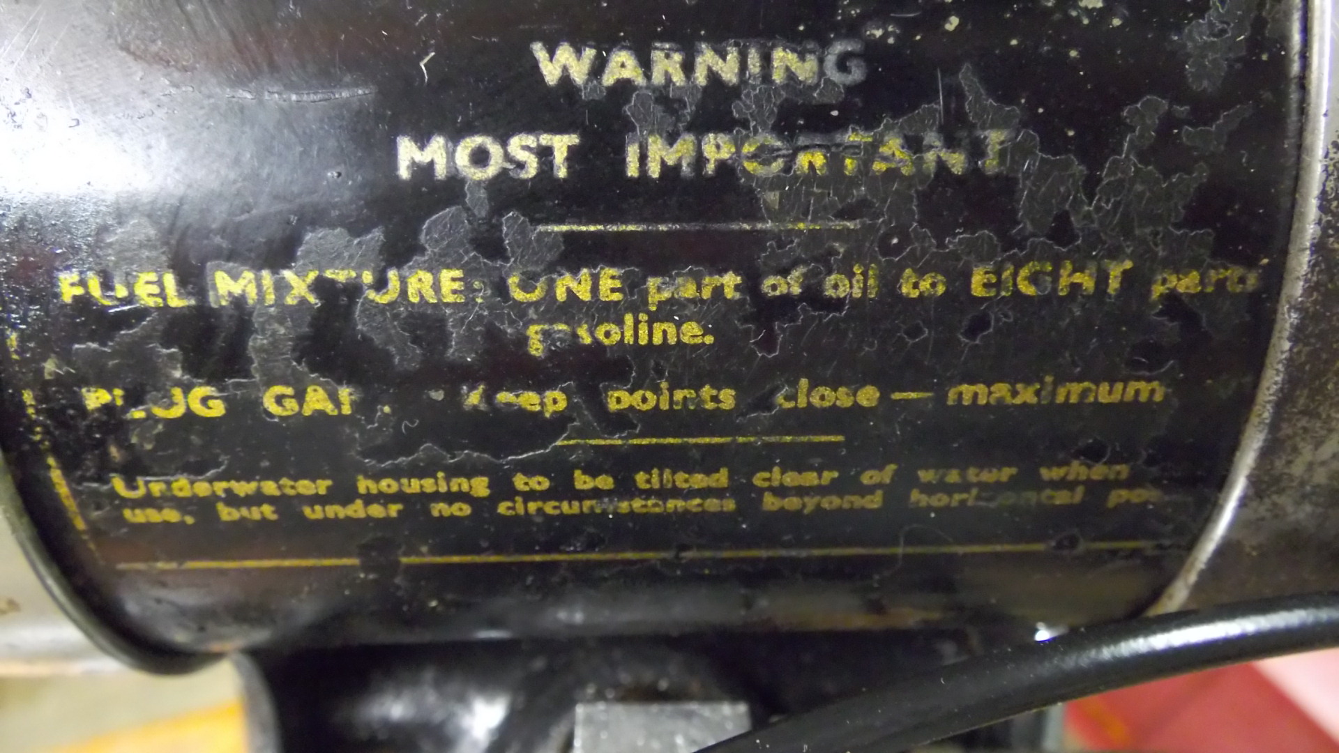

Here's a pic of the tank of a 102 I'm trying to sell ... what do I tell the buyer, if there is any, about the fuel mixture ?
and a pic of the tank of another.....

G'day Hugz, the old label is the 102 I''m trying to sell (AD860), if it does not go by the weekend I'll pull it. Check out Gumtree.
Re: 10:1, 8:1, or wot ?
Yes, a very early AD with brass tank and bayonet cap...? Thought you were selling tank only
Edit: AC and somebody has nicked the clutch, probably the same guy that is selling the $500 AD with clutch. Pop a plain cover on the mag as the lettered ones came later (and are more sought after) If somebody bought both of them they would have two nice early AD/AC's with two rare tanks... Adrian?

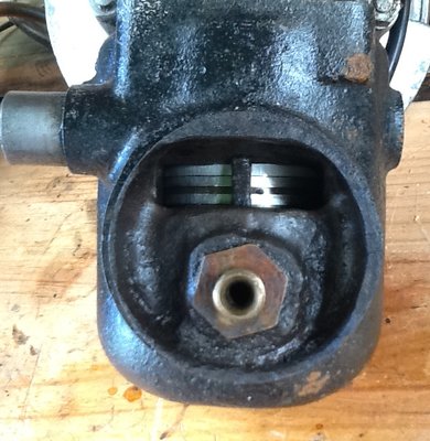

p.s does AD860 have the hex head core plugs in the cylinder? (good if it does as this will be the correct cylinder for it)

Interestingly that the tank with 8 :1 has screw cap so the AD/AC did first come out of Seagull with 8:1 unless it is off a D or C

Seems to me that the imperial measurement gives 10:1, 16oz. (1pint) to 160oz. .(1gallon) = 10:1

We are talking "Imperial Pint" 20 oz. = 8 : 1, remember these are imperial motors.

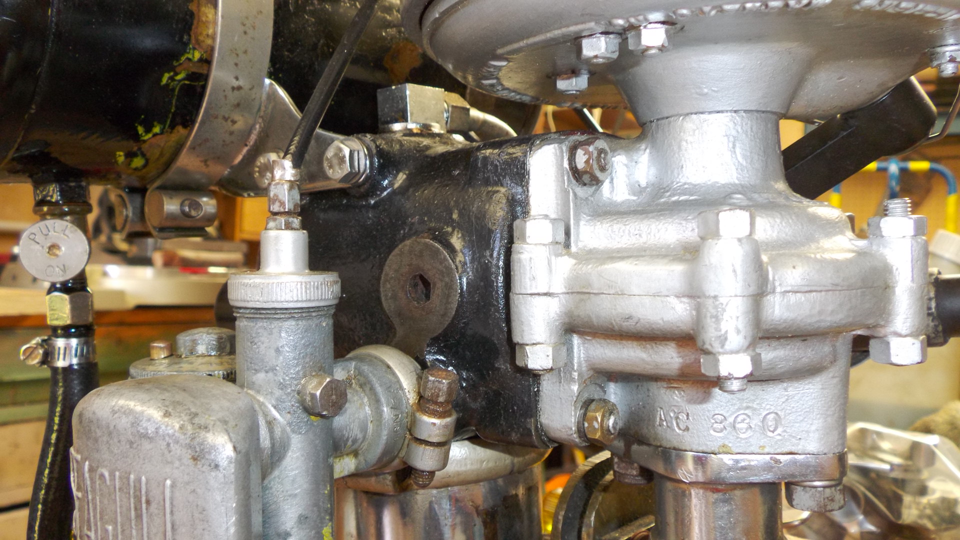

AC860 before assembly and side view
