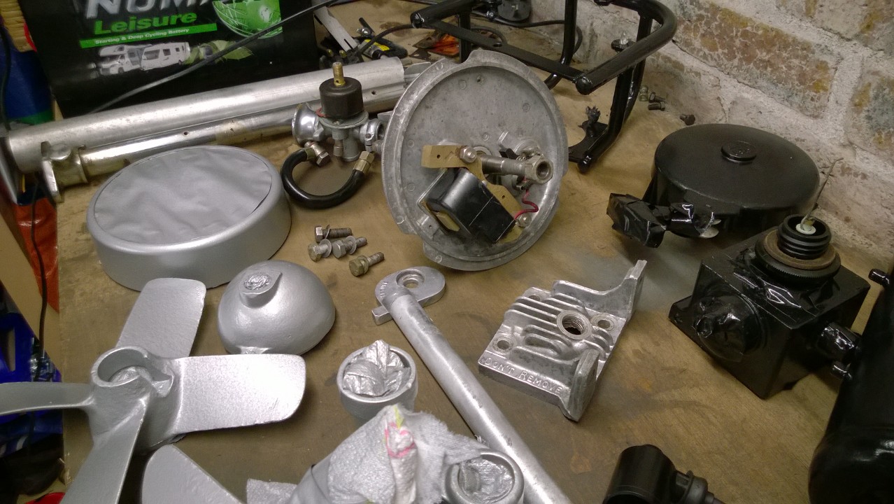

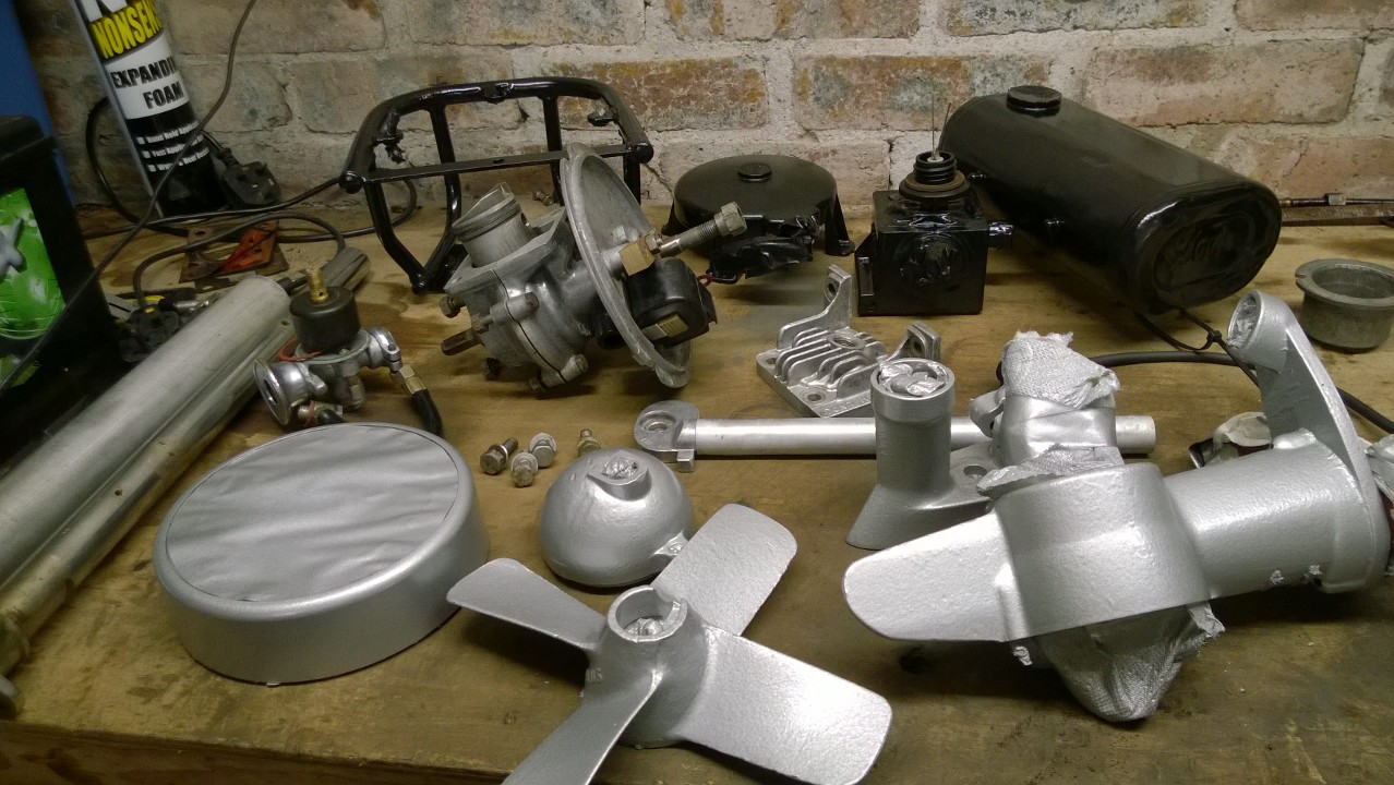

Hi... These are some pics with the engine in bits so you can see what parts I used.
