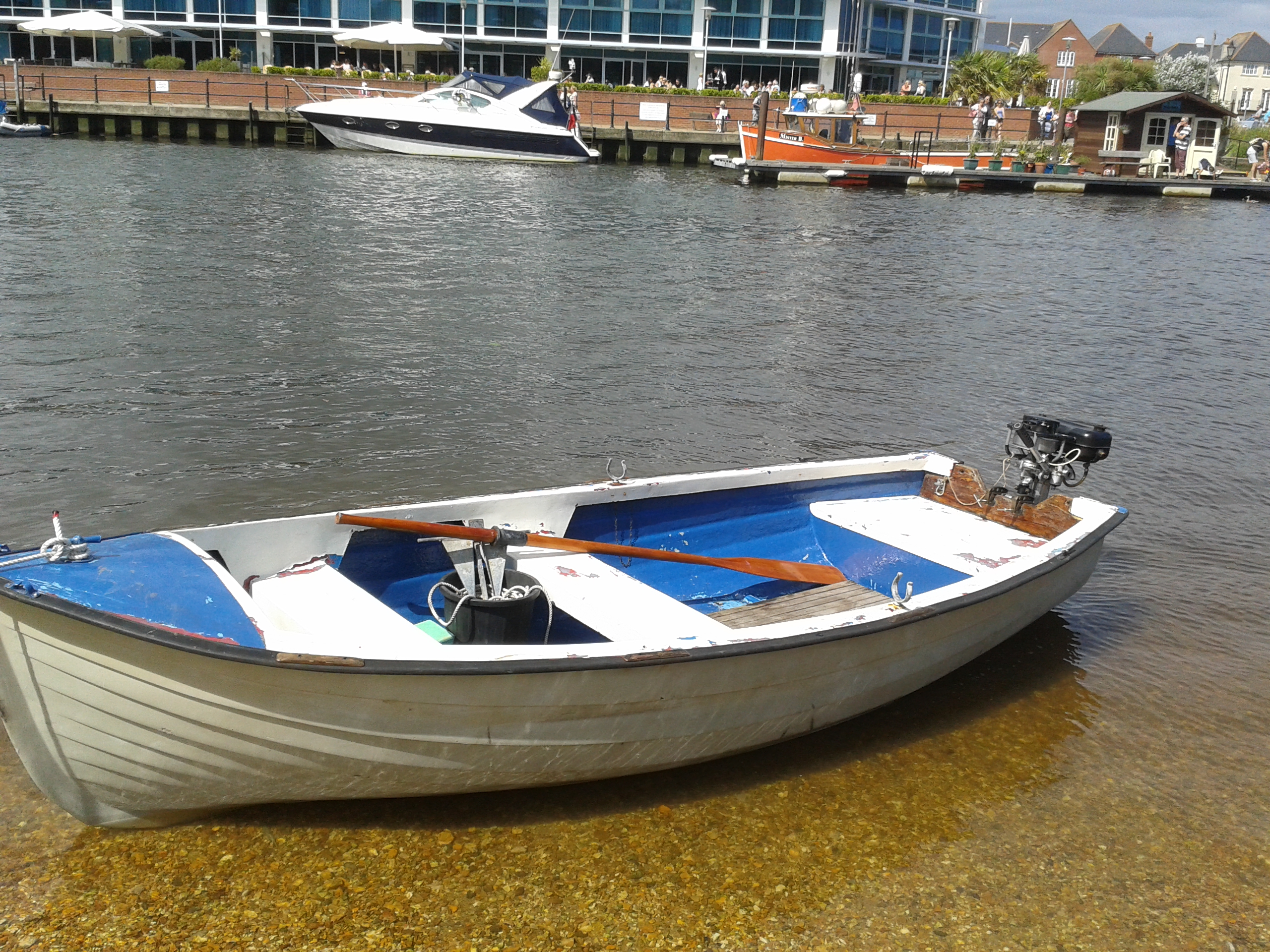

Boat and seagull had the maiden voyage today, went well.
