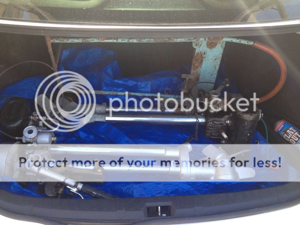

Today I went on a 165km round trip to Barragup (suburb near Mandurah WA) to have a look at some seagulls that I was contacted about. At first glance they seem complete and one has the original spares book.
One is SJP22051 and the other SJP654H5, both 40 series if I am correct. The gentleman I purchased them from said that they had the original stand, which I got in the deal but that is questionable, has anyone ever seen a seagull outboard stand before?
The SJP654H5 is seized from sitting and the other's gearbox is locked up from the old oil/grease.
That one I think will run easily enough.

Hi BP,
Looks like a good score with the Seagulls, and lucky to get the handbook also.
Im not sure about the Engine Stand, as it looks like a home made one to me, but I could be wrong.
Hopefully you will get them both going, with a little bit of TLC. Sometimes you get lucky with a seized engine, and it frees up easily, and sometimes its just for parts. Unfortuantely, Im becoming an expert on buying parts motors. :roll:

Posts: 4825
Re: My first Seagulls
All the Seagull stands I've seen had 3 removable legs, the lighter models had aluminium legs & the heavyweight version, chromed steel, that were fitted to the motor board with 3 cast brackets with "Seagull" cast onto them.
I've not seen any evidence that they were sold to customers, (not mentioned in price lists or brochures) but were provided for distributors for display purposes.
If you search old threads I'm sure several pictures have been posted in the past.

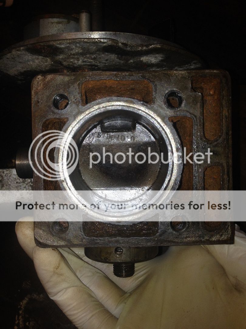

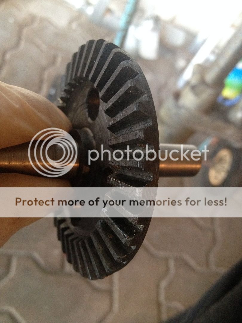

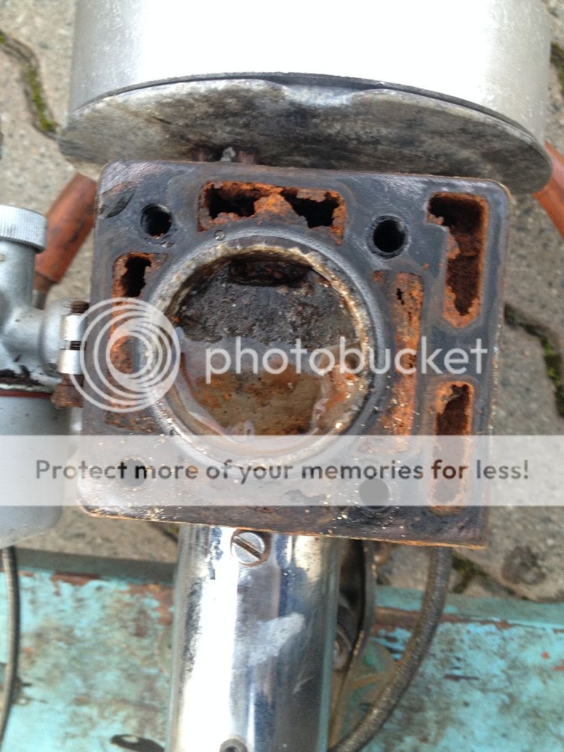

SJP22051 has the gear that drives the prop shaft stuck in the gearcase housing which is restricting how far I can turn the engine over ( 1/8th of a turn either way). I will give it a soak in kerosene or diesel and see what works and if that may free it up so I can do spark and compression tests. The flywheel/magneto assembly dates (I think) to 1959.
The prop shaft is not bad for a 55 yr old motor -
SJP654H5 has its powerhead seperated from the leg and will be fully apart shortly - I now know that the piston is seized in the bore.
When the cylinder head came off at first -
After a little cleaning -
More coming soon!

Well done with your efforts so far.
It is only now that you can start to appreciate just how simple these little motors really are and why they corrode so much in certain areas!
A little bit of correctly applied maintenance once in a while will go a long way with these.
HEAT (and sometimes lots of it) will be your best buddy when stripping down an old engine like this.
Gearboxes dont usually give much trouble when stripping down, except perhaps the drive pinion, or a stubborn screw.
Dont be scared to heat the aluminium gearbox casing quite a lot to help "expand" the metal enough to drift out the pinion.
Arm yourself with a decent plumbers type blowtorch and some solid steel bar to act as a drift to push out the pinion.
Word to the wise here, before you start removing the pinion check to see how much play there actually is in the pinion! If it's still acceptable, then leave it alone. (it might just cause you more problems later on)
I often find that trying to seperate a gearbox from the pumphousing gives rise to a lot of cursing and swearing! :shock:
Once again, heat is your best buddy, although go carefully if your motor has an aluminium exhaust tube fitted.(dont want to melt that)
A gentle rock from side to side (sometimes twisting) while everything is still hot is normally enough to get things moving.
Only use a rubber hammer as a last resort.
Stick with it and you'll get there.
Help always on hand, just ask.
Posts: 4825
Do not use a steel drift when driving out the pinion shaft & bearing, brass or aluminium will save you running the risk of chipped teeth!

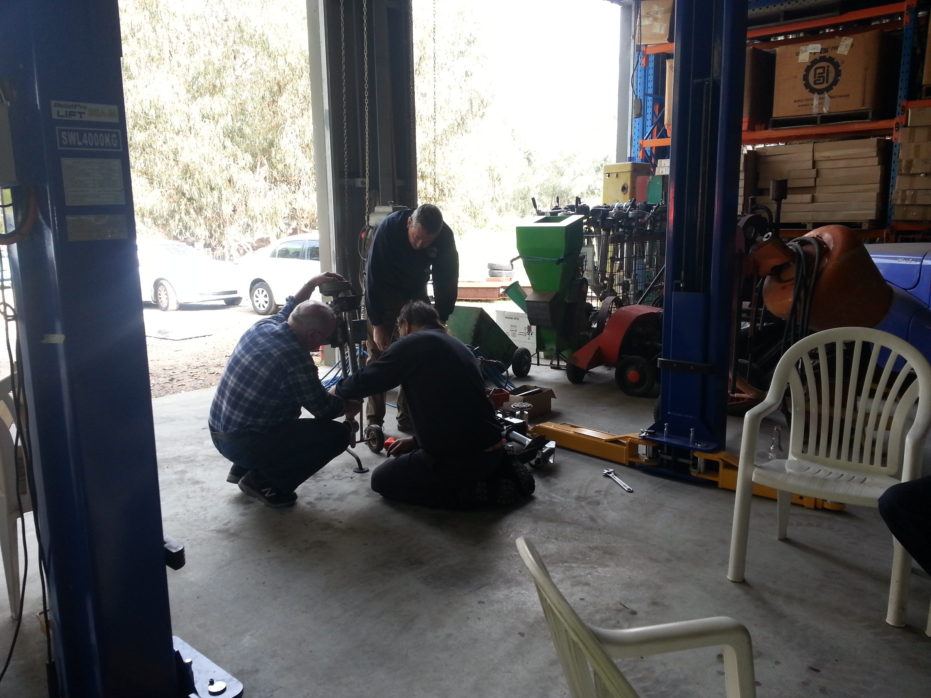

Was a good 1st outboard meet on Saturday Aye.
I hope that this will be a start for a West Australian Collectors Association or similar. I believe that this is what you were indicating last week.
SG and Myself enjoyed your effort in getting an initial seven of us together in one shed. Sadly I had to help Laura and electrical in the afternoon.
I stood back and took pics after setting the scene and enthusiasm.
My MapGas is now empty but the Gull is apart :P
Sadly "Mike The Pilot" and one of my 3.3Hp Muncies stayed in the boot that day.
