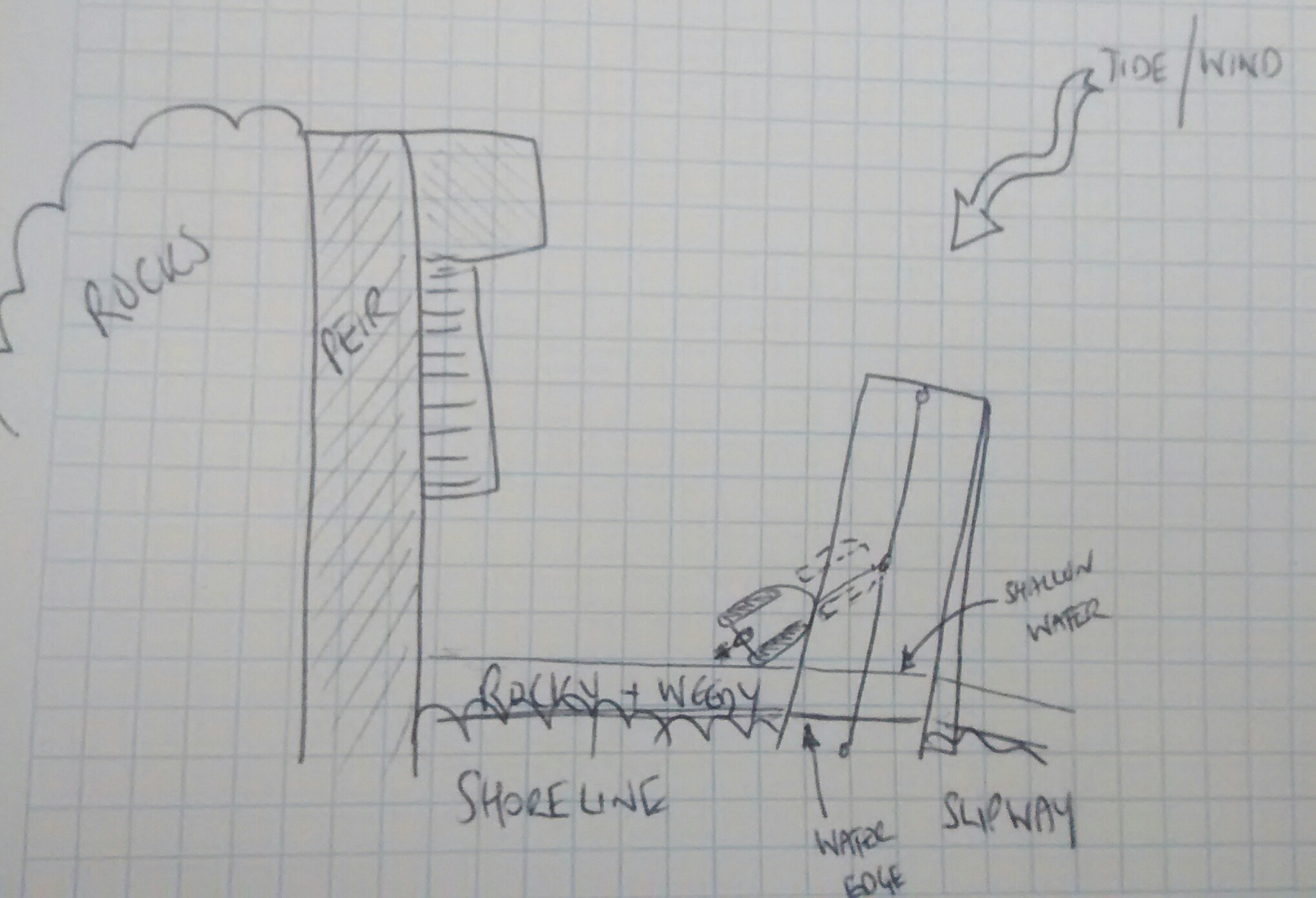

Sorry this may not strictly be a 'Seagull' issue its probably my lack of boat skills thats the issue! I've only ever used powerboats with clutches and reverse gears so last week when I was sea-trialling the new seagull I seemed to struggle with my "departure" technique... So wondering what I'm missing!
Basically in the picture below I have a sloping slipway, with tide/wind crossing it at about 35 degrees. To the western side of this (the picture is North Up) is a peir. Shallow water is a mixture of weed and rocks. There is a rope down the centre of the slipway to tie onto. Wading in as deep as my wellies allowed got the engine into deep enough water to start the engine. Had this been on a modern conventional engine I'd have started it in neutral, left it to tick over a few moments to warm up and probably with the engine in reverse and hard to port use it to pull the stern round clear of the shallows before slipping the painter , neutral drif back a couple of feet and hard to port move off forwards... With no neutral before I can even get the throttle to tickover shes pushed forward onto the slipway (dotted outline). Hard to port and starting didn't seem to work, she still pushed onto the slip and if you try hard enough the prop hit the slip too. So what should I have done? Fend offwith an oar? Hard single handed when trying to pull start. Longer Painter? But my painter is puposefully the same length as the bopat to stop prop fouling? Springs? Where and how and single handed am I stressing too much about all this rope going into my prop? Or row out and start at sea?
Was I just unlucky with my slipway and wind tide angle?

So it sounds like Paddle it is.
Coming ashore is not a major issue for me as I'm going to fit a kill cord. While I realise the risk is low, there is a mental message to get across to the wee man who will be with me that OBs need KCs as he will also be learning to drive a 40-50HP in a couple of years time... That will I hope also mean I have more scope to quickly start and kill the engine as a test ignition before rowing out.
I have been considering if there is a "non-seaman-like" way where I'd attach a towing bridle type configuration across the transom (too short to reach prop), then a loose line tied to the slipway and clipped to the towing bridle. Tide and wind will push it clear of the slip to allow starting. Once started she would sit pulling at the tow line going no-where. Then when ready to depart and throttle reduced to just above idle, I can steer while still tied on - using the rope as a radius and then disconnect the "tow line" at the bridle and chuck it clear of the engine... to retrieve when I come ashore later... (provided the tide was going out not in...). Rowing is for sissies!

The line that you are going to chuck clear............what about other boaters and their propellers being tangled while you are away?
You mentioned "Non-seaman-like" so that would confirm it.
Get to practice oars..........definitely not sissy at all.
