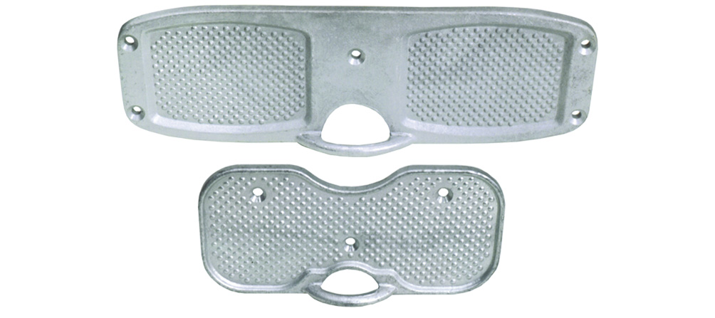

I personally favour Aluminium, as the clamps dig in and hold well.
This type are good

Re: Seagull deep six
I like those pieces and will try to source one. Like the indent to prevent the round contact thing from walking off the top of the transom. I've used the rubber pad on various boats and motors for years. Never had a motor move before. But, heavier motors, much more robust clamps.
Do you have a link to the aluminum plate you uss? USA or ebay?
