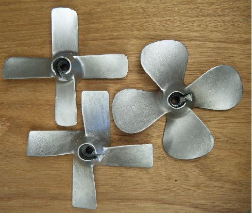

Where on the blade do I measure or calculate pitch ?[attachment=0]1- 050.jpg[/attachment]
Posts: 794
Re: Complete Propeller range pictorial database
This is one simple way that I found on youtube.
https://www.youtube.com/watch?v=Uzv_m_Gm1es

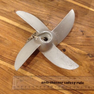

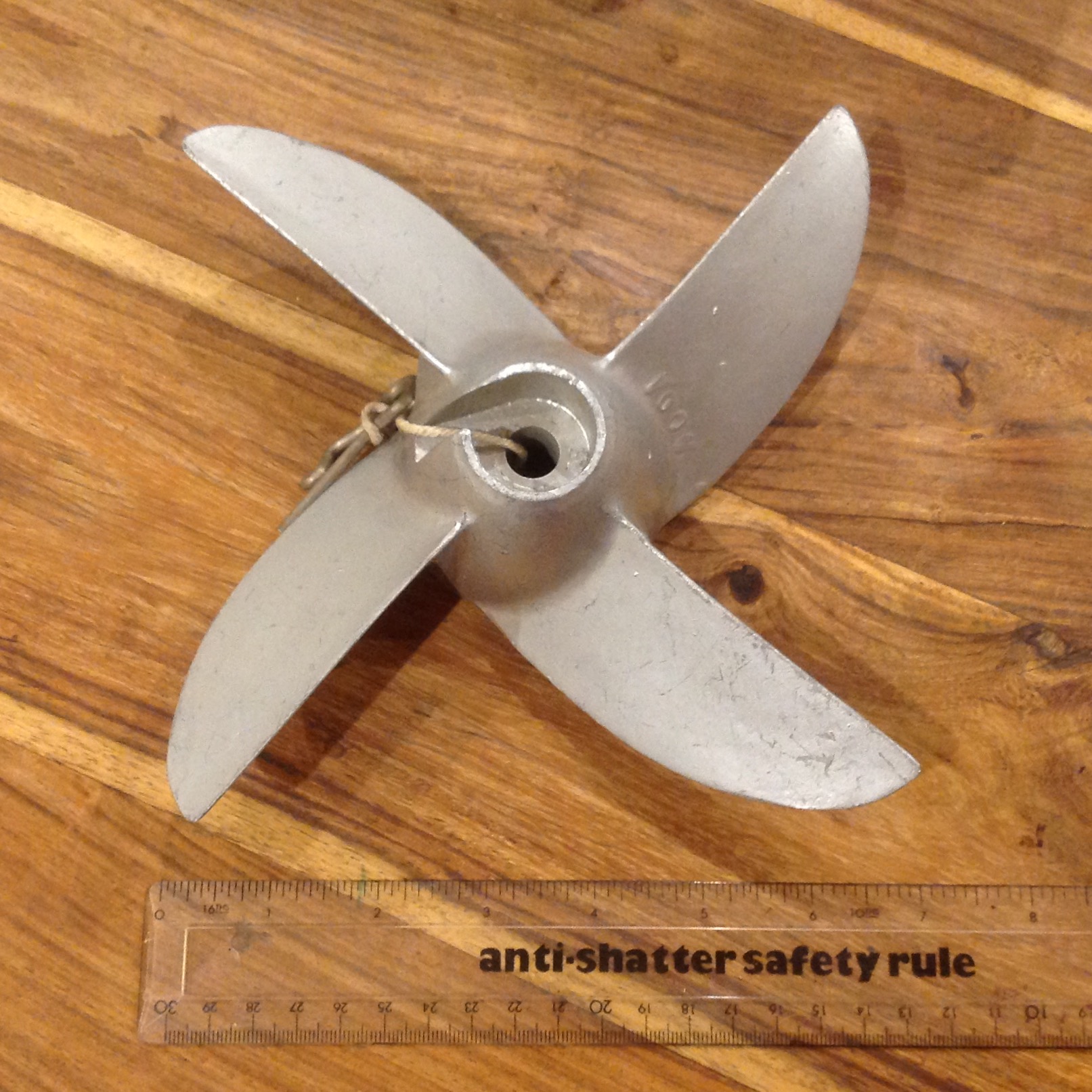

Until recently I had never seen or heard of a trolling prop for a century, the first one I saw was at a boat jumble and an old friend explained to me what it was, then one popped up on eBay, poorly described, I grabbed it just for its collecability, it's NOS and it's definitely for a century with 100 cast into it even though it looks a little 40-ish.
For those not familiar with trolling props, they have a small surface area making them inefficient, it means you can go really slow and still have the motor at reasonable revs so the water still circulates and doesn't foul up the plug, great idea but not many about.
Posts: 794
Never seen one like that before, thanks for sharing.
It looks like 4 knifes!
I think it was made like that to cut the line as you drive over it!! :roll: :lol: :mrgreen:
