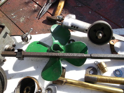

Where did you find that sunshine to be able to take a pic like that?
Are you able to post a better pick of the prop? What markings are on it?

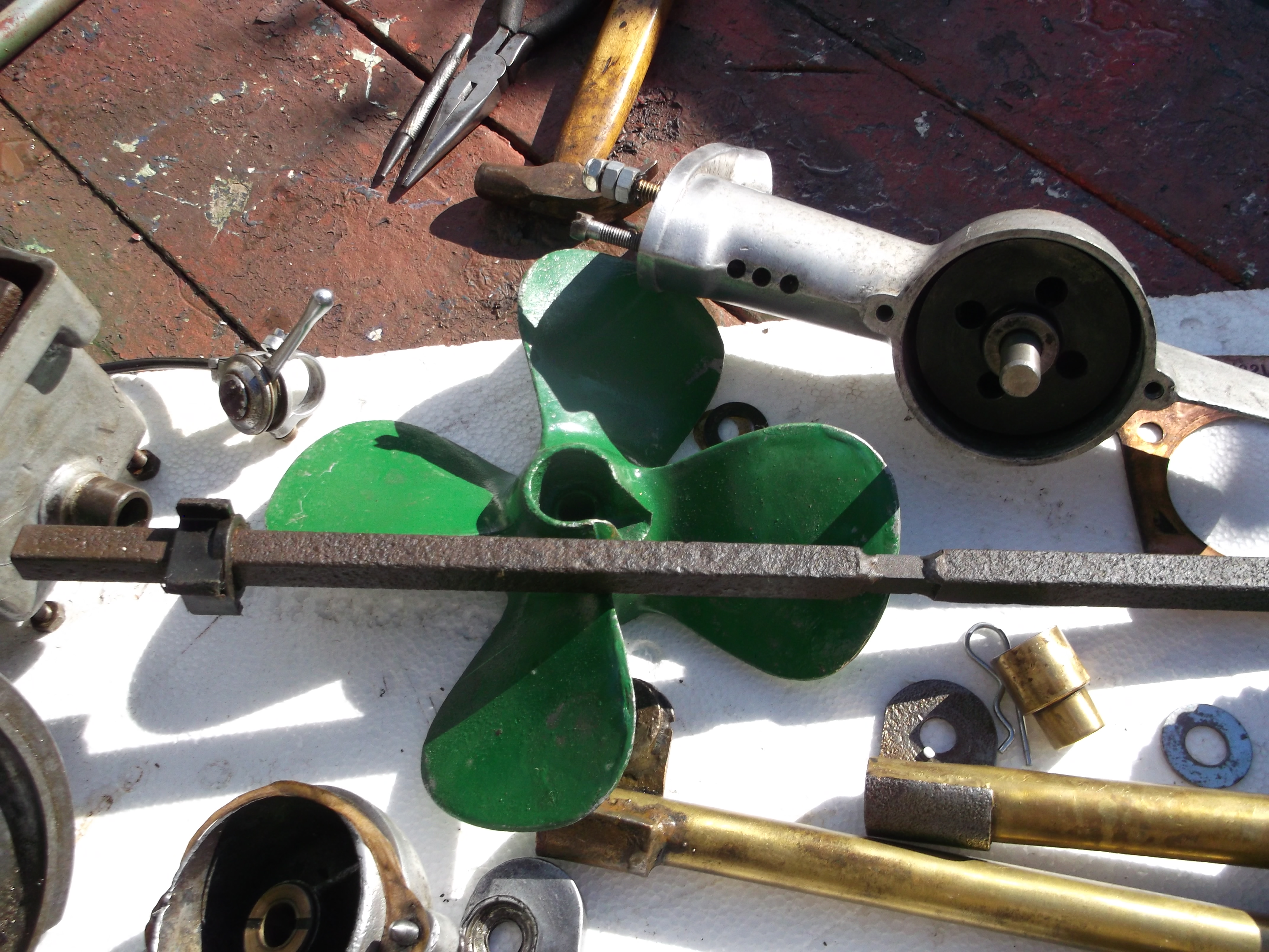

We had a period of great sunshine the other day which I took advantage of. Warm as, winter lurking.
Just another perk of living out here in the wild west.
The prop shown , 4 bladed is marked "100 only"
Do you have an interest in it?
Its yours if so . Definitely.

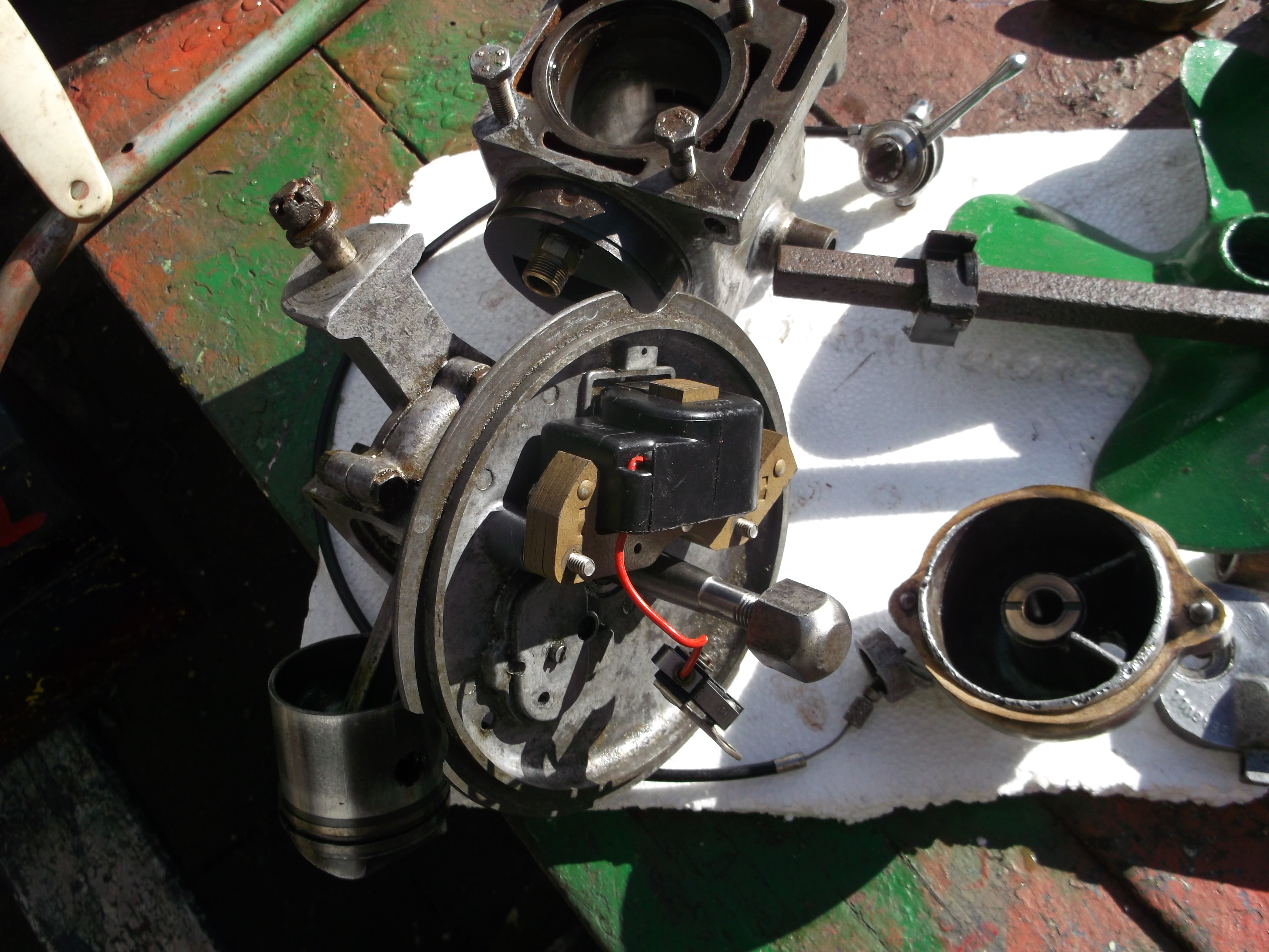

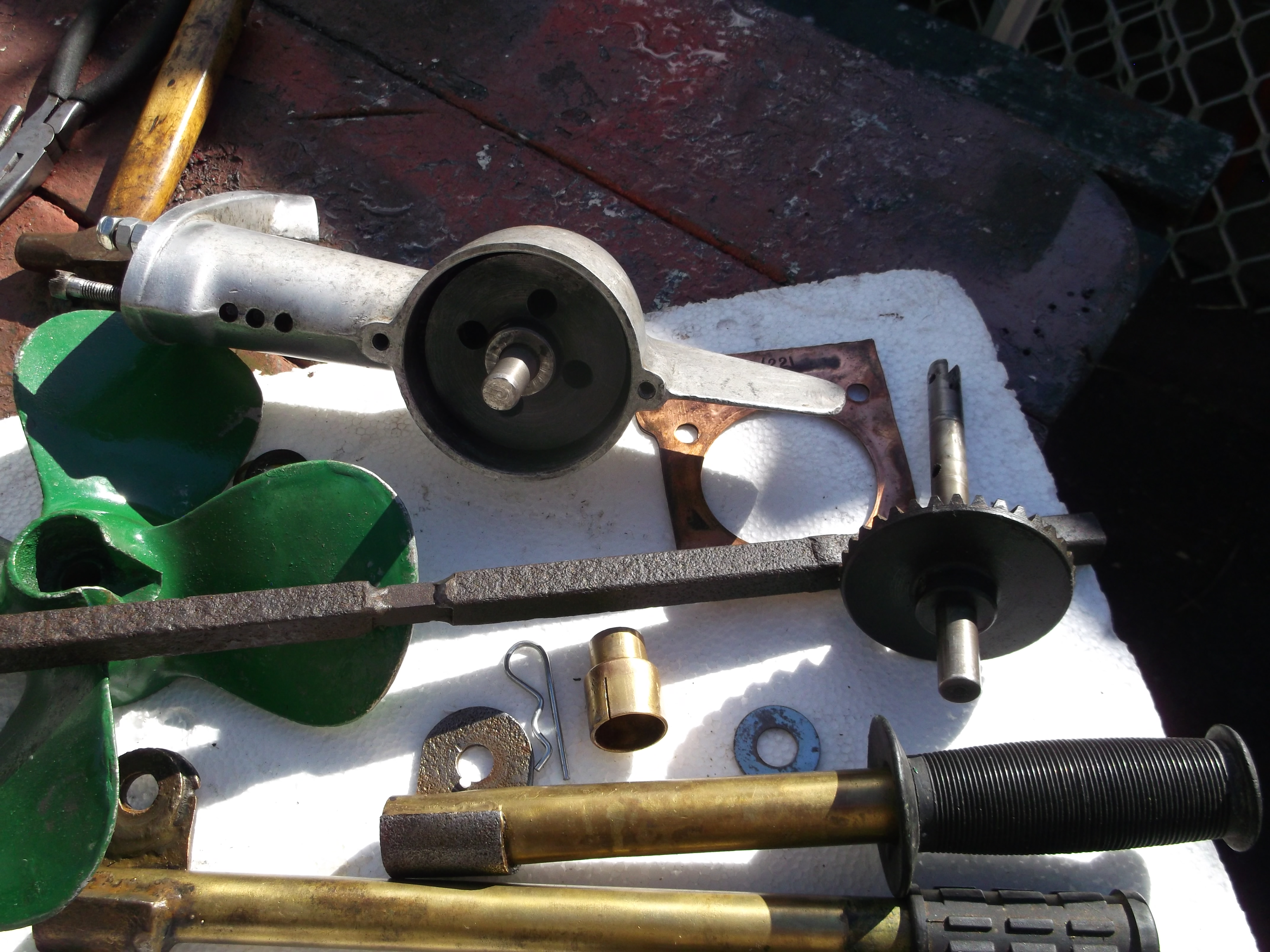

Have put up another pic showing the brass reduction plug used by the previous owner to run a Villiers carb on a silver cent block.
Don't know how good it went.
Will be sticking to annealing the brass h/gaskets.
