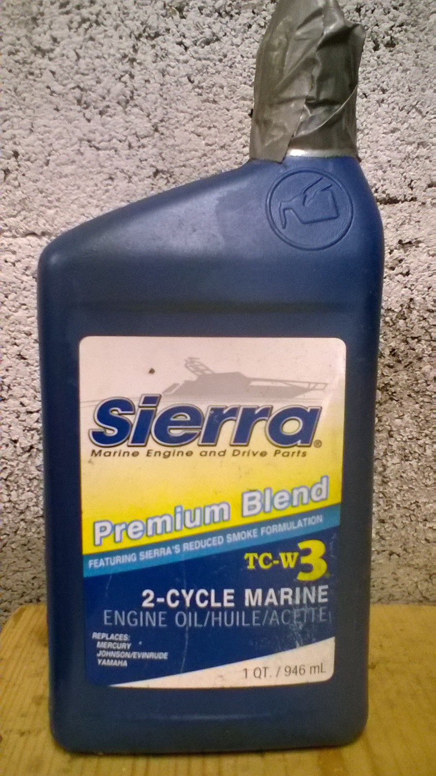

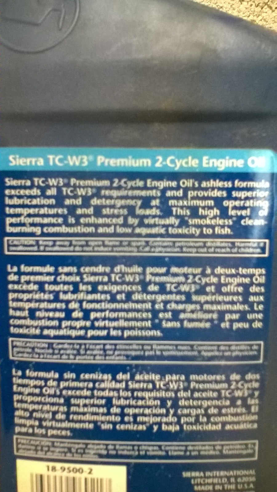

Good work Jon, about time we go to the bottom of the oil conundrum, it's the one topic on here that there always seems to be so much disagreement on.
Which oil brand are you currently using in your seagulls, is it the same brands for all of your gulls including the really old ones?
This is the oil that I am currently using. All of my Seagulls are pre 1978 and are run on 10:1 Petrol:Oil mix. Charles has mentioned Fully synthetic tcw3 and Semi synthetic tcw3 and tcw2 in the previous discussion.
I think my tcw3 is semi synthetic, but I cannot see it written anywhere on it. This stuff is very expensive over €10 for less than a litre.

I'm currently using ROCK MP3 (sport), a semi-synthetic marine outboard oil. I buy it in 5 litre cans which works out expensive at approx. £40-50 depending on where you buy it, but in a seagull engine that probably gets used for 10-12 hours every year it goes a long way. Pretty much all the modern semi-synths do a very similar job to the older mineral oils with the added benefit of the newfangled shear stabilisers and detergents that are blended into them. Essentially these oils still retain all the properties that you older guys seek with mineral oils, but with modern blends of additives to improve (sometimes enhance) the general performance of an older design of engine.
I use this stuff in ALL of my gulls including the really old ones, and they positively thrive on the stuff. No issues whatsoever despite all the hype currently.
