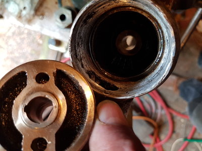

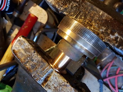

Managed to get it apart
I was also able to use the bush to chase the threads at the open end, tapped the aluminium back in a bit then back and forwards with the bush to chase the thread.
Will have another go with the help of a battery drill to improve the threads where the cap fits, that means now I will need to make a new cap, screw cutting a fine left hand thread in ali, should be interesting.

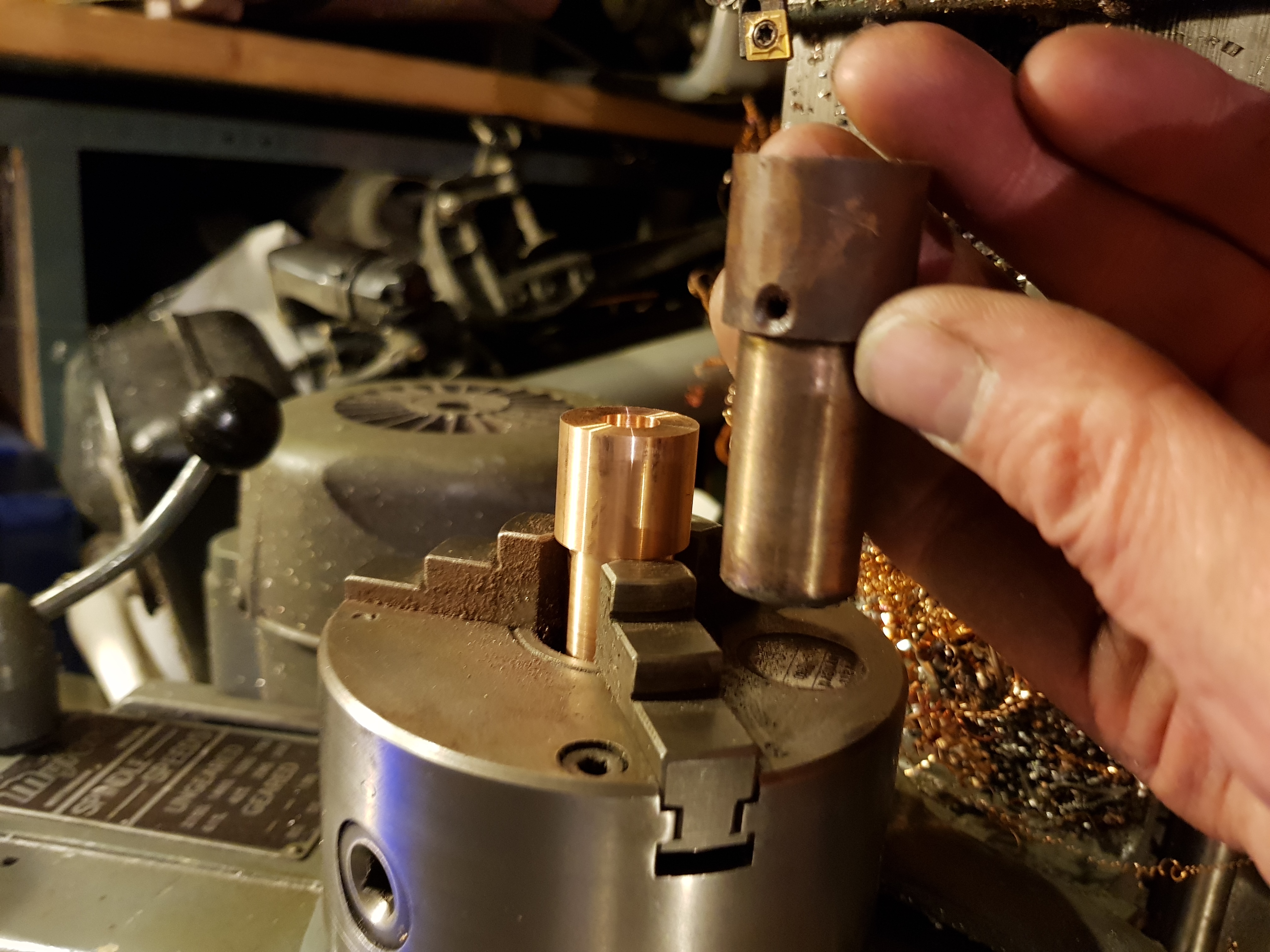

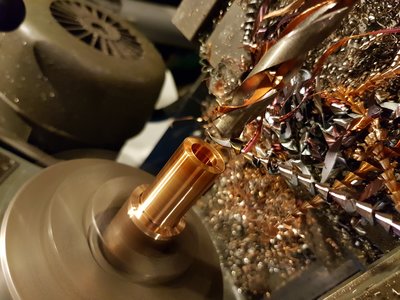

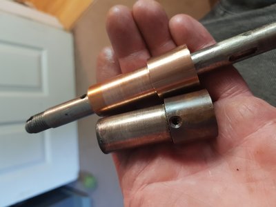

Bored out the bearing that had been replaced at sometime.
Made a new bearing, not sure what the bronze is but it is very hard, could be Aluminium Bronze, swarf was coming off blue.
squeezed in the new bearing, now just need to bore and ream.

by Horsley-Anarak » Wed May 30, 2018 8:49 pm

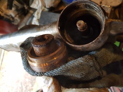

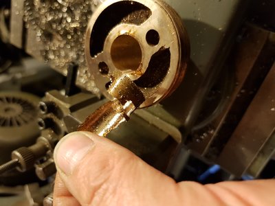

Removed the rear bronze bush, used a bit of 10mm studding and a couple of nuts with a just under 3/4" sleeve.
made lots of graunching noises on the way out.
Machined a new bush and reamed it to 1/2", will wind it back in the way it came out.
Crown wheel is a little odd, keyway and also a pin through the propshaft to hold it on.
