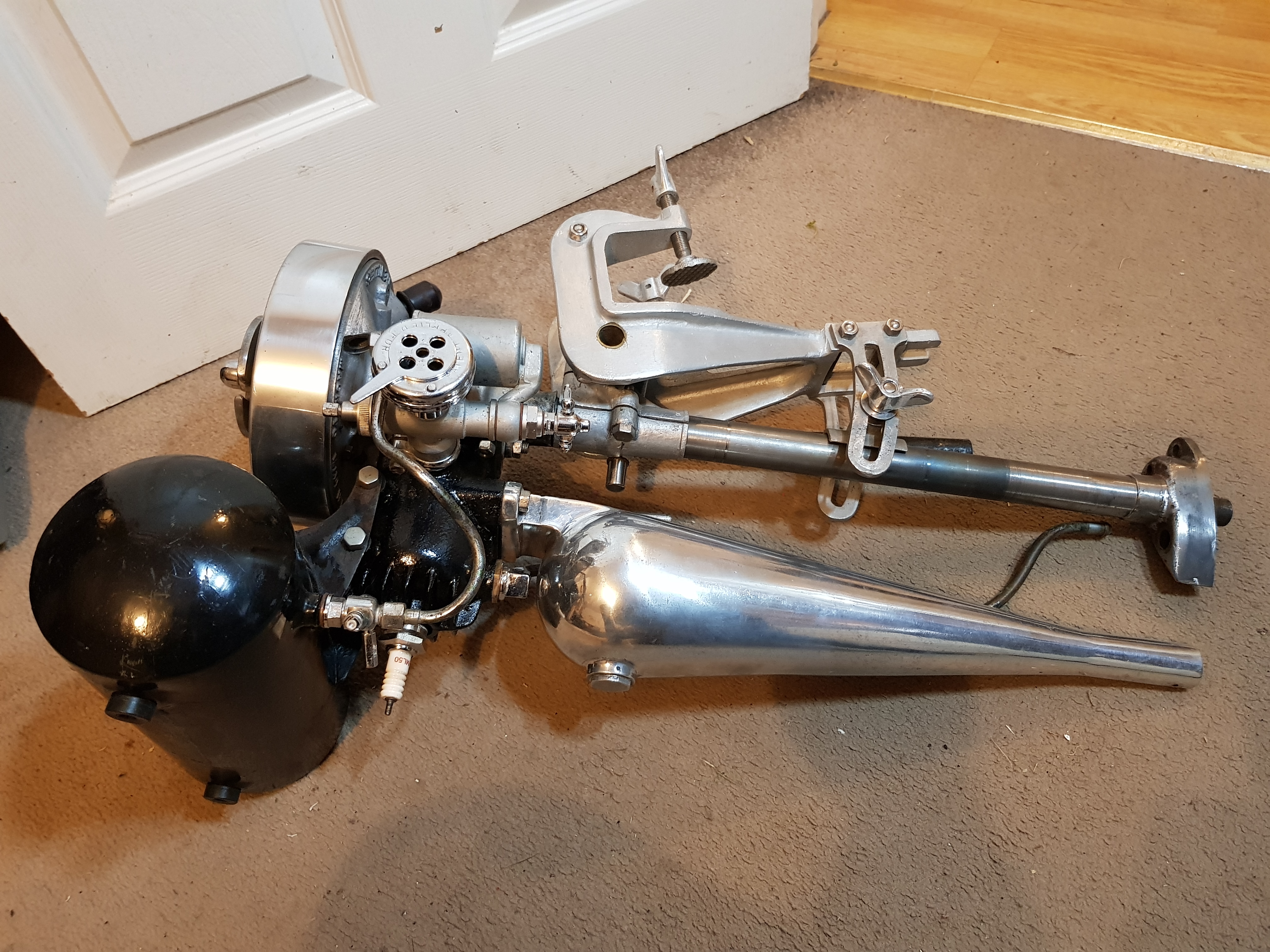

Re: Restoring a Marston OA
Getting it back together, will run it before re-chroming.
loads more to do, gearbox is the next big thing.

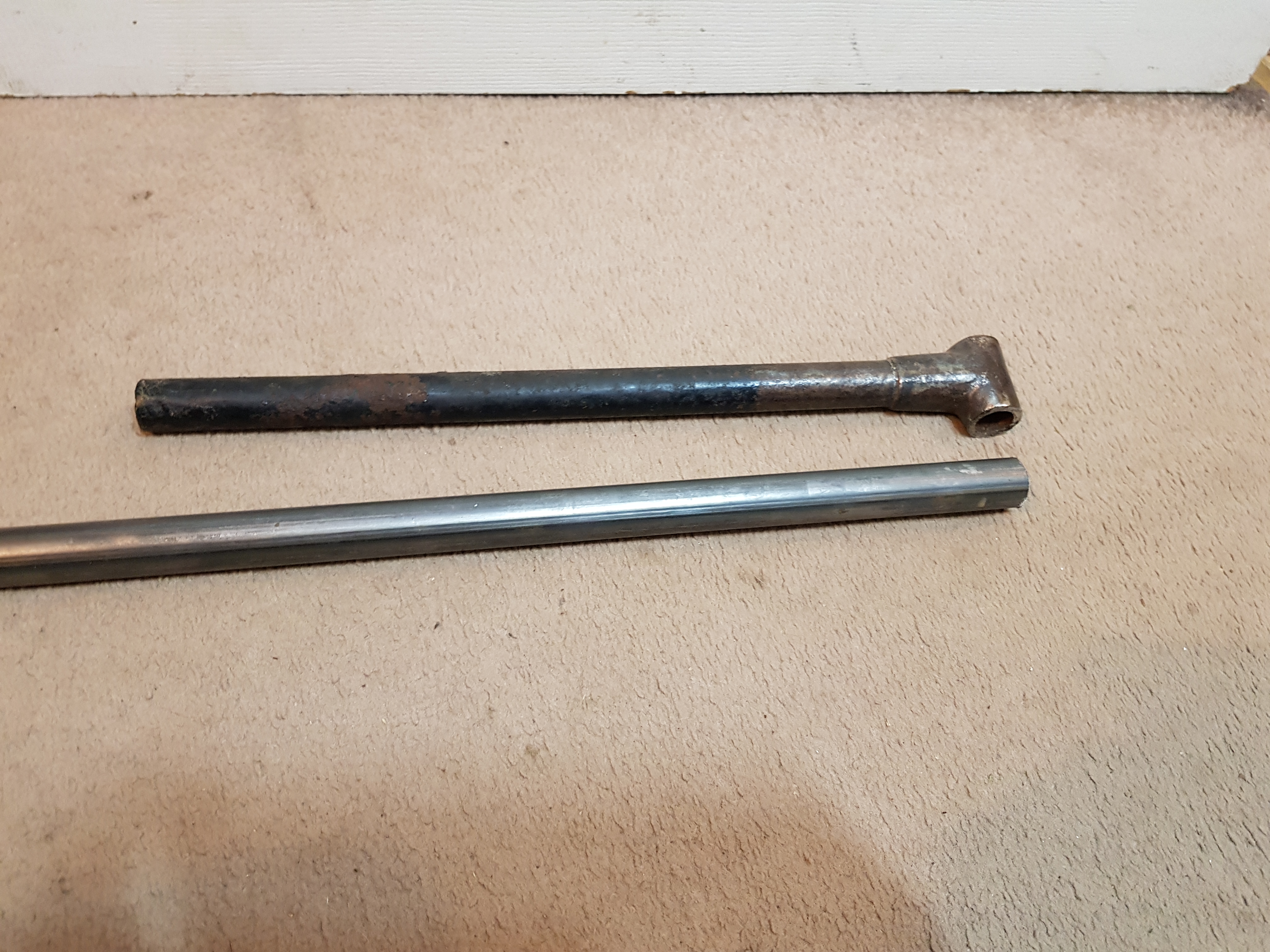

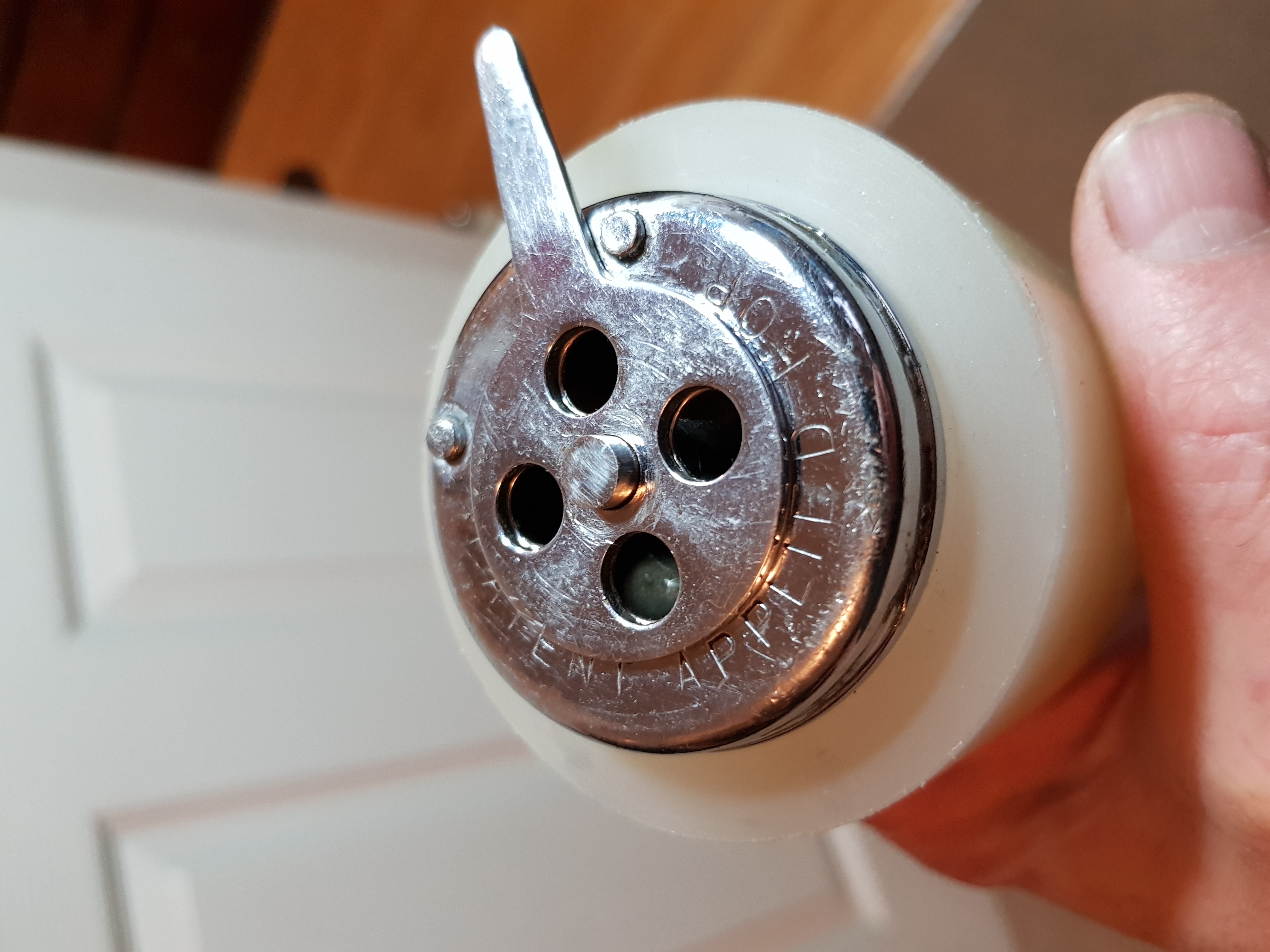

Have straighten out the pepper pot intake, looks a lot better, now need to make washer and spring.
Nylon former worked well, thanks Charles for the advice.
Next bit I will do is the tiller arm, will replace tiller tube as it is quite rusty.
Will heat it up to get the end off, as it is a hard shape to hold to bore out, will come apart if I get it red hot.
