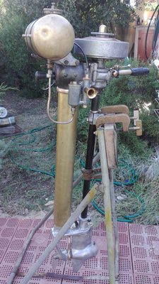

Let me show you my SD Navy type just restored
Maurizio

Very nicely done and honest looking....

Almost there, very nice!
But no Chrome or Nickel on the coppertop SD!
Get the fuel cap, fuel pipe & the water pipes & fittings stripped, replace the fuel tap with a push, standard brass one, John has the much more correct brass L shaped transom screws, & the drive shaft tube needs re-plating with dull,none shiny Zinc.

Hi Charles, thanks for the tips. As soon as I find the original components, I will replace the wrong parts.

Any chrome plater will strip those components, plenty of brass fuel taps about, looks nice!

Nice job! The original tanks were steel of course, but hard to find now. A nicely restored SD is one of my favourite engines
Take another look at the fuel pipe shaping also.
