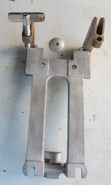

Next with this 102 motor is to service the clamp on engine mount that I have, right now I am using a bolt on one which will not suit the engine rack that I will be storing the 102 motor on.
- Posts: 395
- Location: Hout Bay

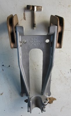

This one came from the box of British Seagull parts that I was gifted, it looks quite old?african imp wrote:Next with this 102 motor is to service the clamp on engine mount that I have, right now I am using a bolt on one which will not suit the engine rack that I will be storing the 102 motor on.
I need to use some heat from a gas flame to free off the lower U shaped keep as it needs to go a hole further back for the motor to stand near verical.

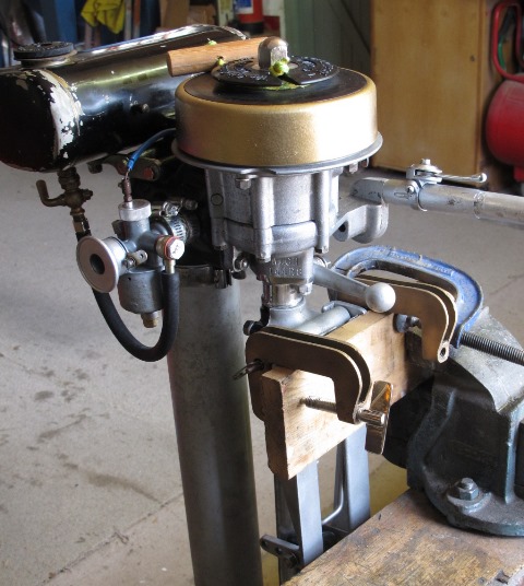

I guess the engine is as finished as I can get it right now?
The additions made recently have been the old style (?) engine support clamp, I needed a gas flame on it to remove the lower cross bolt and nuts, the bolt is bronze or brass and was bonding by salt big time.

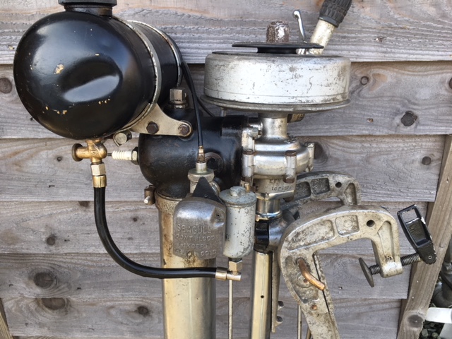

Most if not all of the parts In need are on this 102 series, its going to be broken up, I emailed the owner yesterday but this far I have had no reply.
The tank and mount brackets would be more than acceptable as well!
Any idea of the engine number on that? Has a later Ali transom bracket. And a clutch. Why are they breaking it up? Seems a shame.
- Posts: 66
- Location: uk
Grab it Roy.
This would help you finish your project 102 for sure with spares left over for dare i say it another project for the future!
There's the carb you're looking for along with the right thumb throttle and a fuel pipe. You never know you might be able to salvage the throttle cable too while you're at it. Possibly the tiller as well if it's not bent. (that should keep Charles a bit happier at least )
Definitely a good source for the parts you still need.
You might get lucky and find the gearbox may be salvageable too. Maybe even a prop. Can't see in the pics.
Let us know how it turns out with this. Obviously if you still need parts let me know and i'll see what i can do. I definitely don't have a carb though, but some of the miscellaneous bits and bobs like G clamps for the transom mount i have a few, along with thumb throttles water pipe fittings exhaust clamps etc. I think i have a long drive shaft from something or other which you could easily cut down to whatever measurements you need for your project 102 along with an impeller from a century type motor as long as you intend to use the gearbox currently fitted on your engine as it is now. However, if you can grab this other 102 you might be better off using the gearbox assembly from that. Would be great if this other 102 has a prop too.
I keep my fingers crossed that this pays off for you.
Good luck and well done so far.

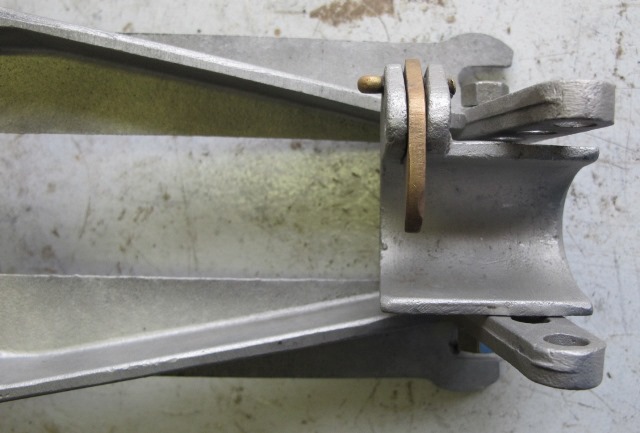

My cleaning of what I assume is an older type of engine support, showed that the lower cup to support the drive tube is not quite large enough to accept the tube that I have, was there a smaller diameter tube I wonder?
I have used a black plastic support cup instead.
