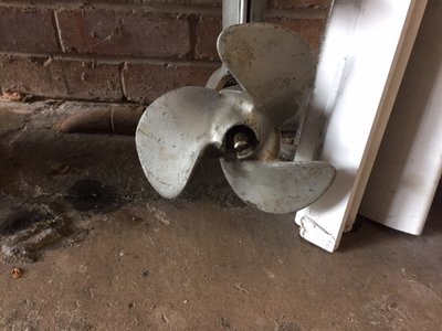

I've tried a search of the forum, but come up blank on the right prop for a FPC from 1977. Is the three blade cloverleaf that it's spinning now right?

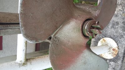

You need one of these, the direct drive 40 plus has a coarser pitch prop that runs at a lower speed. The FPC has a finer pitch prop that runs at a higher speed.
