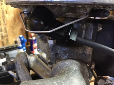

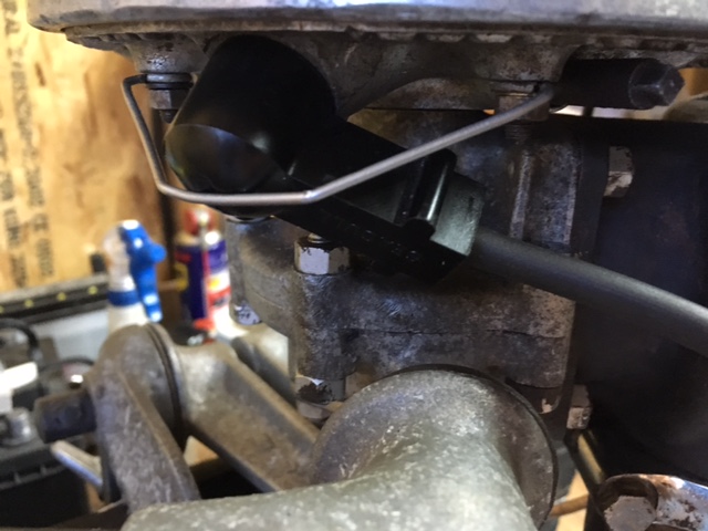

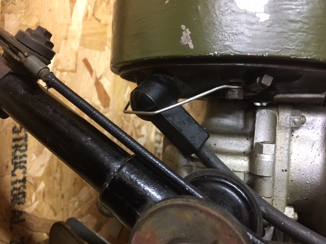

Re: Coolie ignition timing
Over the weekend i will find out the exact timing of the new motor.
Here are some pics of where it is on the SD then OP.
That looks about right Jacob.
I'm looking at the locking screw and its proximity to the closest crankcase bolt directly below it. This is roughly where i set a coolie magneto and should (fingers crossed) be in the ball park of 40 ish degrees BTDC.About 4 o'clock for the HT lead as well by the looks of it. Measure things carefully Jacob. Check and double check everything.
