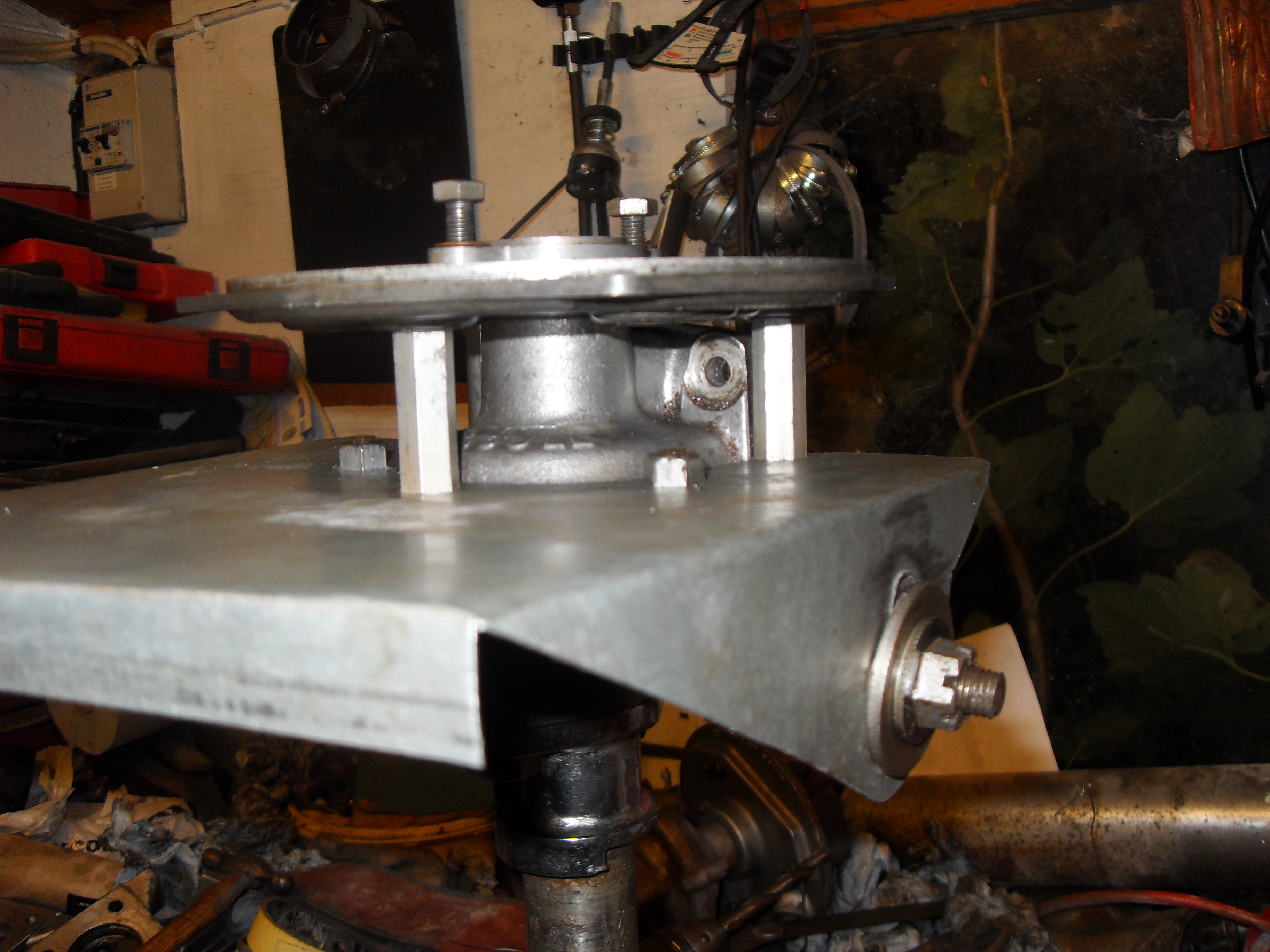

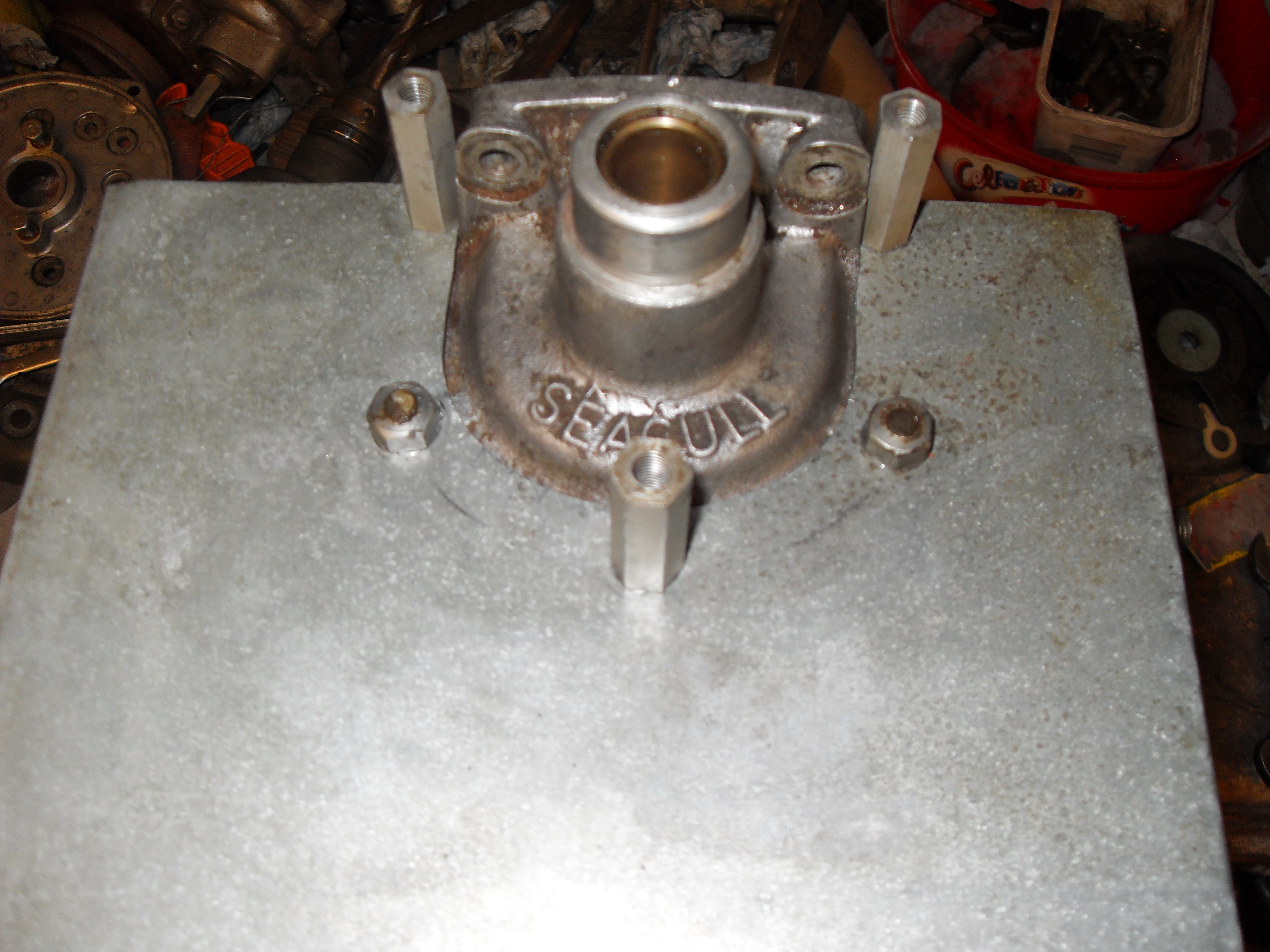

I've had this in my head for a while now but not had any time to put things into practice so here goes...
My boat already has steering gear fitted to the port side, easy enough to utilise what's already there i thought, plus while sitting towards the back of the boat the view ahead is a bit restricted as there's a cabin up front.
The bigger problem is with throttle cable and gear cable as the motor i intend using is a FNR model 90 longshaft.
A throttle cable isn't such a big issue as i have a mate that works in a bicycle shop who's willing to make me up a custom cable to my dimensions. (around 10 foot long roughly)
I'm just a bit stuck on which type of gear cable to look out for. Ideally a push/pull cable that's thin enough and bendy enough to go round tight corners and still work?
So what i've come up with is a bracket/plate for mounting 3 cables onto which gets fastened to the top crankcase half using the bolts that are already there in the crankcase. Similar to how a modern outboard would be i guess.
Just a mock up at this stage and trying to work out the final positioning of where the 3 cables will be fitted and still allow enough free movement to let the motor turn left/right and get tilted without binding up anywhere. All 3 cables will have to get routed through to the port bulkhead, (to the right as you look at the pics) quite a tight squeeze going through an S bend just to keep everything neat and tidy and tucked out of the way.
Any help with this, i'm all ears

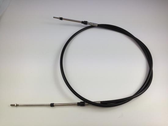

Morse Teleflex steering cable.
That will push and pull, bends reasonably well.

Just to bring everybody up to speed with this, the boat already has steering gear fitted to it. Just need to attach the cable to the bracket/plate i'm fabricating.
Hope that's clear!
No, my bigger problem is finding a suitable cable for operating the gear lever (FNR) on the model 90. The end of the lever already has a small hole drilled through the ball end which would be ideal for attaching a cable to it by a small nut and bolt. (easy)
In the meantime i've mocked up a bit more of the plate with the bare bones of a powerhead complete with carb to make sure of the final positioning of 2 out of the 3 cables this set up will need. A bit more trimming of metal was needed to clear the carb to allow access to the float bowl primer and choke flap. The other side of the plate needed a bit removed to allow the full swing of the gear lever fore/aft.
Also the plate itself is going to need a bit of stiffening to the underside as it's still a bit flimsy for my liking. All made from thin gage galvanised sheet so hopefully it wont corrode too quickly. It's going to get a couple of coats of paint when it's finished so it looks tidy.
I'm trying to keep things as simple as i can with this, just like the seagull this little lot will be attached to (hopefully)
Now where did i see those cables..........
Hope that's clear!

Jon, why don't you just use a standard outboard gear shift cable or am I missing something?
Anyway, that day a lesson was learnt on modern electrics.
Re: REMOTES ON A MODEL 90?
That's pretty much the road i'm heading down at the moment Rene.
Utilise an existing set of cables from an outboard set up (although i will only need 1 just to operate the gears) all other controls i.e throttle and steering are already taken care of.
The trick here is to find a cable with an "eyed end" fitting at both ends of the cable which will make things a lot simpler to marry together. (a bit heath robinson maybe but it will work) Just trying to keep things as simple as possible,same as the seagull this lot will get fitted to.
As and when i find the right parts i'll put some pics up of the finished article.
Just doing some last minute "titivating" to the plate/bracket. Making up a stiffening brace to the underside,again using fixing points that are already there on the motor.
The basic idea with all this is it will be a bolt on/bolt off addition to a model 90. minus the tiller of course. Easily reversible back to how things should be as per any "normal" model90. (might take me 20mins or so to do all this but it will work i promise)
It will become much clearer when it's finished.
