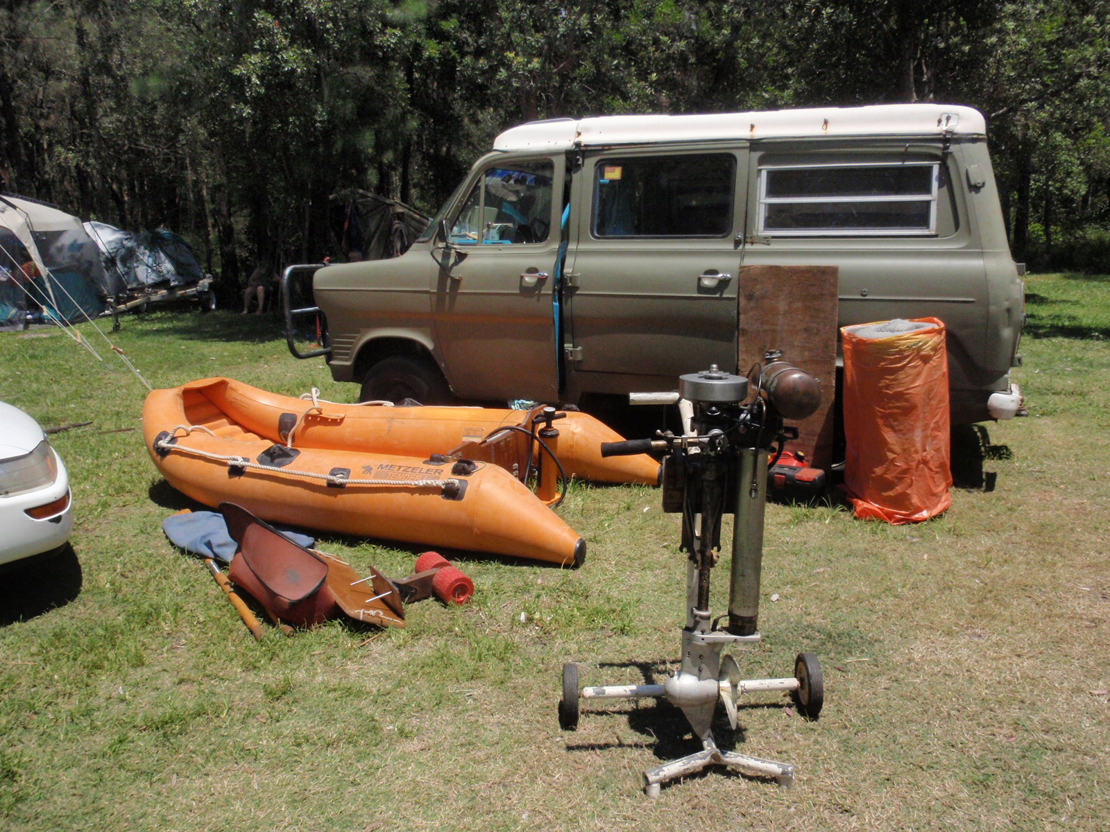

Actually I'm rebuilding the master cylinder on the van which is Seagull vintage. Need to transport the gulls to our Nat meeting. Thought I might try this new fangled method of bleeding brakes by using a vacuum gun to suck the fluid at the wheel end. Think I prefer a tube and a jar tho.

I remember that vehicle.
