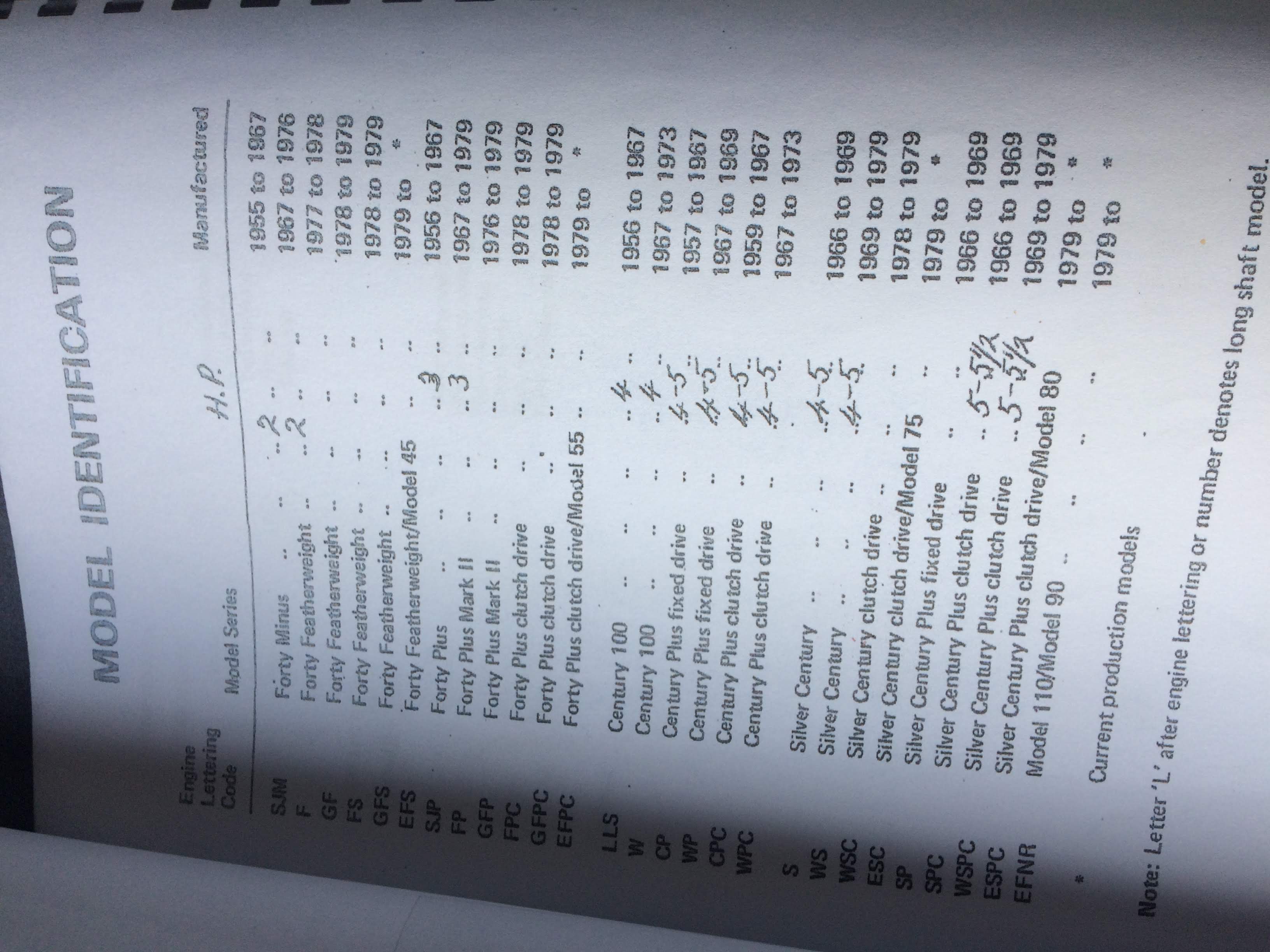

That's a new one for me Nudge, I haven't seen that before, what's the edition number?
Quarts & gallons, must be sometime in the 60's.
The "Do not overfill" would imply that Seagull had discovered some negatives with filling to the brim, as the service handbook suggested during the 50's & early 60's.

I believe this is a fourty plus (at least the prop says that) There are remnants of "gold" paint on the flywheel and was manufactured May 1973
serial number FPL 747EE3
Re: Found it in the River...
If I knew where the addition number was I would tell you!
British
Seagull
Service. Repair Handbook
2 to 6hp Models
I can only guess 1979?
British
Seagull
2 to 6hp Models
