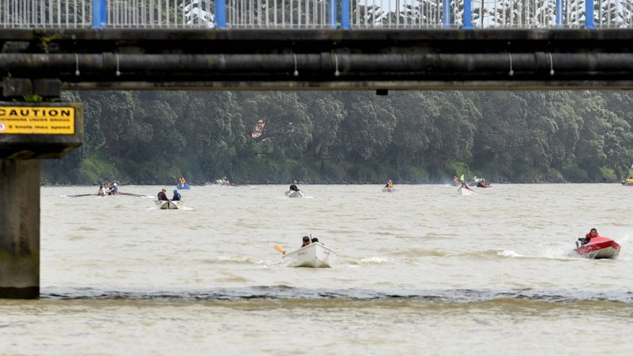

Did a 5 hour roadie on the weekend to join in with the waitara river seagull race. (
https://www.stuff.co.nz/taranaki-daily- ... tara-river
The best part of the day was getting a good start on every race and beating the host (Graham and Jan) at their own game.
Spent some good time with my son in the boat (we are the white boat in the front (the red boat is a 2.5 modified)
As the day went on the race had to move up river as it was getting choppy and some of the newer members where finding it tough going.

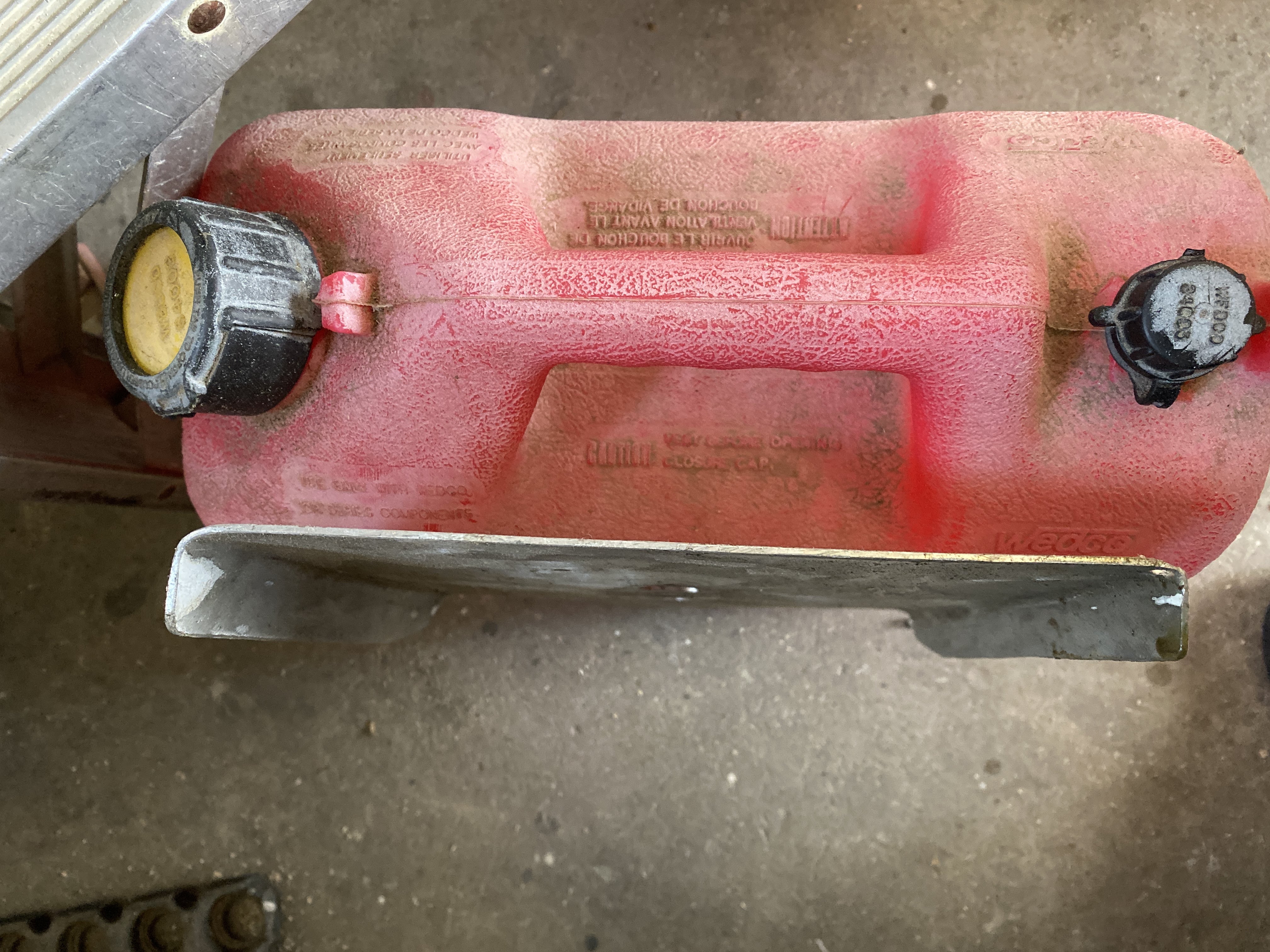

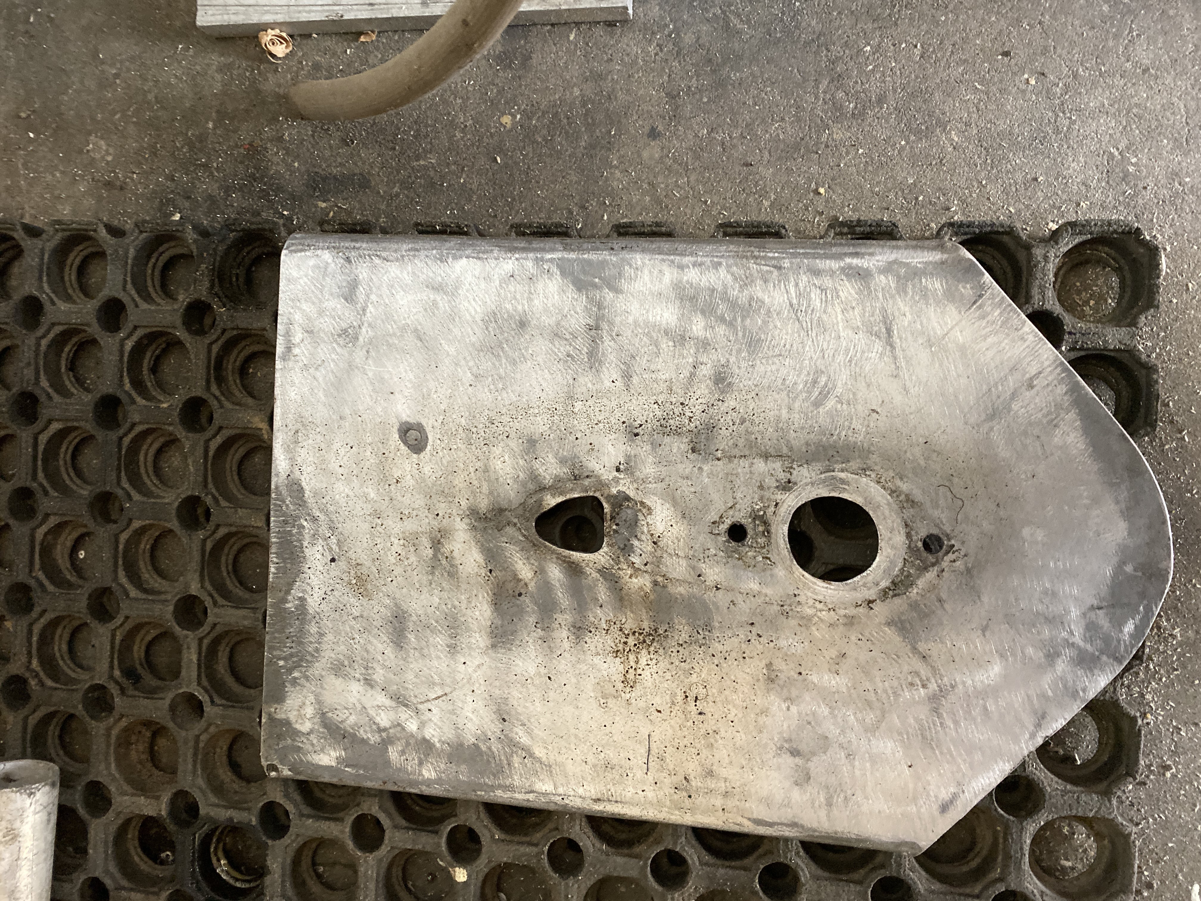

Yes I do this also. by doing that we can run the engine a lot higher in the water with out the prop grabbing air (as much) the higher the engine the less drag it has = the faster you go.I see alot of competitors have added an extra piece to the anti cavitation plate

That's interesting , I have considered trying this to aid going astern in choppy conditions . I'm just reluctant to drill holes in an almost new engine for an experiment !
- Posts: 4955
Re: waitara river seagull race
Replace the water pump gasket with a 3mm aluminium plate , make the holes the same size & location as the gasket, use RTV to seal it.
Make it giant to start with, you can always make it smaller.
I fold the wing tips down as a skeg/stiffener.

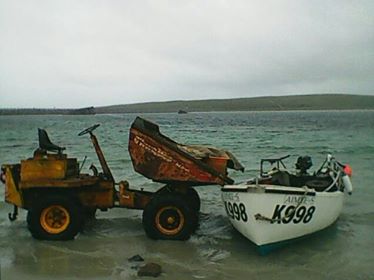

Won't win any races with this one
- Attachments
- 65570717_405280273413902_8013884082087788544_n.jpg (16.72 KiB) Viewed 4204 times
You have every chance to win a race with that boat. I may just have to drop my motor over the side first!
Maybe if you didn't fill it with sand from that tipper it might go better!
what gear box motor have you got? I will get a pic of my setup later for youI have considered trying this to aid going astern in choppy conditions
I have 2 seagulls to try on that boat , an ED 102 and a series 90 . I alternate between a Honda and a Tohatsu , both 6 hp four stroke for daily use . Because it's a displacement hull my top speed will be limited but on a good day I can achieve 6 knots with the 6 horse

Pics of the "Pan" Has to be of the non stick type to work! As Charles said take the gasket out and put the pan in its place The white one is for the 20'er
Nice ! Thanks for the pics , do you have a patent on these ?
