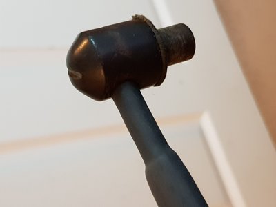

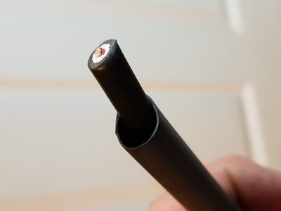

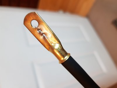

Making a new HT lead, modern copper cored HT lead is now 7mm diameter and shiny PVC.
I use a bit of heat shrink to increase the size to about 0.34".
The larger size fits the old coil pickup, and heat shrink look more like the original rubber HT lead.
New solder on end, and good to go.

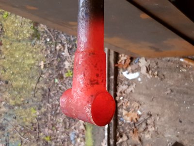

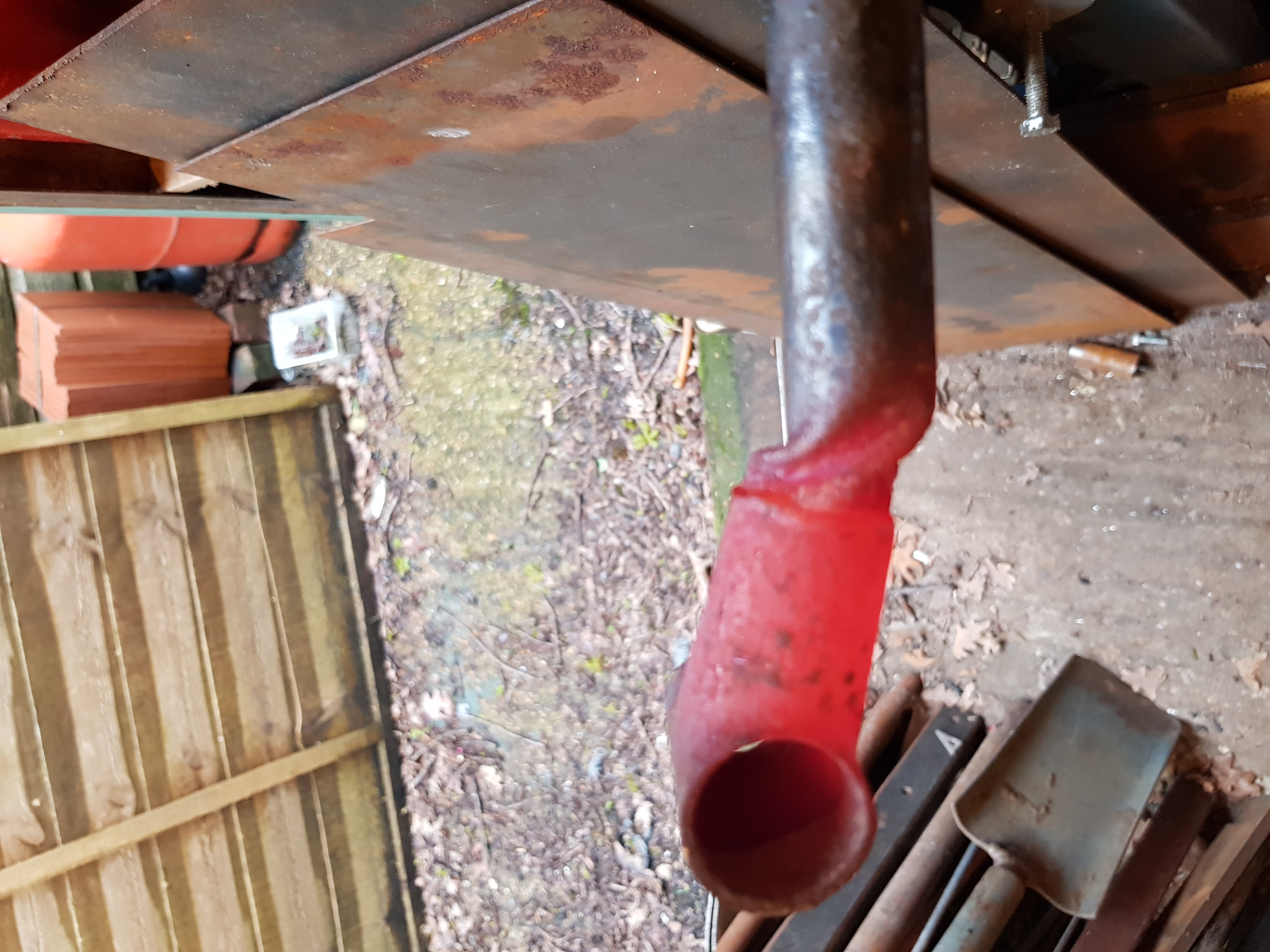

No it won'tHorsley-Anarak wrote:Will heat it up to get the end off, as it is a hard shape to hold to bore out, will come apart if I get it red hot.H-A
Back to the lathe.
Re: Restoring a Marston OA
Oooops.....
Yikes, obviously not soldered or brazed then

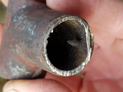

No it looks like it is brazed, just think some rust is holding it together.Oyster 49 wrote:Yikes, obviously not soldered or brazed then

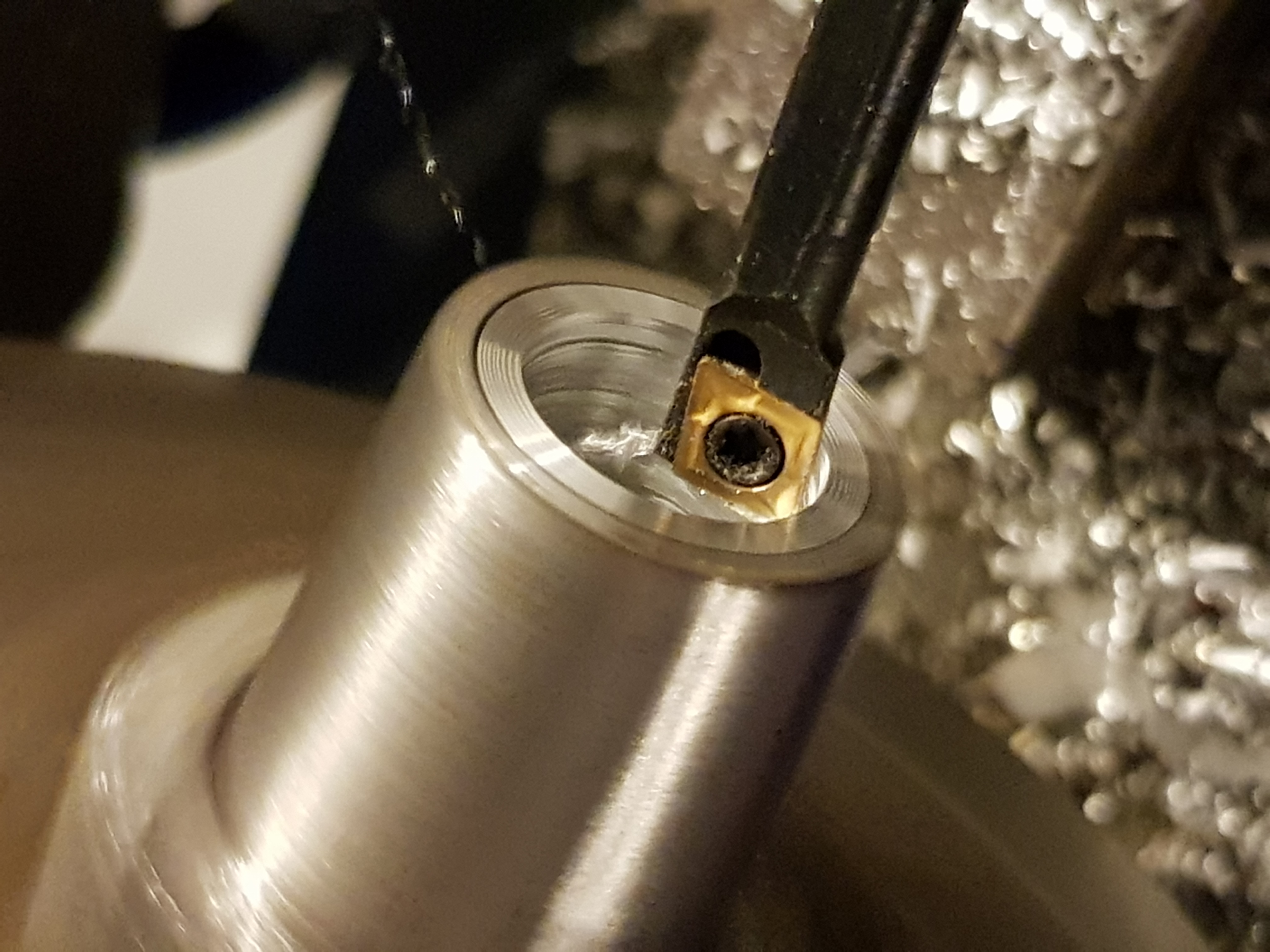

Did not want to distort the angle bit, so will bore it out.
You can see the braze here.

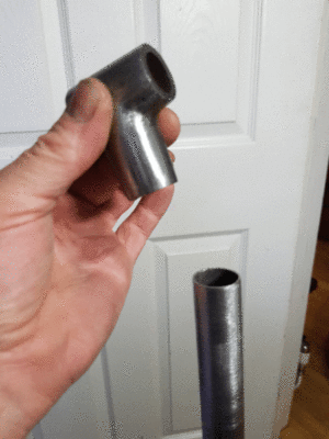

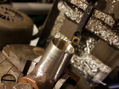

Found out why It would not come apart, it was nailed together, with an iron nail.

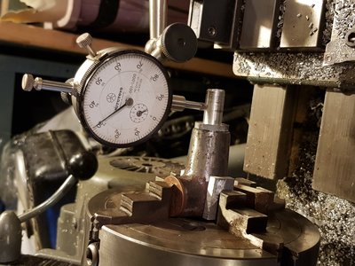

So bored it out, made up an ali mandrel so I could use the tailstock to align it in the 4 jaw.
Nice to be able to see the braze when it is bored out.
Clever bit of packing
One of the packing pieces only cost 2p.Oyster 49 wrote:Clever bit of packing
