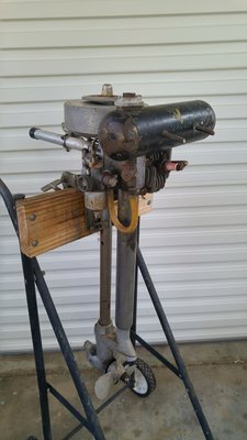

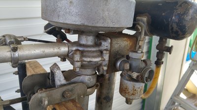

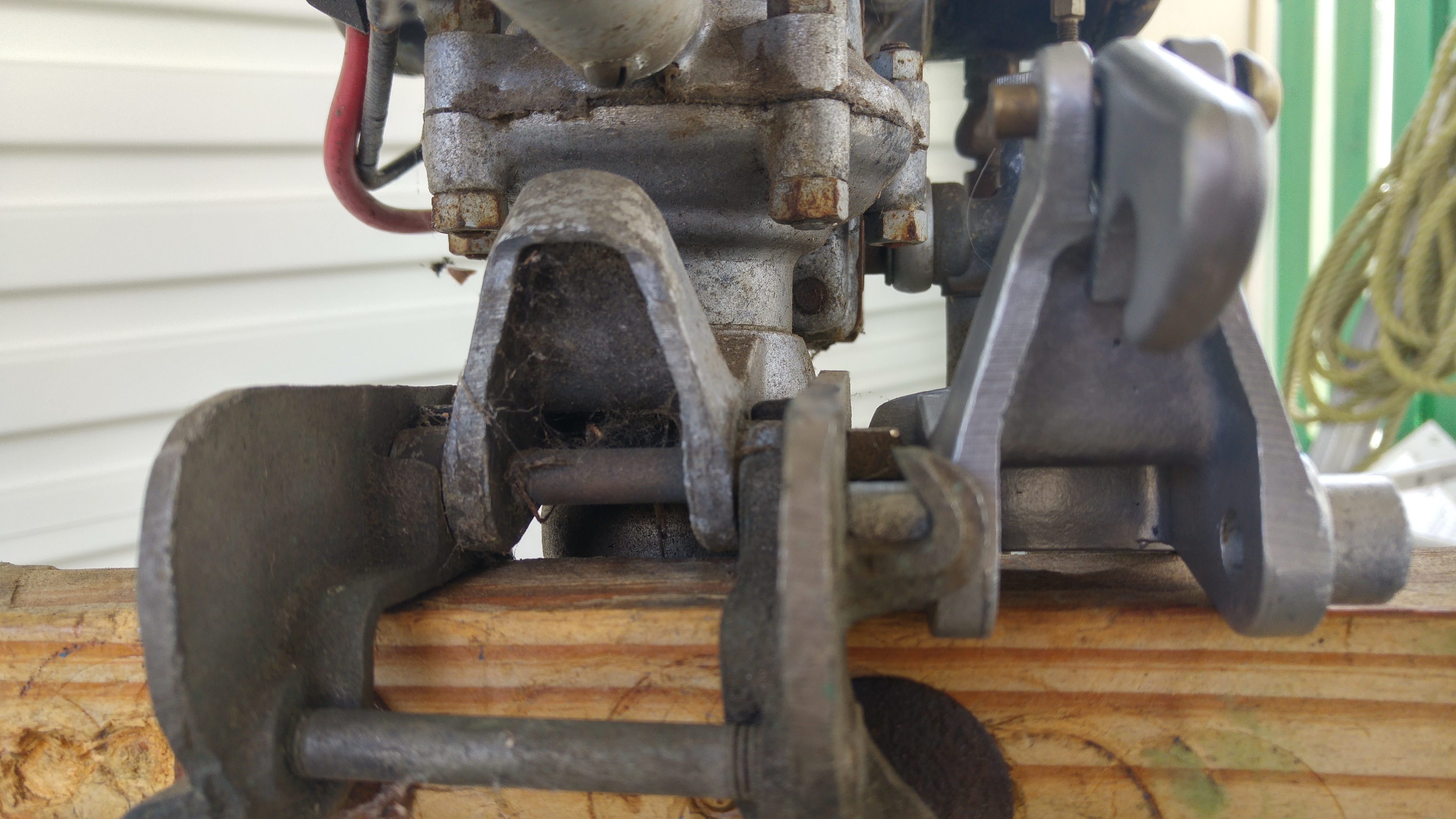

Arrived today.

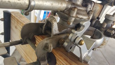

The only problem is the gearbox with no skeg.
I have everything else bits and bobs in boxes to get it correct. Will get another block welded up and recon the head like the FVP.
It turns over nicely by hand.
No rush with this one.
This below is special...

Re: FV 2844
Posted: Tue Jan 19, 2016 9:38 am
by Hugz
Plastic fuel pipe
Re: FV 2844
Posted: Tue Jan 19, 2016 9:42 am
by Collector Inspector
Have a pipe Hugo......

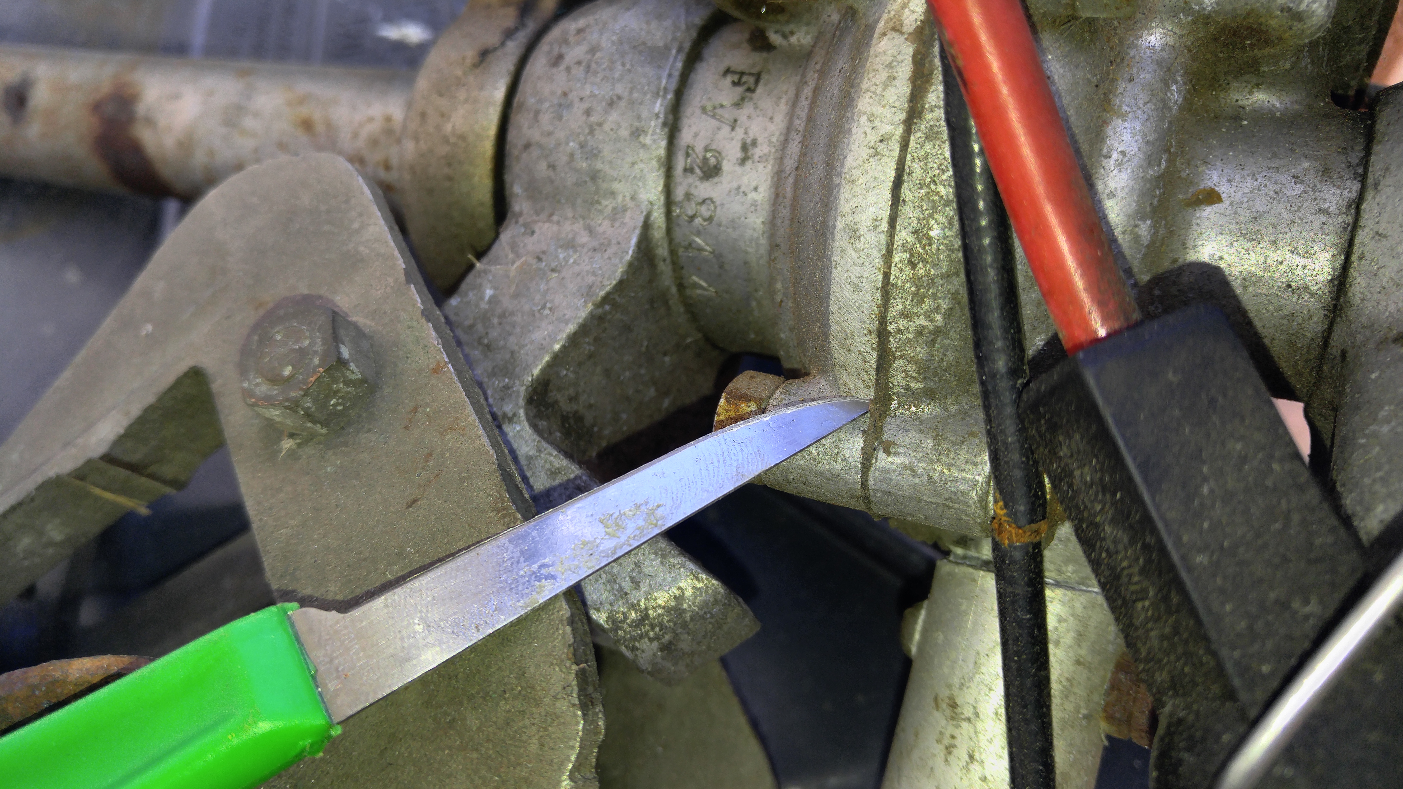

This earlier unknown Q sorted aye...
BnC[/color]

Re: FV 2844
Posted: Tue Jan 19, 2016 10:14 am
by Keith.P
Could it have just been damaged, then cut and filed or ground back?
Re: FV 2844
Posted: Tue Jan 19, 2016 10:21 am
Keith.P wrote:Could it have just been damaged, then cut and filed or ground back?
Looks exactly like that was the case.

Re: FV 2844
Posted: Wed Jan 20, 2016 9:30 pm
by headdownarseup
Have you not seen "cotton reel" thrust blocks before?
Normal on FV's like these (my SJM210 has these too) as do the 3 LS's i have.
Best of luck with the gearbox though.
Will you weld or will you swap with another?
Look forward to some pics later
Re: FV 2844
Posted: Wed Jan 27, 2016 12:48 am
by Gannet

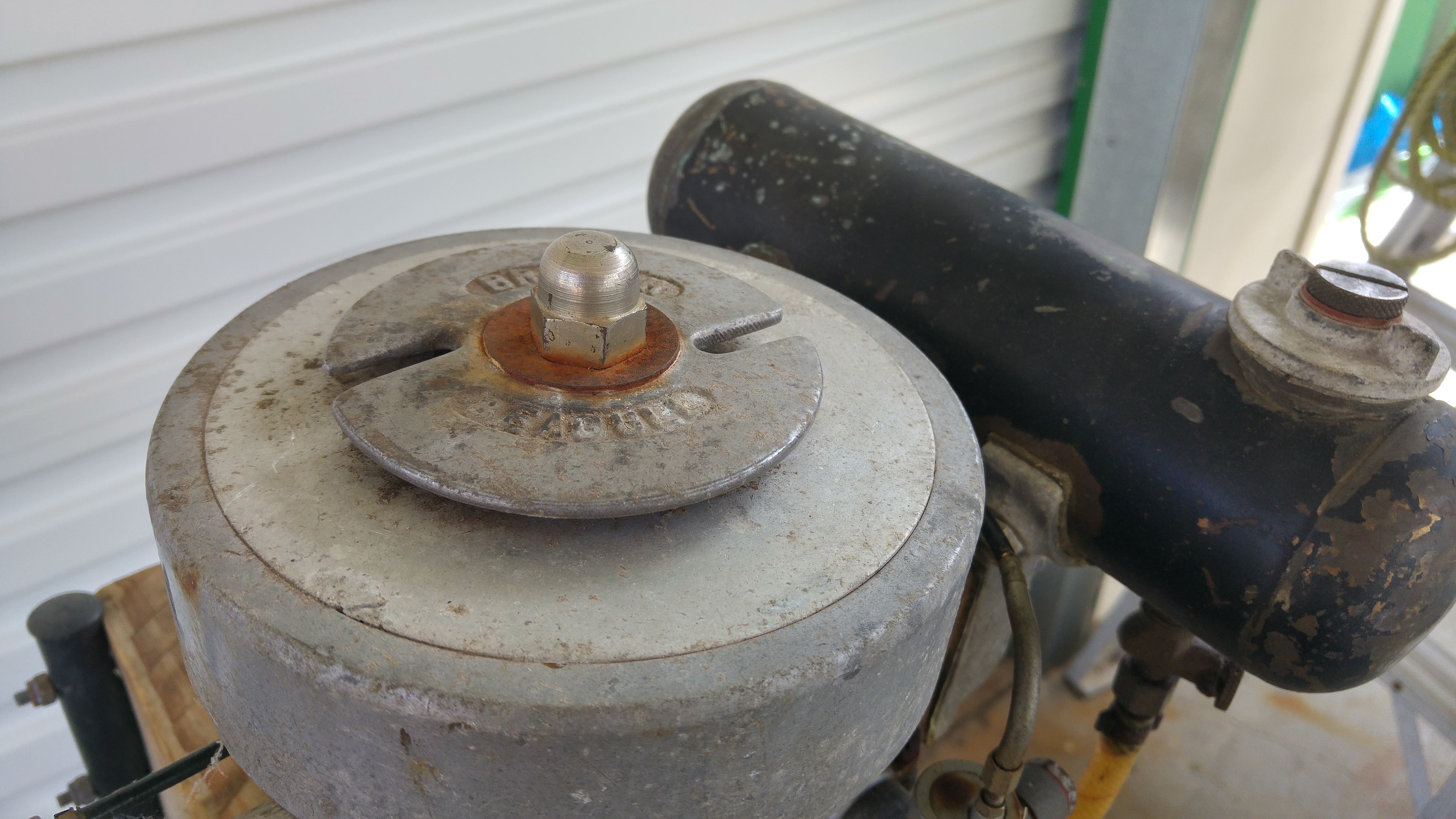

Nice to see another FV to be restored and looked after, and quite an early one.
1. The carb choke has a 'bolt' in the outer end. I have seen these on lawn mowers, but not on Seagulls.
2. I cannot see if the bowl is the correct one without the drain hole.
3. It looks possibly as if there isn't a throttle stop which FVs should have.
4. Nice to see that it has the short ear and narrow slot filler cap, which I think is correct for this early FV.
5. Nice to see the single 2/3mm vent hole in the exhaust pipe.
6. As Jon has said the black plastic cotton reel is probably correct. Very early F/FVs were cast aluminium.
7. Is there a gasket between the crankcase halves?

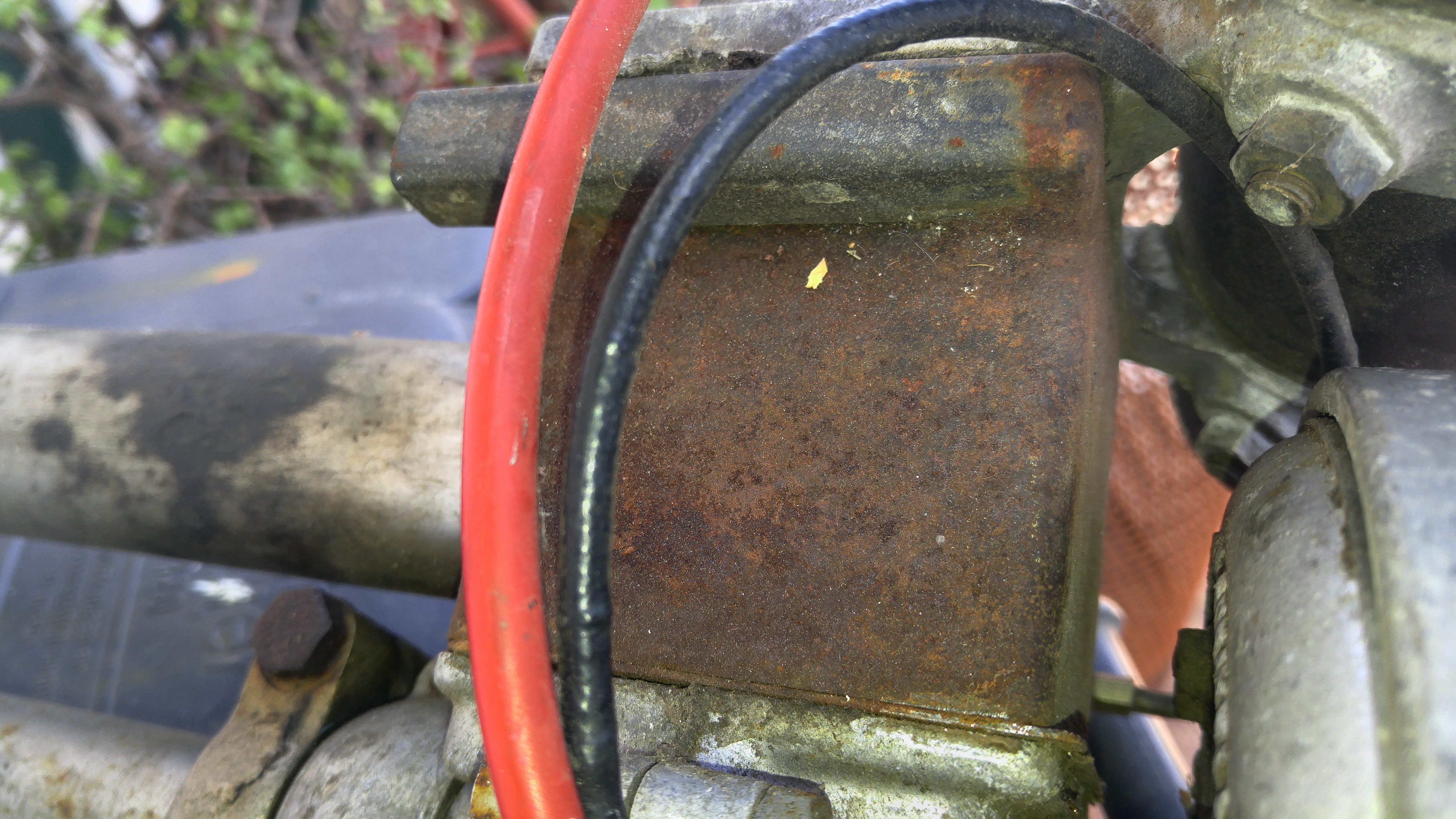

8. It is possible/probable that on early F/FVs, the tank 'support' studs were shorter at 2.3", whereas most are about 2.5". I would be interested in the length of these.
9. Nice to see an original non-webbed early crankcase.
Bruce, good luck with the restoration. I would be interested in the flywheel date and info on the carb and tank.

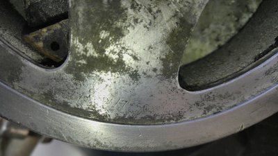

Date on flywheel is 7/50.

I have added the flywheel date of July 1950. This is the same date as my FV2682, FV2821 and FV3048, so its almost certainly got the original flywheel.
