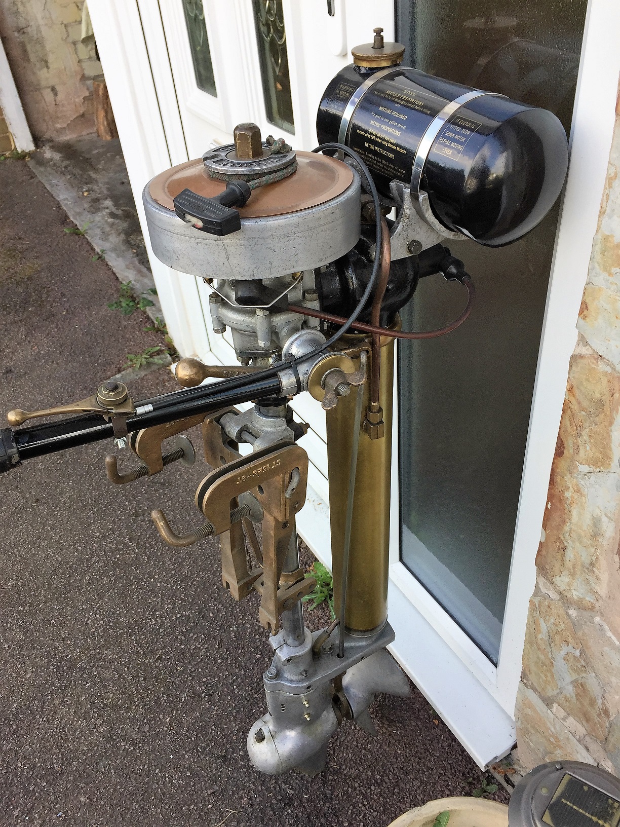

I saw the label, the instruction book, I noticed how good the tank looked, I also noticed it has signs of being repainted, I noticed how far away from me it was and how many questions had been asked about it, I was still tempted to bid on it when I saw it at 70 odd quid, but I didn't

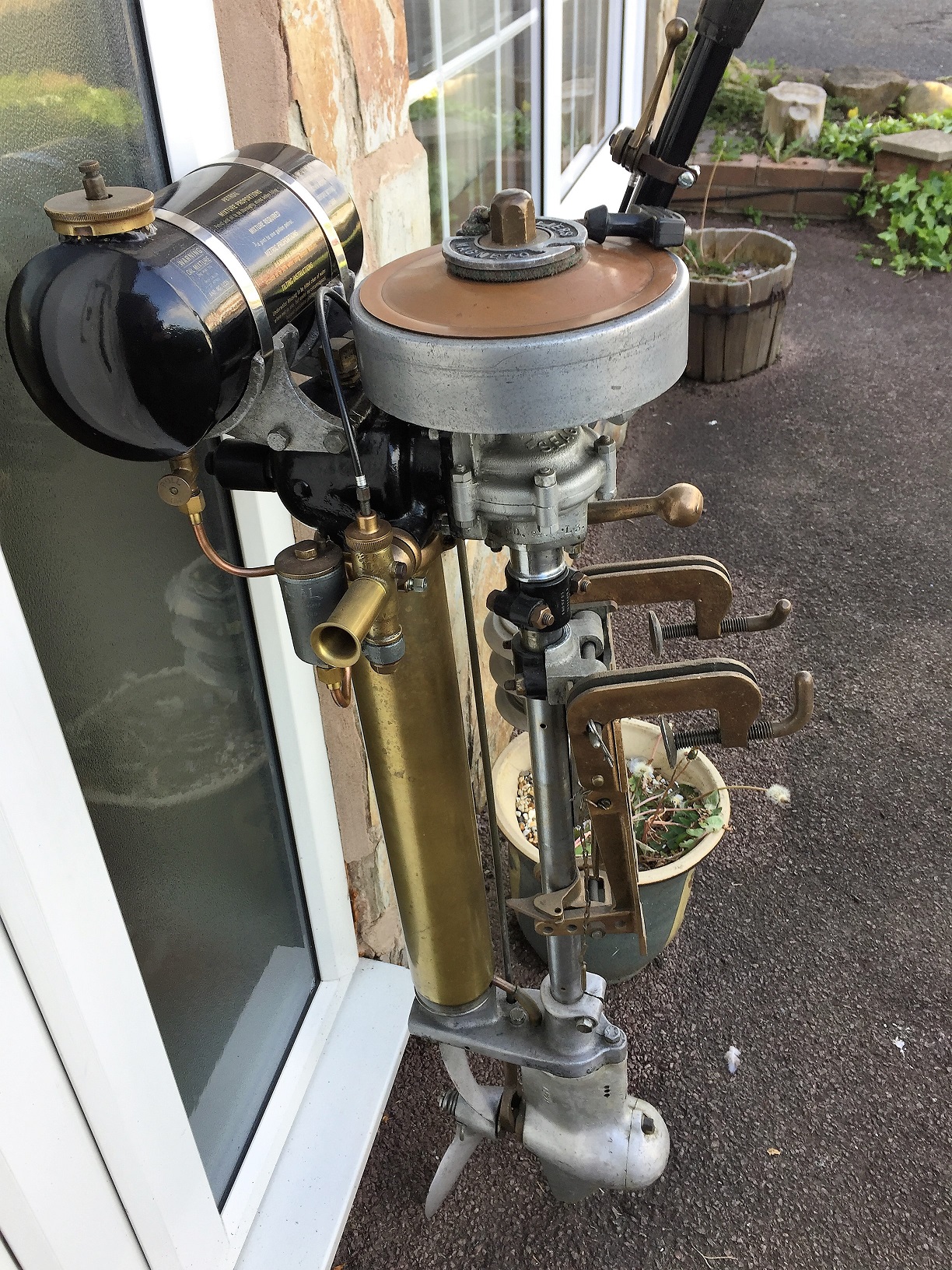

Congratulations Seagull101 on owning the most elite of Seagulls. That motor has some nice original features including the fabric sheathed throttle cable. A later SD so with a bit of luck it didn't see too much traumatic action. I'll get the questionnaire out to to you for the registry.
