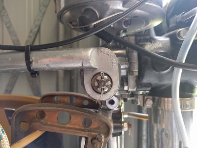

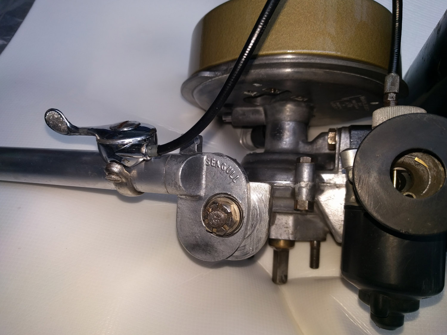

One change that has eluded explanation in my mind, is the change to the positioning of the tiller mount. When the tiller changed from the Pipe T piece to the aluminium flange on the 102, the flange was centred on the matching piece on the engine caseing. With the subsequent century and forty models, the tiller flange hole was offset to one side so that the tiller moved forward in relation to the engine and the two surfaces no longer aligned.
Has anyone any theories as to why Seagull made this change? There was obviously a reason, but the logic escapes me.
