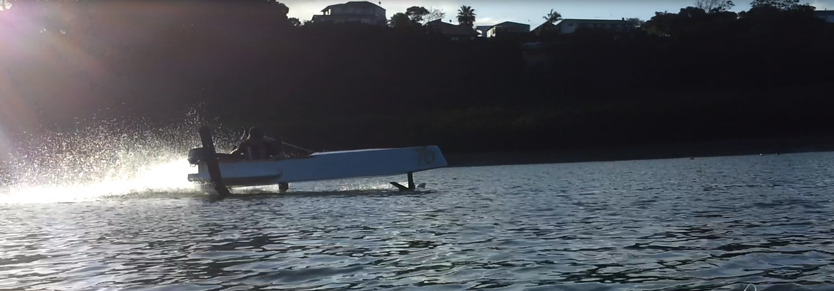

Paris Mk3 out testing last week
Re: New boat for Seagull Sport
Now that is stealthy!

You wouldn't be so complimentary if you had seen her running at Whangamata last weekend! Flat consistent water and she's fantastic. Introduce the rolling quarter-wake while overtaking a slower boat and she isn't quite do impressive. The front foil stalls instantly and she nose-dives hard at 20 knots. I nearly sank on several occasions!

Yes, boat will get another run at Manukau, although we will use a different foil package. The front foil will go in favour of a ski for the moment while we get aft foils working properly. The aft foil build tolerances were too great and they're giving up problems with unequal stall. The stbd foil always stalls before port, which leans the boat into a crash! So just a better quality set of moulds and a bit more care taken during construction for the Rev-B package!
