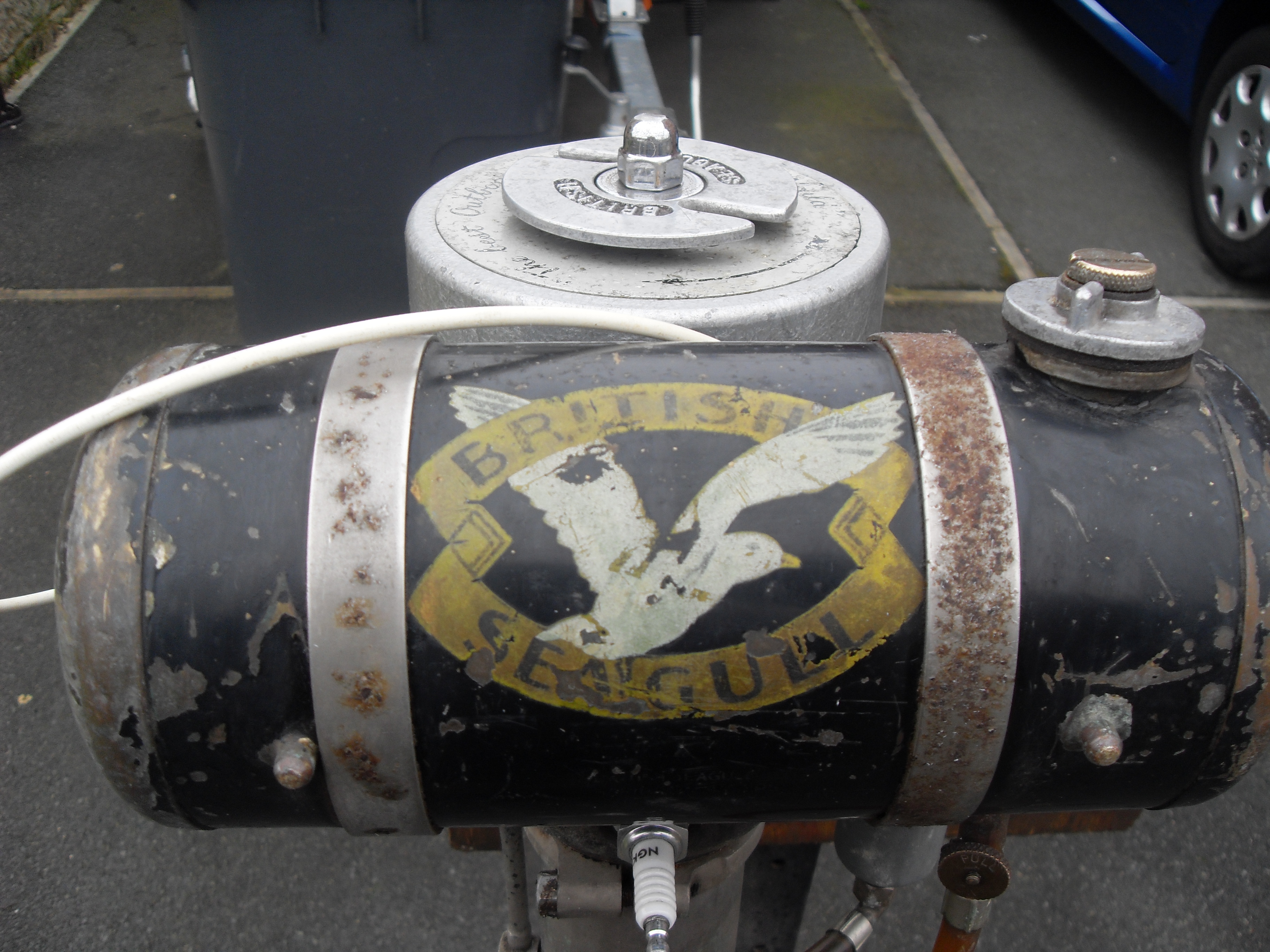

The tank isn't a bayonet type (unsurprisingly) and I have a alloy cap that, yes, I have spent ages obsessively polishing...I've only ever seen one type of alloy cap though.

Aluminium fuel caps are basically the same spec with the exception of the "ears" with which you use to grip it to turn as they come in 2 lengths, short (flat top) or long (rounded top) This is what Jeremy has labelled "little ears" or "big ears" and nothing at all to do with Noddy :lol: The brass vent in the middle of the cap has either a narrow slot or a slightly wider slot. From a distance you'd barely notice, but to some of the purists it's quite a big deal. For a better description of this take a look at Jeremy's listing of "little model 40's" on the main SOS pages. Pics will help explain things a lot better than me.

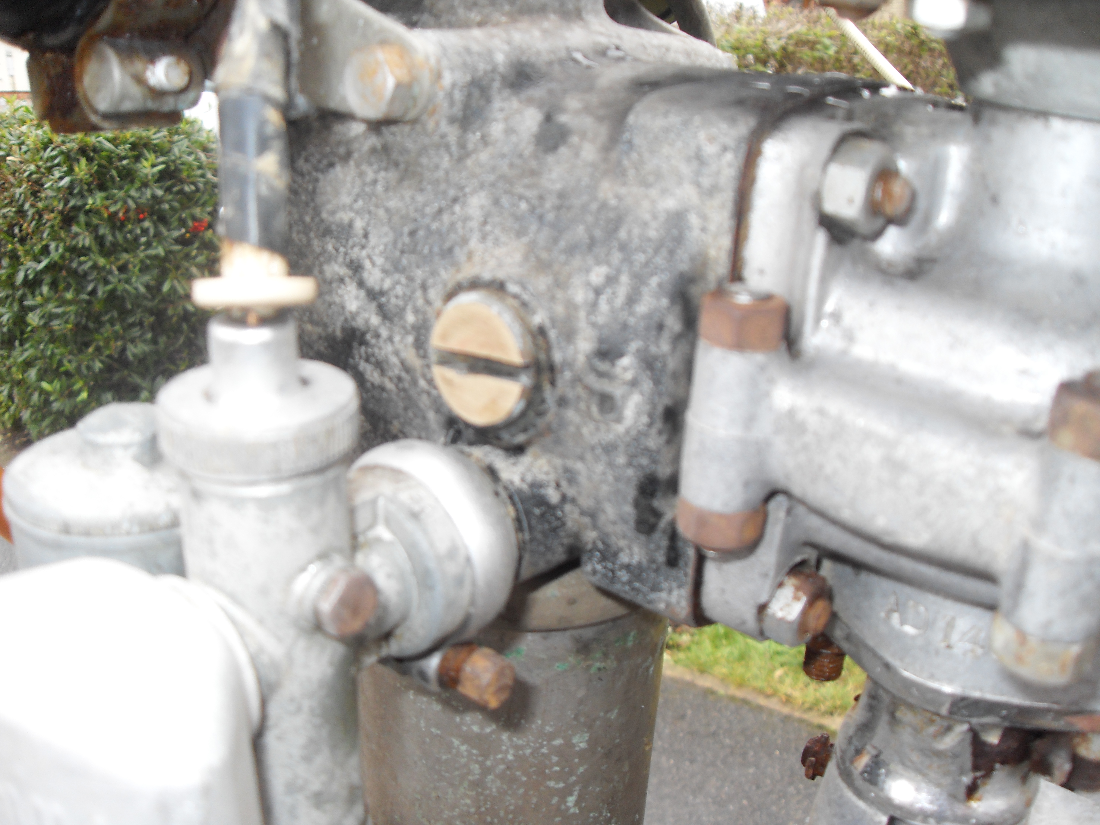

I'm guessing that from your description of your 5 figured serial numbered 102 it hopefully has slotted core plugs in the cylinder as well. Nice if it still has its original cylinder, but not the end of the world if it doesn't. If this 102 of yours is going to end up as "eye candy" on display then why not polish the entire thing for your viewing pleasure. Nowt wrong with that in my eyes. 8)

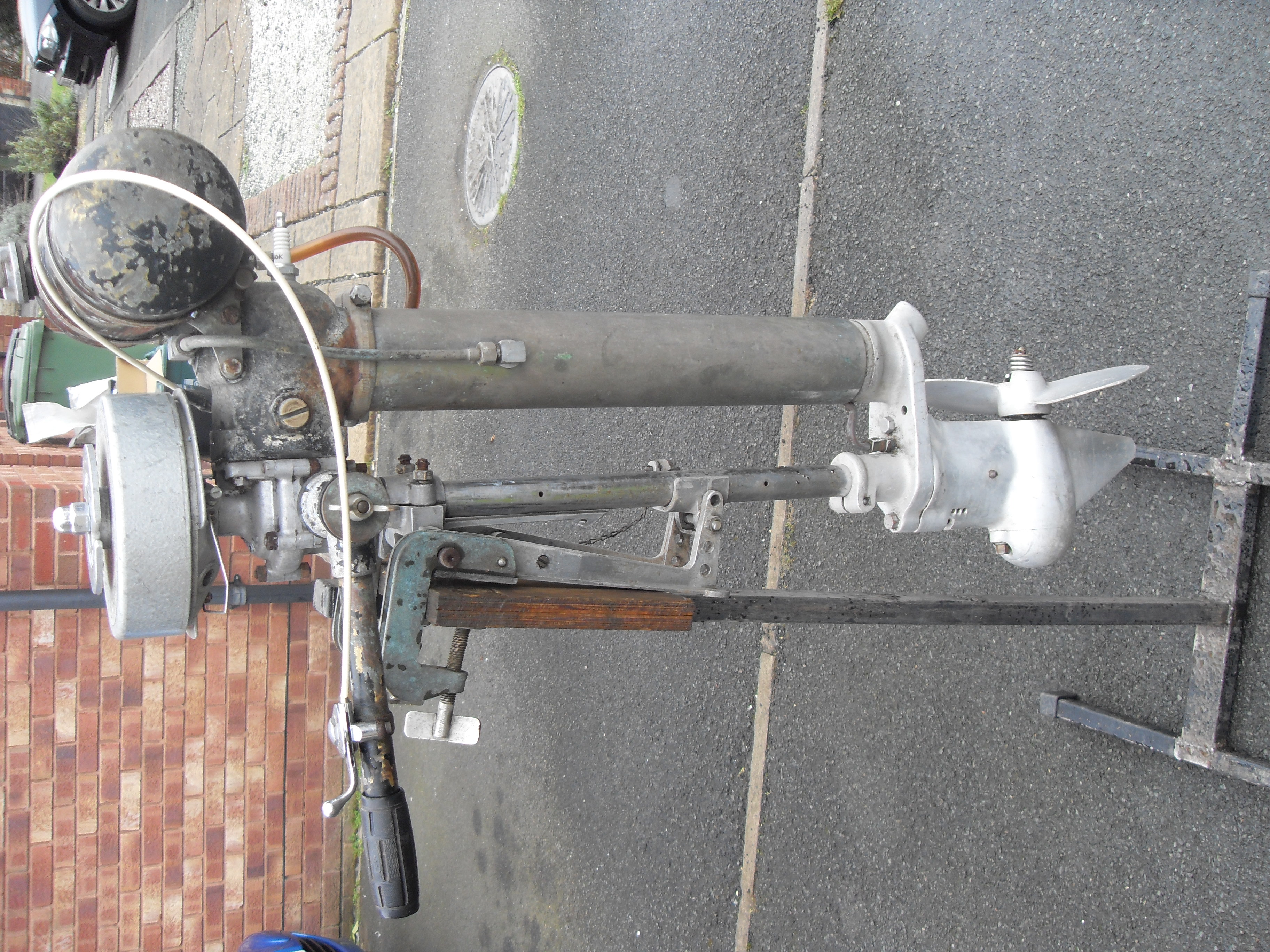

does your 102 look anything like this one?
Regulars will have seen these pics from a while back so this might be a second viewing for some.
This is one of mine and not a million miles apart in the serial number if yours is AC14685 .(wink)
This is AD14088 but a direct drive, although the spec of yours hopefully is broadly the same.
As you see it in the pics is as i picked the motor up from the seller after a quick jet wash to get rid of years of dust and grottiness all over it. The throttle cable is wrong i know, but you get the general idea.

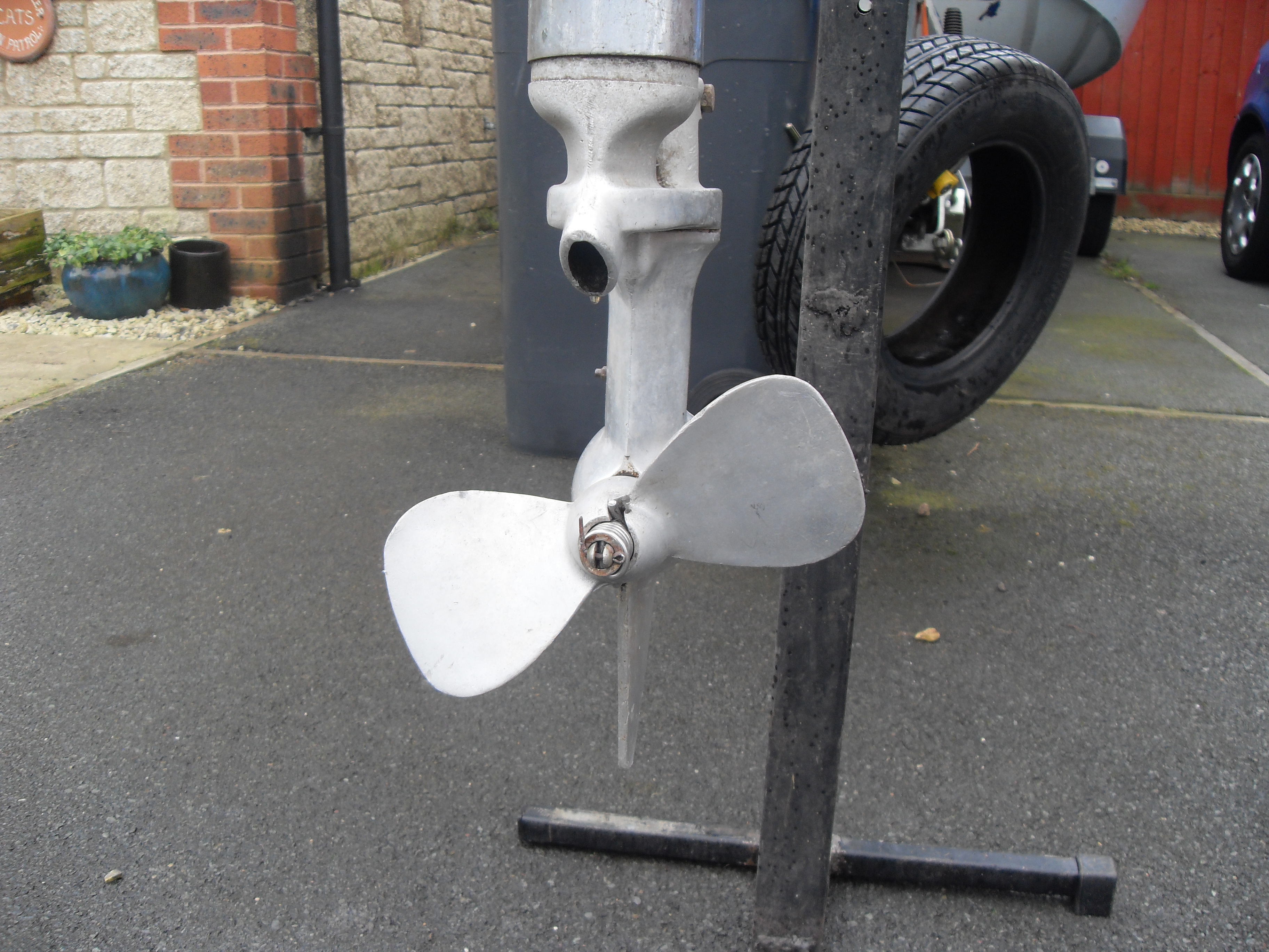

You'll notice 1 nipple in the gearbox, sub ejector pump housing and bow tie prop. Everything we've been discussing all fits together. 8) I have yet to strip it down and renovate it, but as is it runs well enough(once the ht lead is fitted) but in need of some repair to the aluminium around the water inlets to the gearbox. The rest should either paint or polish up quite readily. (notice some of the missing chrome as well :cry: :roll: ) Quite a common thing nowadays unless you're willing to pay big bucks to get it sorted properly. Worth it in my opinion unless it's already in exceptional untouched condition unlike this one of mine.
I have a slightly older AC identical to this in every way except for the clutched gearbox. Blow up the pics if it helps you uncover some of the mysteries with these older 102's.
I can go back even older with hex-headed core plugs in the cylinder as well and equally as good looking as any of these, but the specs are a bit different with the older ones.
I can go a bit younger too with no nipples on the gearbox and a broadly similar spec.
This seagull bug can bite pretty HARD at times, and as far as i know there is no known cure other than a straight jacket and a spell inside a padded room! :lol:

Based on what your description I would say the fuel cap is of the little ears variety...I'll bone up on the Little Forty section when I'm not so tired.
I know this won't go down so well with some but, as far as water pump housings go, I discovered not all driveshaft tubes were created equal when I tried to fit a more decent than average tube to a fixed forty and it didn't want to play...my solution was to carefully abrade the interior of the casting till it bludy well did...so I'm not terribly afraid if the chroming process produced a similar result - but maybe it won't.

I'm glad you approve of my rather original looking fuel tank. I quite like the look of something that has a certain patina to it, and for this tank at least all i shall be doing with it is a light tidy up of any missing black paint and a touch up here and there of any gold with a final coat of clear lacquer. The retaining straps in time will either get replaced for stainless or good second hand ones as and when they become available. As far as i can make out to date the flywheel covers for these earlier ignitions didn't have any scripting on them, just plain. The pics of my AD that were taken at the time i first acquired the motor show it with a later type ignition and has since been swapped with something more in keeping of its age.(it actually came with the original magneto and cover when i bought it which was a bonus for me) A bit later on in production in the mid 50's you begin to see scripted covers with "the best outboard motor in the world" which later got changed to "for the world", so yours having virtually no scripting left on it is probably not such a bad thing after all :P Along with changes to scripting on covers, the ignitions themselves also changed slightly throughout the years. (Jeremy's listing should show some of these changes nicely)

I've come across the problem of swapping drive tubes from one donor engine onto a working "resto" job as well. As mentioned previously, some of the castings on the pump housings will take a degree of stretching to get a "foreign" tube to fit, but go carefully as once they've reached that stage where they're almost at the point of fracture it can go horribly wrong very quickly. Gently does it!
