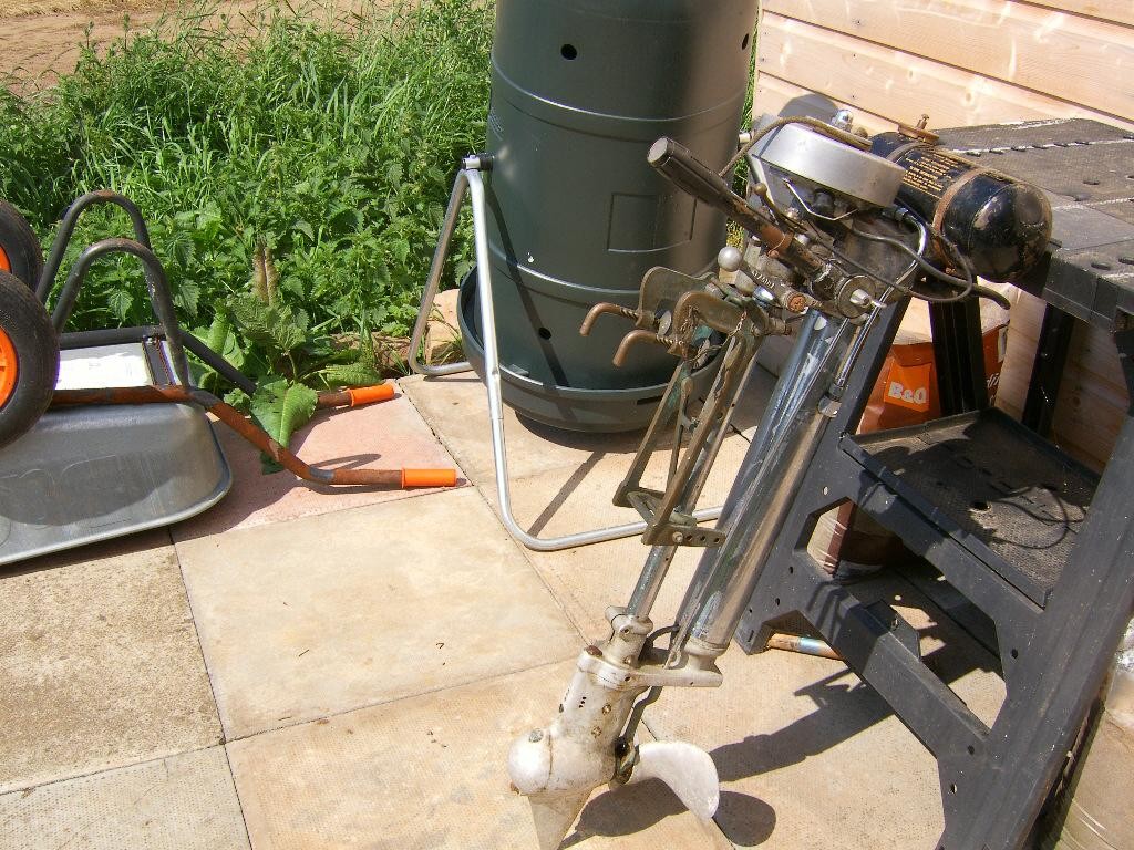

Ok then, the gearbox.
I'll come clean and own up now so you dont think i've just been really lucky.
I took this to work today and took it apart with the help of an oxy-acetylene gas torch. (works wonders)
It all came apart quite easy really, i was very surprised. Normally i end up cursing and swearing a lot trying to get the drive tube out of the pump housing, but this one almost fell apart!
My main concern is with the skeg and pump housing at the moment. I've seen quite a few 102's with the exhaust mounting "fudged" like this, but i'm going to try and weld this with aluminium. Has anybody tried this yet? any help on this would be good if not it'll be a steep learning curve on a piece of scrap aluminium before i attempt anything on this.
Not sure what the idea was behind the 4 washers behind the front collar, maybe a running repair carried out years ago maybe.My SDP doesn't have these washers?
Also, unusual attachment arrangement of the front cover with studs and nuts instead of the normal screws! (weird).
Propshaft bushing is a bit sloppy for my liking, so i will have to see if i've got a spare to replace it.
So far, so good. Nothing out of the ordinary so far.
Now lets get the crud out and have a better look!

Re: D9666 restoration
All the usual suspects in here then, but NO GREASE, just salt deposits and gritty sand! Nasty
Oh boy! Lots of corrosion. Why don't you try to get another gearbox? It shouldn't be too difficult to source one. Maybe Oyster49 has a spare one unless he gave it away. Too much trouble repairing this one I would say.
Keep posting and good luck!
hi stelios
i like welding.
i've done lots of steel in the past but never aluminium. always wanted to try something like this but never had the chance.
Gently does it i think!
Sure it does. As far as I know you will need to reach the healthy metal to weld aluminum.
I saw a product in the store the other day called liquid aluminum..Its a 2 part epoxy like deal...could something like that work for you? It has a shine when sanded and buffed aswell as strong as ever.
yep
i've seen this sort of stuff before and does work quite well.
I think i would need to see how well it would polish up before making a decision on using it.
In the interests of remaining "authentic", i think i will have a go at trying a test piece first before commiting all the way.
You never know, it might turn out ok and be just as strong and robust as the original casting. Wait and see!
I have a spare direct drive gearbox, 2 nippled type, that has been stripped and rebuilt and is in very good order. This will be from the similar era to your D9666.
PM me if you are interested.
I've also got a new nickel fuel pipe, bent to the correct shape, just needs the end fittings and nuts. Your welcome to it!
