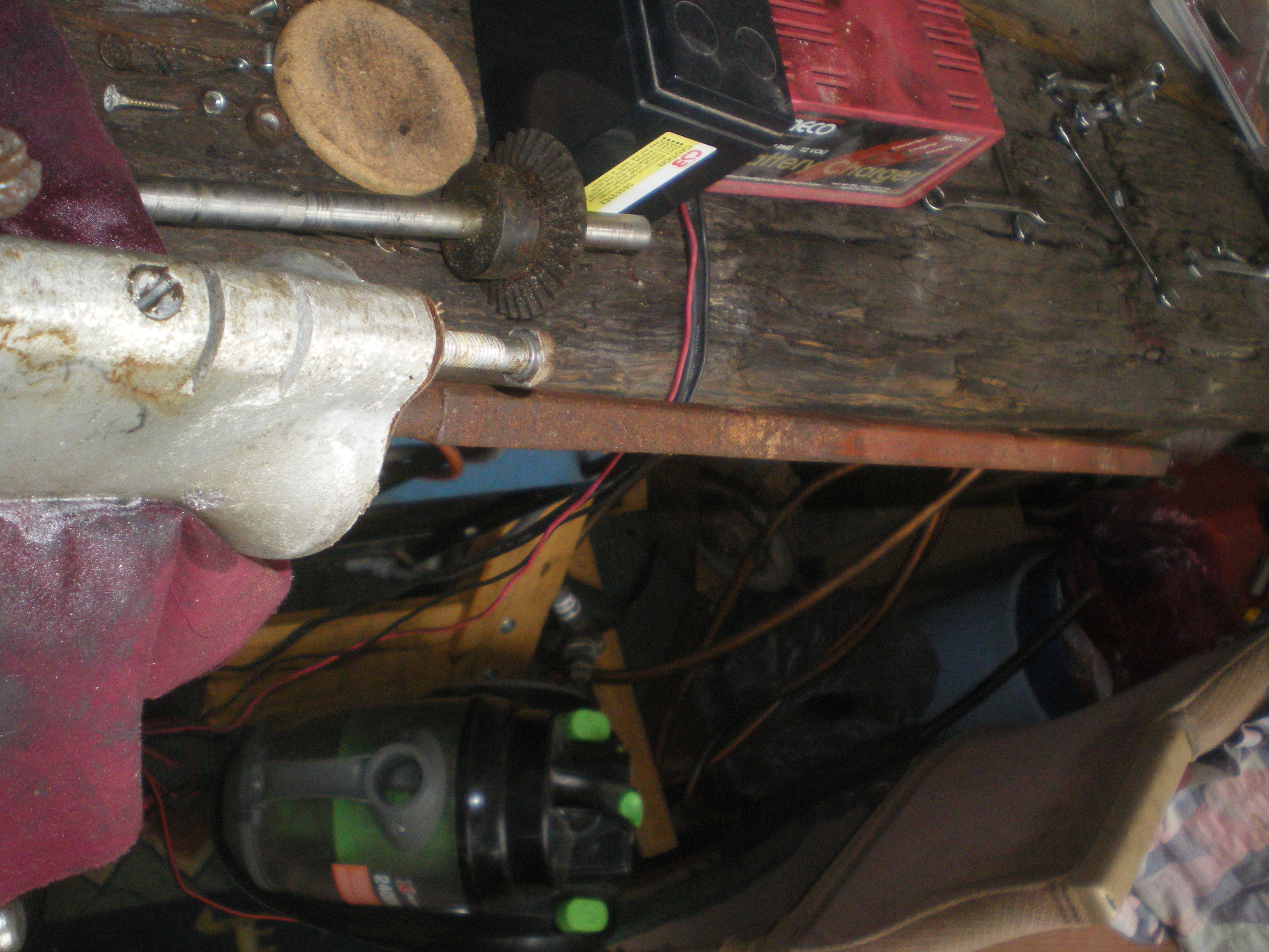

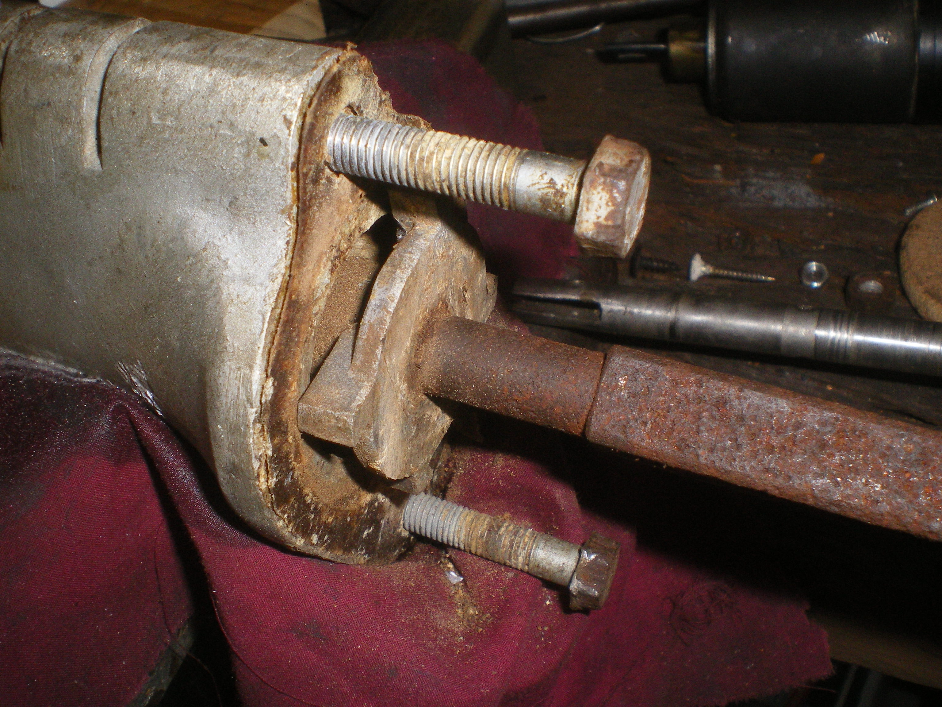

This is off a 102 TD (I think)
Can someone advise if this is the same configuration as an AD?
And which part comes off next? I always thought the square shaft goes through the rotor but appears to reduce to a circular rod. KEH???

As it's already apart, I'll take some photos of the drives and input shafts of my AD102 and post them up over the weekend.

Length of the square section is 18 7/16"
I note the square head waterpump and bevel drive are somewhat different to the 102's.
Still would like to see some pics of box disassembled.
