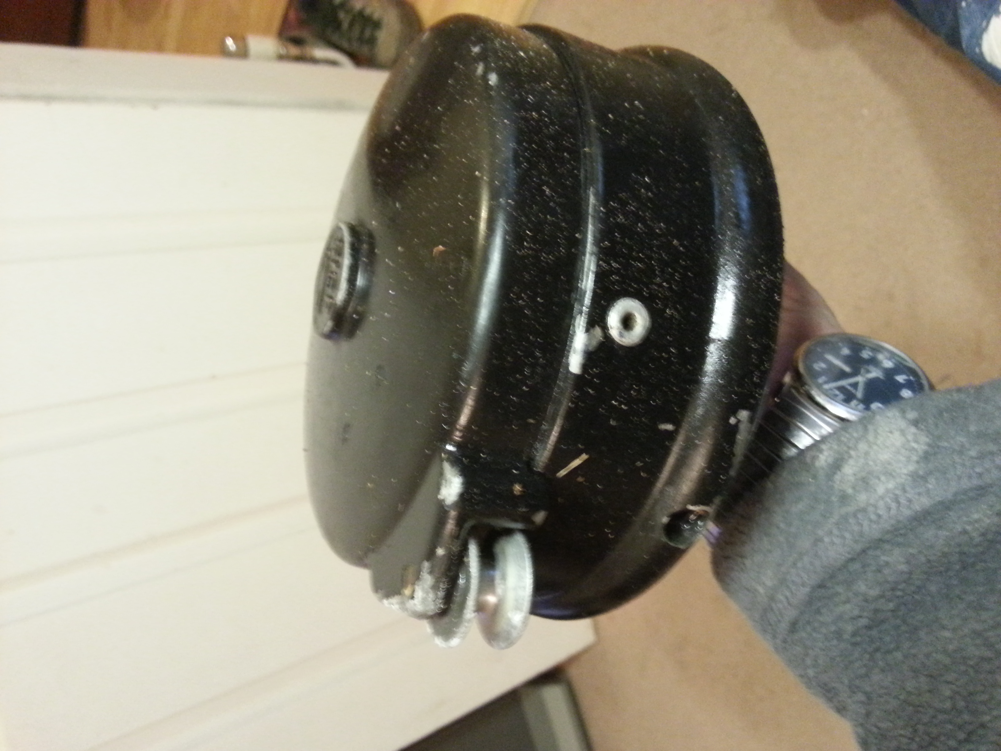

While I am on the topic of the recoil... How does that monstrosity come off? I removed the two flat head screws that go in horizontally, and then removed the 4 hex bolts that attach upward vertically. It is loose and moves up a bit vertically, but will not lift free of the motor. Something is holding it on. Is drilling out the rivets the next step??

Remove recoil, after removing two flat head screws. There can be some corrosion, but tap it off with a bit of wood.
It is this bit.
Under that bit will be the rope pull and the end of the crank with a nut on top.
Remove the nut, and then the aluminium flywheel surround will come off.
Before removing the flywheel, read back through many posts on the subject.
Let us know how you get on.
Post pictures " we all love to see a few picture".
good luck.
