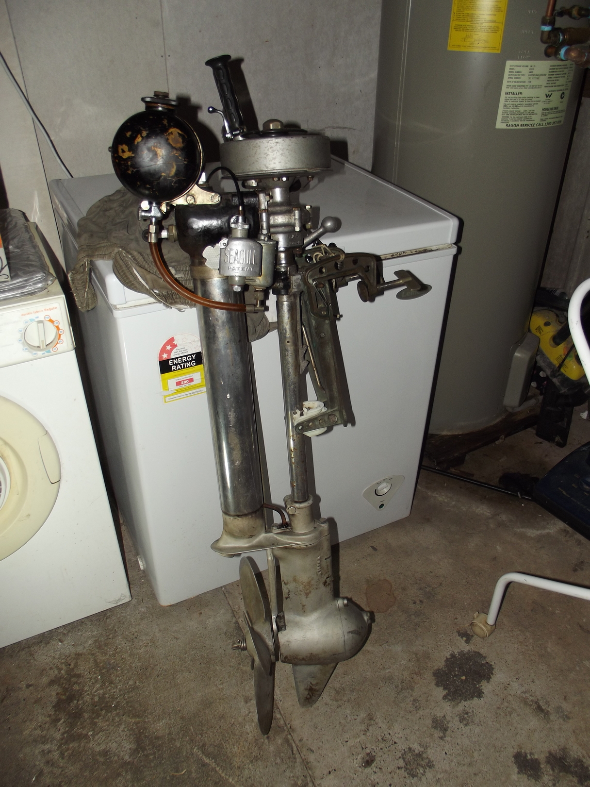

This is a short shaft barge pusher engine. i have three.
Hope the picture helps.

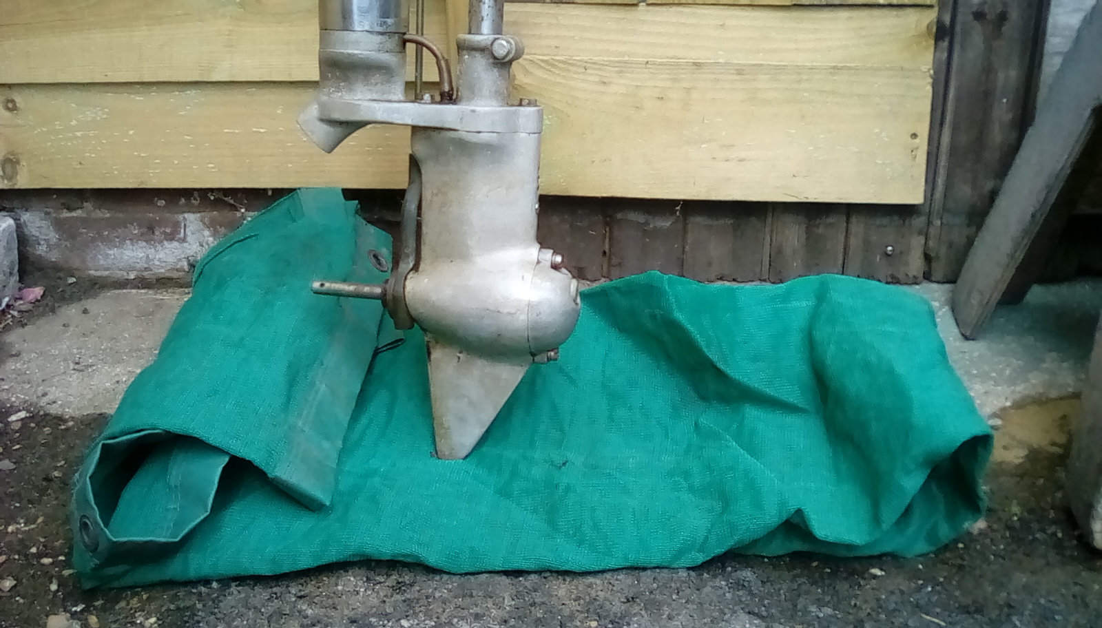

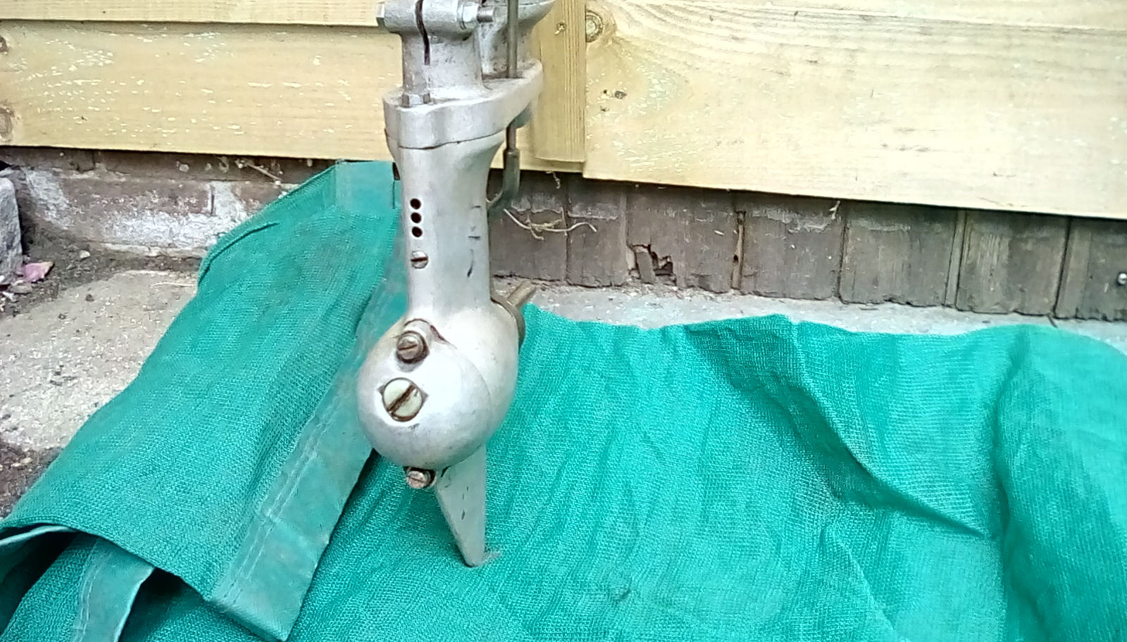

Thanks, attached are 2 pics. the engine is TC 55048L 1956 to 66. long shaft clutched
regards. Red.
Re: 102 help
If you check your serial number in the identifier it should tell you all.
TC **** L which is a 102 with a clutch & a 2.5:1 gear box, long shaft & pre 1963.
It would need an H to have a 4:1 lower unit from new.

Thanks Charles, it seems the g.box is right for the engine. what would a 4:1 box be used for though?
The reason I queried my box is that the engine gets a bit warmer than it should when made to work hard and then breaks down . I've had to use a smaller prop than normal to get the speed up and get good cooling. But of course the boat speed is down then.
