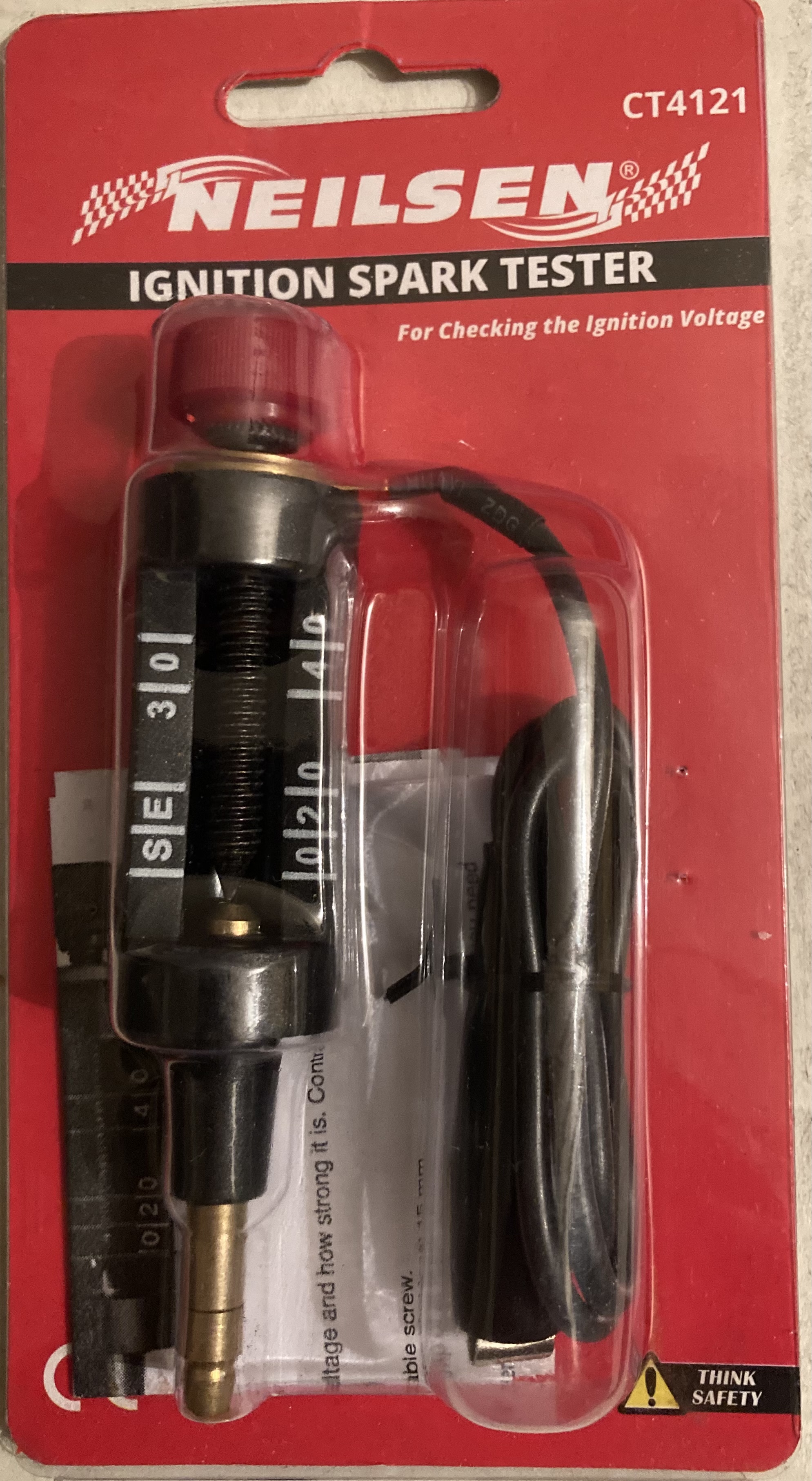

I have just bought the bit in the photo and one alters the gap according to the voltage

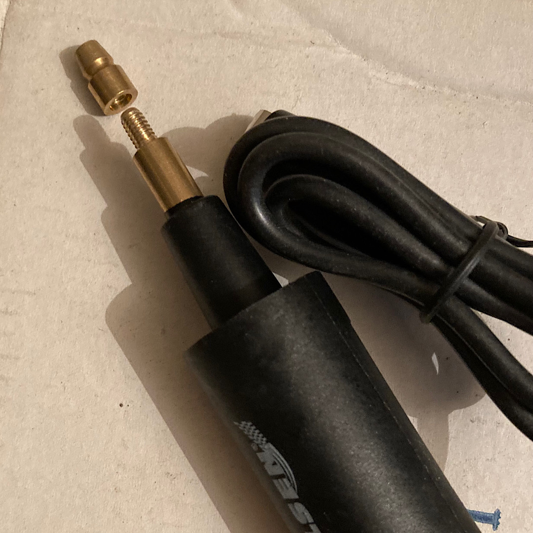

Also the Button on the end unscrews so you can put a spade end onto an m4 screw
Yes I know I can do it the old fashioned way but this looked better

I thought that was the purpose of these devices, that you set the gap small, test you get a spark, open the gap in increments until no spark, then return to the last setting where there was a good spark, should gives the voltage at starting revs, I think you'll find a chart in the instructions giving of the voltage required at various gaps.
Re: Mks 2 and 3 ignitions voltage
Most spark plugs need between 12,000 and 24,000 volts to spark.
Can be as high as 40,000 volts.
Why do you need to know the voltage?

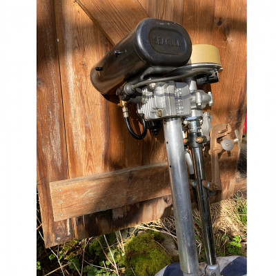

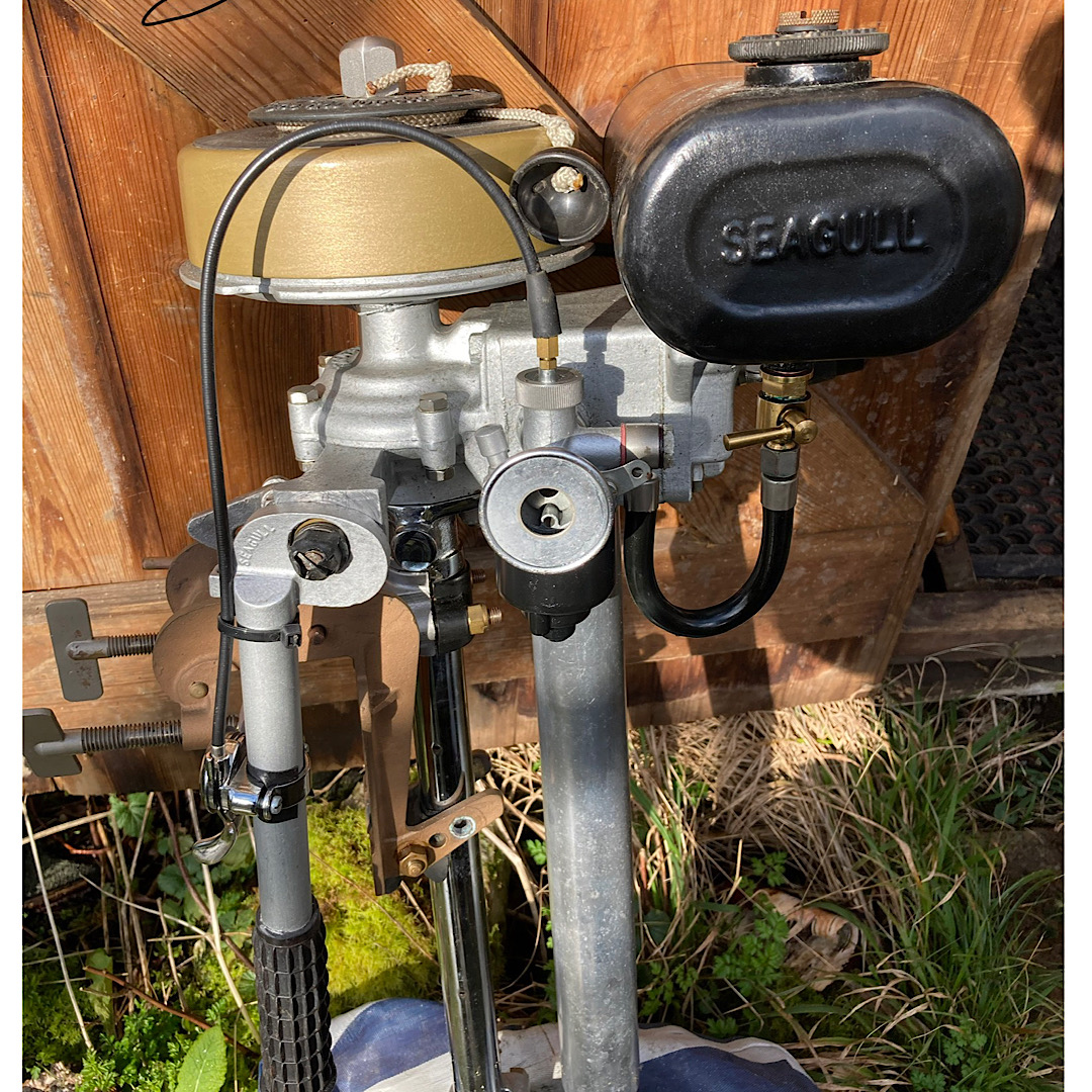

Wow your motors are in great shape, what sort of boat are you planning to use them on?

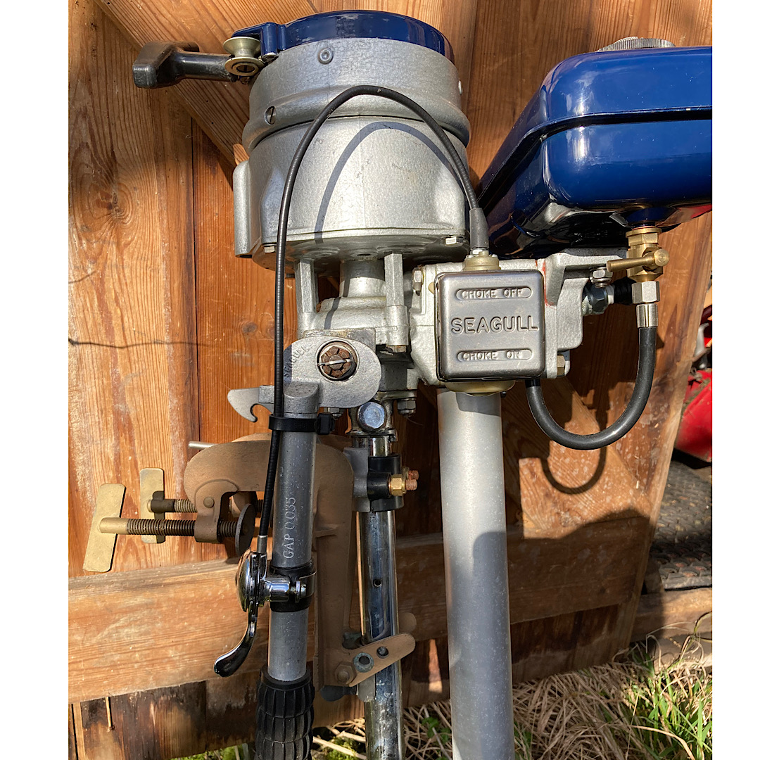

Interesting fuel taps where did they come from?
So if it sparks at A can we assume 10 KVA, if B = 20 KVA, C = 30 KVA, 40 KVA, isn't that what I implied?
Most owners don't fasten the throttle cable to the tiller arm as you run the risk of kinking the cable outer.

HA that is a very kind and generous comment, if I may say so, which I value greatly, having seen your photos of what you do! The only thing that still doesn’t look right is I couldn’t get a proper gloss on the black tank - I tried a large number of sprays with clear from the local automotive supplier but it didn’t work- perhaps I was too tentative about not putting it on too thickly in case it might run - which on a smooth surface it does only too easily ....
My 23 foot plywood cruiser (Robert tucker stretched his well known 19 ft caprice to 23 ft)
had to go, so I now only have an inflatable...much to my chagrin

Oh and I missed out that the Petrol tap comes from George at Villiersparts - sorry about it not being original, but I wanted something that would not leak, looked ok, and had that rather unusual thread on one side, for which I could not get a tap or die....
I also put a longer screw at the bottom of the drive shaft leg, with a locknut on it- after all it’s all there is to stop the whole lot dropping off!

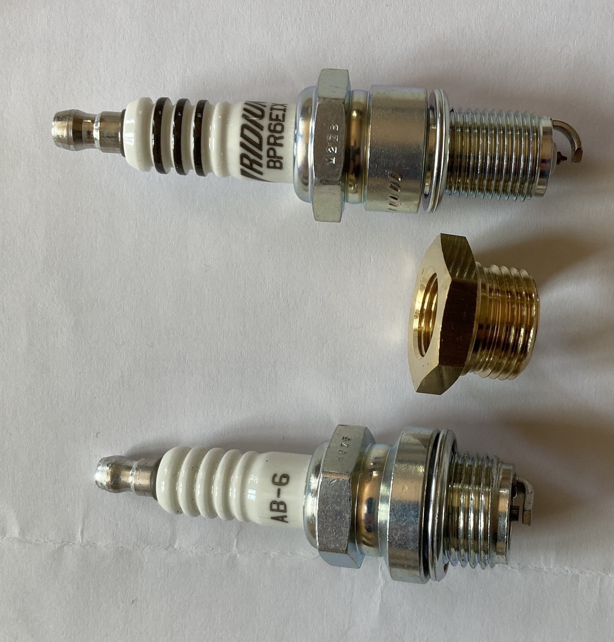

This thread was left unresolved, so here is what happened
The problem was that I could not start the restored 1969Featherweight .
I built a test bed from a base plate and coil and flywheel so that I could actually see the spark - driven by a battery drill on the top of the flywheel which meant I could replicate slow speed for a pull cord start, and a higher speed for normal running
It became apparent that the spark on low speed was very weak and small and intermittent - whereas it got much better at higher flywheel speeds
I then found a guy who could increase the windings on the secondary coil, thinking this would produce a higher voltage spike - he increased the number of turns by about 1500, and when it came back, the ohms reading on ht to ground was 7130 ohms at about 20degrees c - he couldn’t do more because of the constraint of the size of the coil housing
The engine even then would only start if I injected naphtha (engine start) after which it ran well and evenly

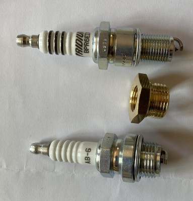

I then rang Ngk spark plug technical advice and explained the above . The guy there said you are in a similar position to my customers who run 1920/30 classic cars, which have to be started with a crank handle ie a slow hand start
He pointed out that iridium plugs will spark at a lower voltage than others - so try that . He also said the match to the champion d16 or Ngk ab6 would be more easy to get if I put in a plug adaptor that brought the 18 mm plug hole back to 14 mm, because there is a greater choice of iridium plugs in the 14 mm size. Also it has to have a squash washer, not a bevelled edge, above the thread.
The plug adaptor means that the iridium has to have a longer reach - so he specified Ngk BPR6EIX
These are now fitted - and I am very pleased to say it works! I can now start it at pull cord speed
I realise this is not how it should be, on the other hand if it works it works! Plug photo attached
I hope this helps a first timer with mk2 starting problems - any comments?
