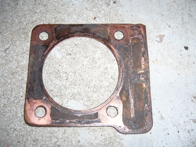

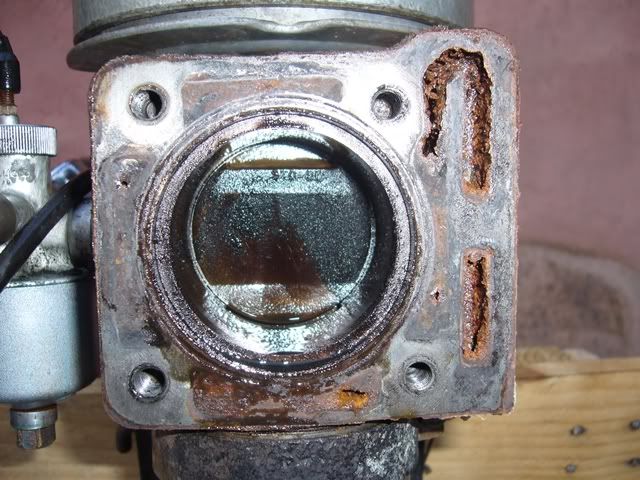

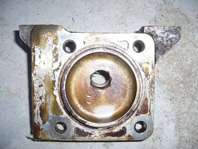

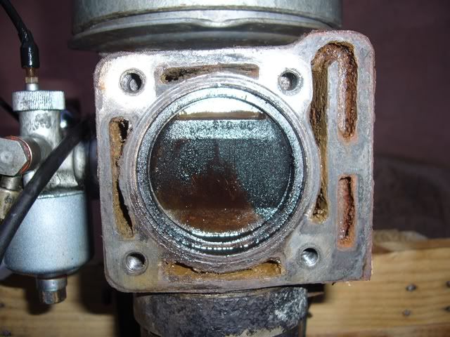

So I decided to do a more drastic treatment, and I removed the tesyta from the cylinder and this is what I saw
The steps of the water were blocked by a reddish pulp hard to the touch I had to patiently remove with a long thin flat screwdriver to get this done.
I hope that the debris will be crushed and I hope that next time you restart the engine, the water flow pushes them out of the cilynder
The following is a head with the copper gasket that seemed in good conditio
I will keep you informed

Re: my new ''old'' motor
That is the best way to clean it out. But you need to do some more work to remove more of the rust.
Make sure you get to the bottom of the water passages.
Post by Massimo »
Certainly, I realized that to do a thorough work must remove the cylinder from the crankcase at the moment but I would not do it, I'd be happy to have the engine running to do some sea trip next summer and then in autumn I will proceed with a accurate restoration of the parties comprising the chromium oxide, a stripping of the aluminum parts and the paint canister fuel and fly.
Of course, if the test was not satisfactory in the bin and not see the discharge of the cooling system does not work, unmount his head again and try to clean more thoroughly :D
Yes it is better to use them than polish them.
Put some grease on the bolts when you put the head back.
I dip the end of the head bolts in RTV silicon sealer it's stops the ends of the bolts even getting wet, but only if the head bolt holes are open into the water jacket.
