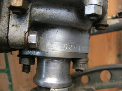

At first it looked like AI, later on like AT, but both do not exist. Now I'm thinking about AD because the time frame is correct.

The original letters look to have been ground out, for what ever reason, I doesn't think its a seagull font its been re-stamped with, but I'm no expert.

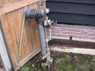

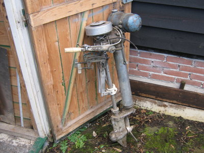

And many bolts/screws replaced..
I love the 10600/145 turns!!!

AD52014
looks as though it's been "got at". (i have seen several variations in the letter/number stampings for the serial numbers so probably "factory" on that one)
the serial number indicates it was made between 56/57. From the research i've done so far, the gearbox looks as though it was from something a bit older than the serial number would suggest. 1 gearbox oil nipple would normally show on motors right around 1950 when the "sub ejector" pump housing was introduced. The "bow tie" prop is 100% correct for its age. Not entirely sure about the cylinder either.(slotted core plugs normally ended around 1955ish although there could be a slight overlap somewhere)
Transom mount is much later (1960's onwards or thereabouts)
Flywheel nut is ........(wrong) looks to be from something non seagull.
Inlet cowl looks to be "repaired" in some way! (there shouldn't be any bolts or screws holding it on) and there should not be a choke flap.
Fuel tap and line look to be a "homebrew special"
Good basis for a resto on this one.
All depends on how "authentic" you want to go with it.
pm me if you need any more info and i'll do my best.

The original numbers have definitely been altered or got at.
Could this outboard have been used on the high speed drug runs into the southern USA ?
All or any other alterations done to provide maximum performance and to make tracking difficult.
