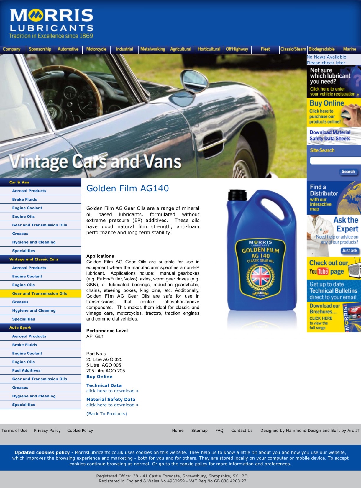

These are the gear oils I use and pretty cheap too, I only pay £19 for 5 litres from my local suppliers. They also do an SAE460 but that comes only in 20 litre cans.
