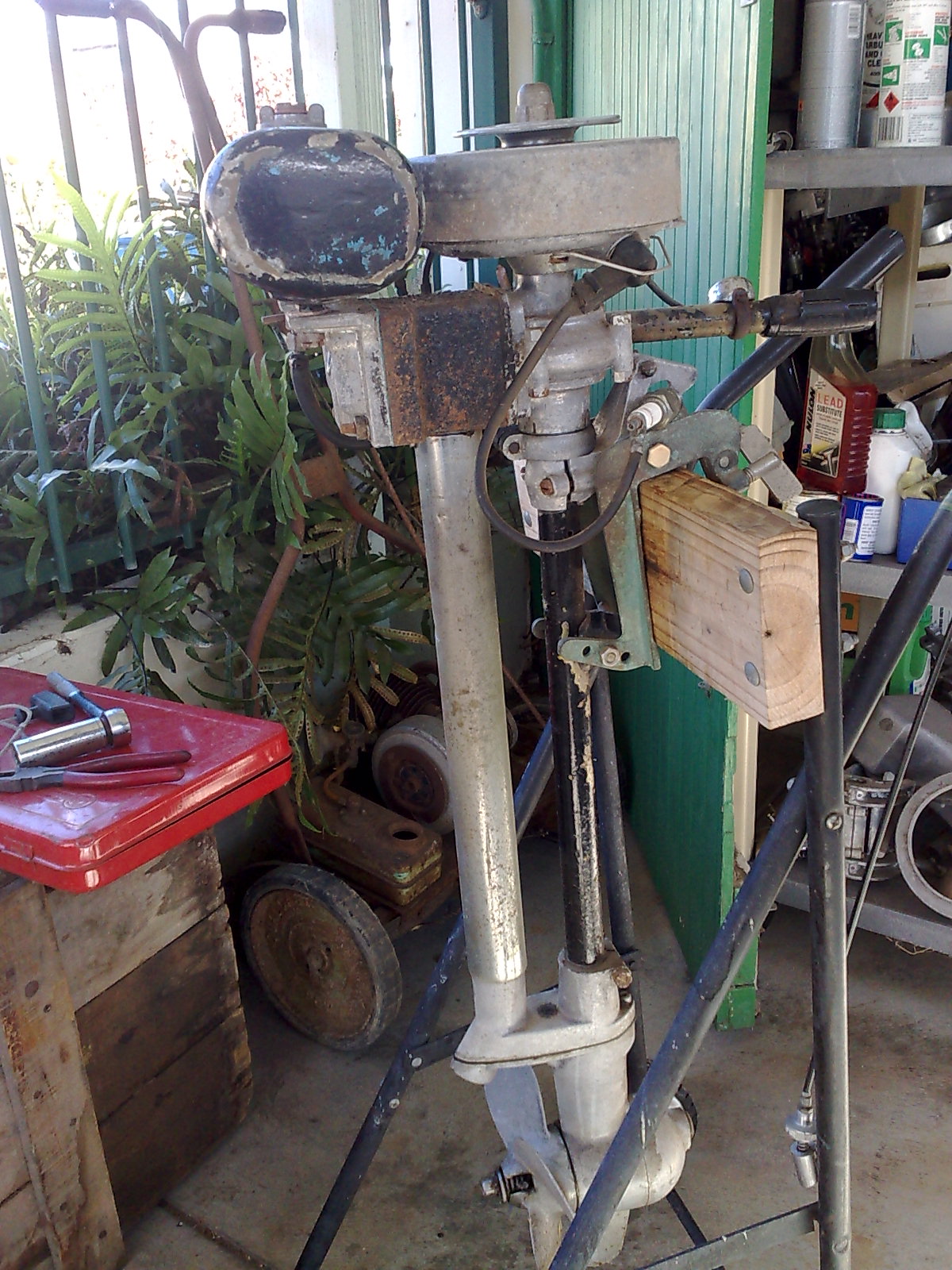

Having a play.....just the basics.
. 10" tiller
. Carb slide has hole for pin but no pin carb top. (I always thort the pin was a guide........like my FVP......the pin just slips into the hole effectively keeping it square on at over 1/2 throttle) :?:
. Interesting country fix for points. It worked.

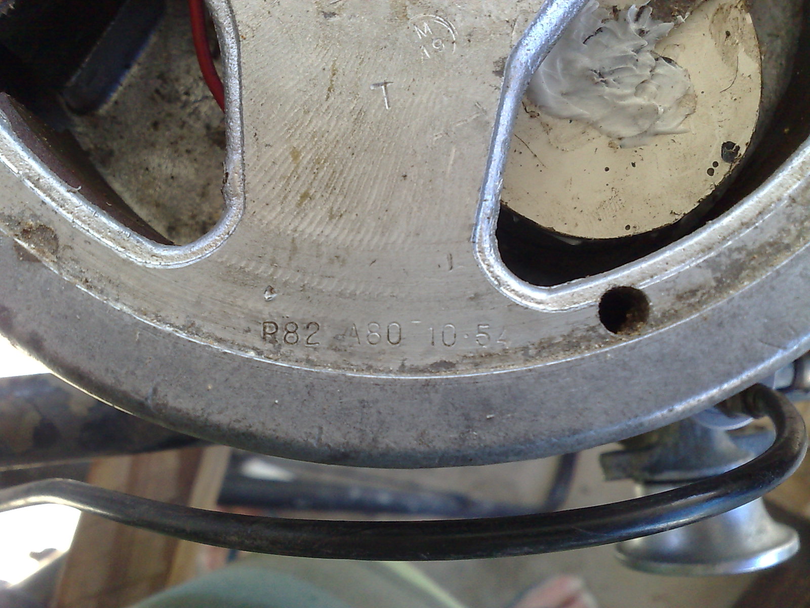

. Date flywheel 10th 1954.
. Tank is smaller by 1/2" or so. (I have forgotten where I read the reason) :?:
. There is a chrome job under the tank paint. 8)
. Hole in fuel bowl and hole in choke.

In Tank.
Started easily and settled down pumping water instantly as normal so no mud demons.
Reached for the camera and "That sounds Odd".........Raw fuel spitting out of the carb bell..........coming out of the air equalizer hole until the inside of the bell was full..........No Go NoMo.
The carb main jet holder had been played with and was very easy to insert.........with a wobble when seated. That is It then.................find another. It was bin fodder.
Another found and installed (Jet body in Ice Water and carb body in hot water. New Fiber washer and jiggle juggle tap tap OUCH (Yes carb body was HOT) :x .
Nice tight fit when tapped down and locating screw firm.
Once again into the tank. Once again exactly same problem. Checking the plug both times it was sooty and dry.
Noticed this second time..............when roped over on or off the choke............carb spat!
Same thing out of the tank on stand by the way.
I have not checked if the ignition plate locator is in the hole...........
It is very much like the piston is opening the cases too soon..........
Transfer port/crankcase - area - lower gasket recycling..................Between gasket/shim and crankcase..............No water anywhere it should not be.....
I really do not want to go there......... :cry:
Cuppa and back to it. Lovely day for Gullatious Antics.

Flywheel date of October 1954 fits in nicely as LS27084 was the last produced in 1954 and so I expect 26125 was produced at BS in Nov/Dec 1954.
