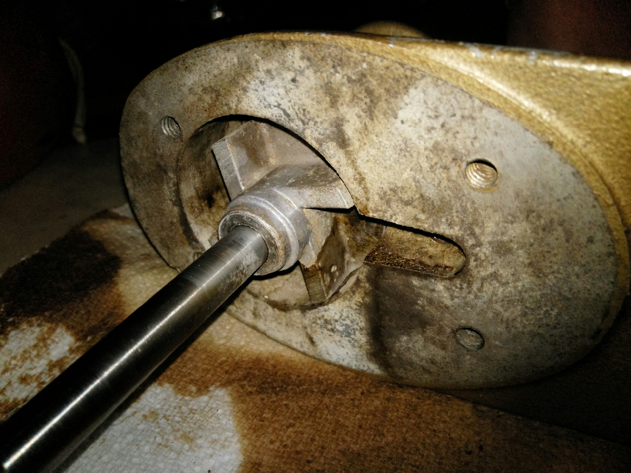

As per picture, I would tap the top part of the pin straight and pull it out from the bottom, Make some new ones from brass bar, with some extras.

Half way down the leg are three screw/bolts, inside is the impeller, it just keeps the exhaust and cool.

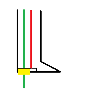

From this very rough schematic I've thrown together, is this correct that the exhaust gases flow into the impeller housing, then out via the two small holes on the opposite side of the prop on the gearbox? I can't see a way that they would come out of the "duck's beak" hole on the lower leg like I would have thought.
Re: SeaBee 3 questions / manual required
One question, has your drive bar a key way around half way up of it?
That will answer your question.

As far as I can remember, it pumps water into the exhaust/drive tube and it comes out with the exhaust gases.
