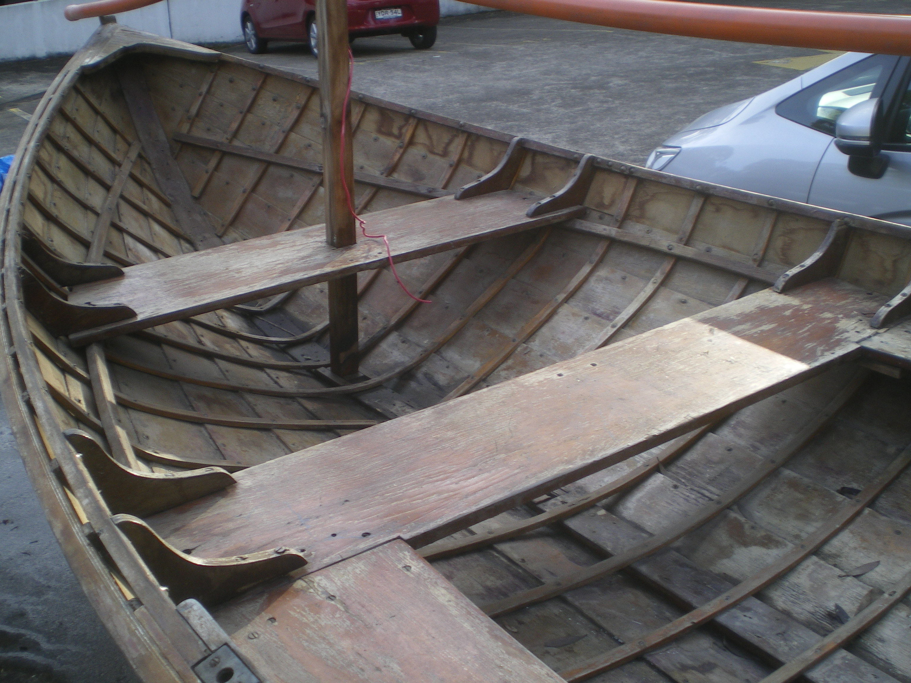

It looks in quite sound condition I can see the keel slot needs plugging how about a few photos of the damaged areas.

Needs a good dry out. Not the best photos:
Plank next to keel. Inside looking down.
Another rotted plank on bottom.
Starboard side. Think at some stage it must have been sitting on its side outside.
The quarters and some hanging knees are rotted too though I can do those. It is mainly to scarf in about five plank repairs.. Need to put some floorboards in as well. Planks made of 1/4"marine ply. I have 6mm sheet.
A shipwright also advised me to add a heavier timber skeg keel to the existing. It is the same as this all along. Also suggested a bulkhead about 2ft back to strengthen the bow quarters.
Ideally it would be good to replace all planks. There are 6 each side.
Now I'm feeling lazy :oops:

:shock: How sad I thought she would be an easy repair, honestly I don't think she's worth the effort Dry Rot
would be a lot worse than the photos show :cry: . It would be easier to do a new build I'm guessing the shipwright
saw it about 4 or 5 years ago.

Hugz does anyone run a wooden boat building course near you? what's left of your boat would make an ideal project for a class of apprentices, it's a beautiful shape it would be a tragedy to let it crumble away, very close to criminal!
If it was in this country, I would be tempted to take a GRP mould from it, if it's still true.

Good to hear from Hugo again :D One of the stalwarts of the forum :P Yes a lovely boat, and well worth a decent restoration. I'm sure Charles suggestion has some merit, perhaps a great project for a boat/woodwork class. It would give you access to all the correct tools too.

Ok, you guys have inspired me :P I've been through contacting boat building schools and technical colleges but without a good result. Space always seems to be the deterrent. I did have a promising lead with a maritime inspired "Mens Shed" but alas the space was again a problem. So.... I'll do it myself. I have a parking space and have to work on it there and include the trailer too! Fortunately it is a dry day today (1st in many days) so cover off and let her dry and make a timber frame to bolt to trailer so can work on boat hull up. She hasn't got a name and I'm thinking of Charon (of Greek Mythology, is Stelios still here?) It is actually not in as bad shape as I imagined. I think a long shaft naval SD will compliment her well. I could probably join a wooden boat forum but I think there is enough experience on here to guide me 8) . Timber is a new medium for me.
