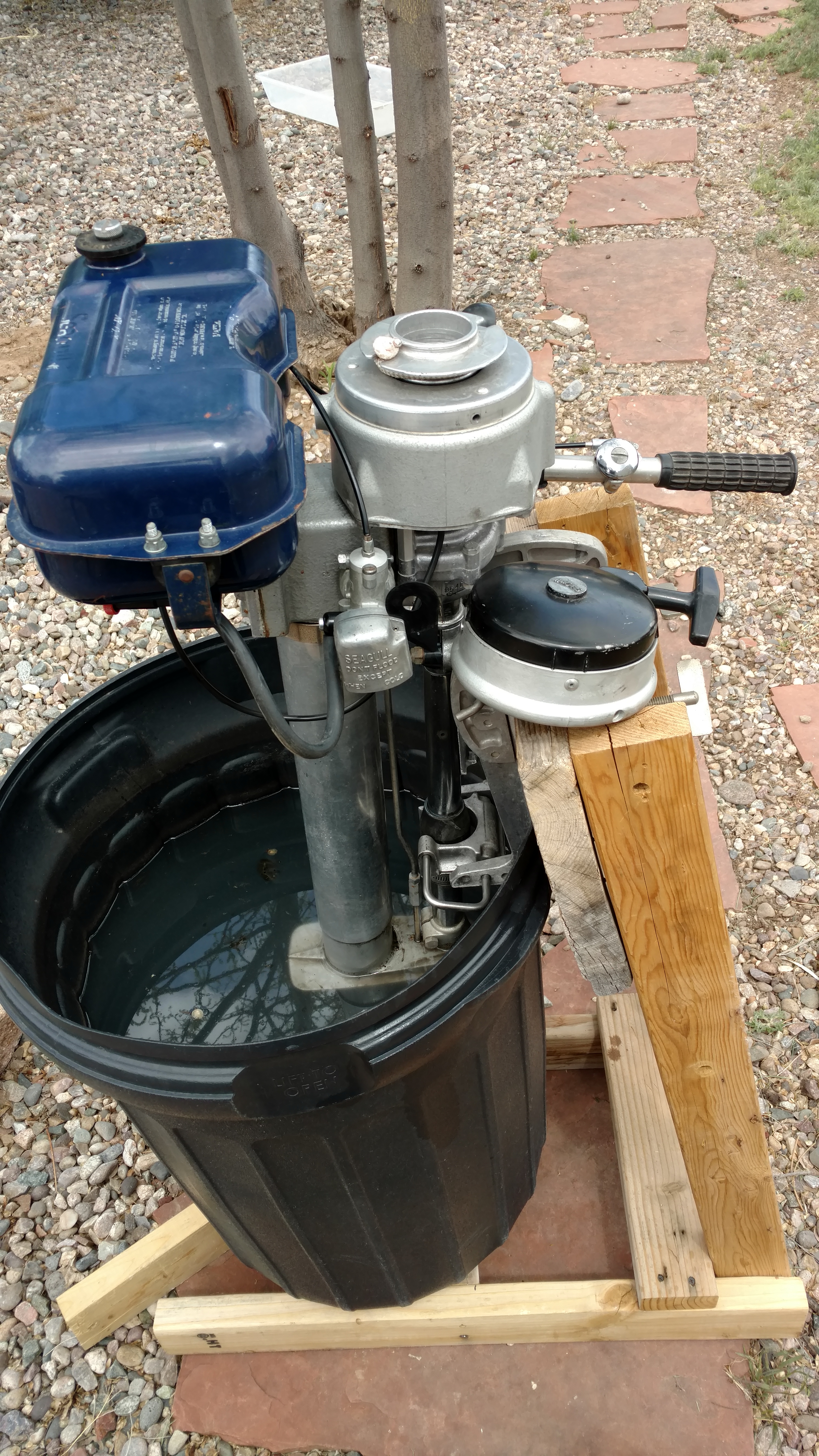

Here is a photo of the EFNR after the test run in my "tank". The starter is off my EFPCL, which has the blue starter of this motor. As soon as I take a wrap to tighten the spring, and get the screws from John, I'll put the right starters back on the right motors. But, they run. I'm not sure the big tank was stock or an option, but it should provide lots of run time. Once I'm sure its running long-term, I'll spiff it up a little, repaint the tank and cover, and get a new decal.

All looks pretty good to me.
Tanks are an interesting thing that sometimes get swapped around i've noticed.
The steel tank currently fitted (as far as i can tell) would have been an original fitment. My EFNR is no different and was built in late 79.
Later models sometimes have the very nice plastic fuel tank which doesn't corrode internally like some of the steel tanks do.
Should be a fairly simple job to retro-fit the recoil unit back in place.
Blue or black (to me anyway) doesn't really matter although this may have been a standard colour combination at the time i.e blue recoil top and blue tank, or black recoil top with black plastic tank.
I think the recoil units for CDI ignitions are the same part just painted a different colour that's all.
The actual ignitions themselves vary slightly in the coil units and flywheels, but most of the other parts seem to be a straight swap with no bother.
Good job

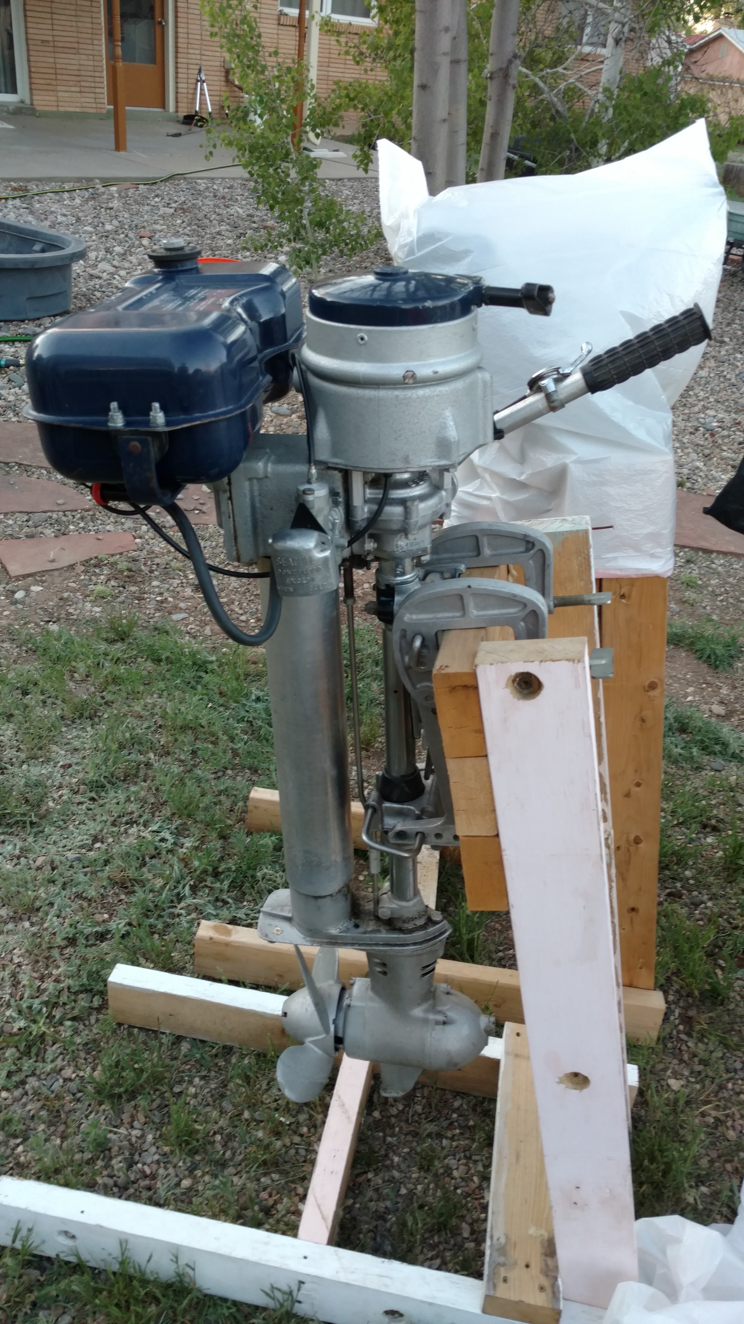

One more photo. I put the original blue starter back on and put the black one back on the EFPCL. I had to repair the black starter which is why I swapped them earlier. The EFPCL was black tank and black starter, the EFNR blue tank and blue starter.
I got the starter fixing screws from John today (as well as a fuel tap, a used throttle lever, and 2 spare gear case plugs. Thanks John.
I now have 3 fully operational Seagulls: a 76 Featherweight 40, a 79 EFNR Silver Century, and an 85 EFPCL 40 longshaft w/clutch.
Now I have to get on the water. I can't wait.
