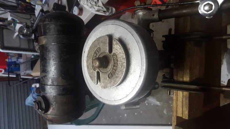

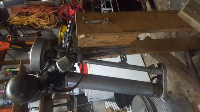

Picked up the 102 this morning. Pulled it out of the box for a look at his place and it all looks original as far I know anyway. Old fella I got it from reckons it hasn't run since the 80s, this will be fun :lol: . Can't do anymore today as I have to go to an Orchid show with the misses ( which I reckon is as exciting as going to work on a Monday morning :roll: ) Anyway works both ways I guess, her and her orchards and me and my seagulls. Cheers Bob

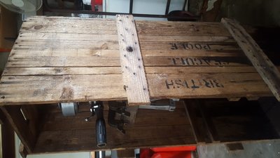

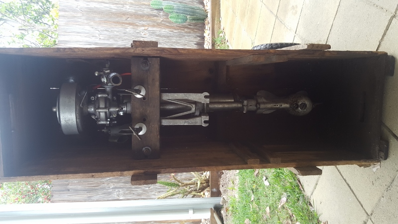

When I bought it this morning old mate says "She is a bit hard to turn over you know and I never figured out why". Anyhow first thing I did was drop the gearbox off and everything turned fine thought better have a look inside and this was the contents of the gearbox :shock: no wonder it had difficulty rotating. Pinion and crown gear seem ok? Really good clean out and a dash of oil to fix this up I hope. Also a picture of 102 without box so I can make sandcastles with contents and the flywheel plate has no words on it? Oh well, I get sick of reading most of the time :lol: .
