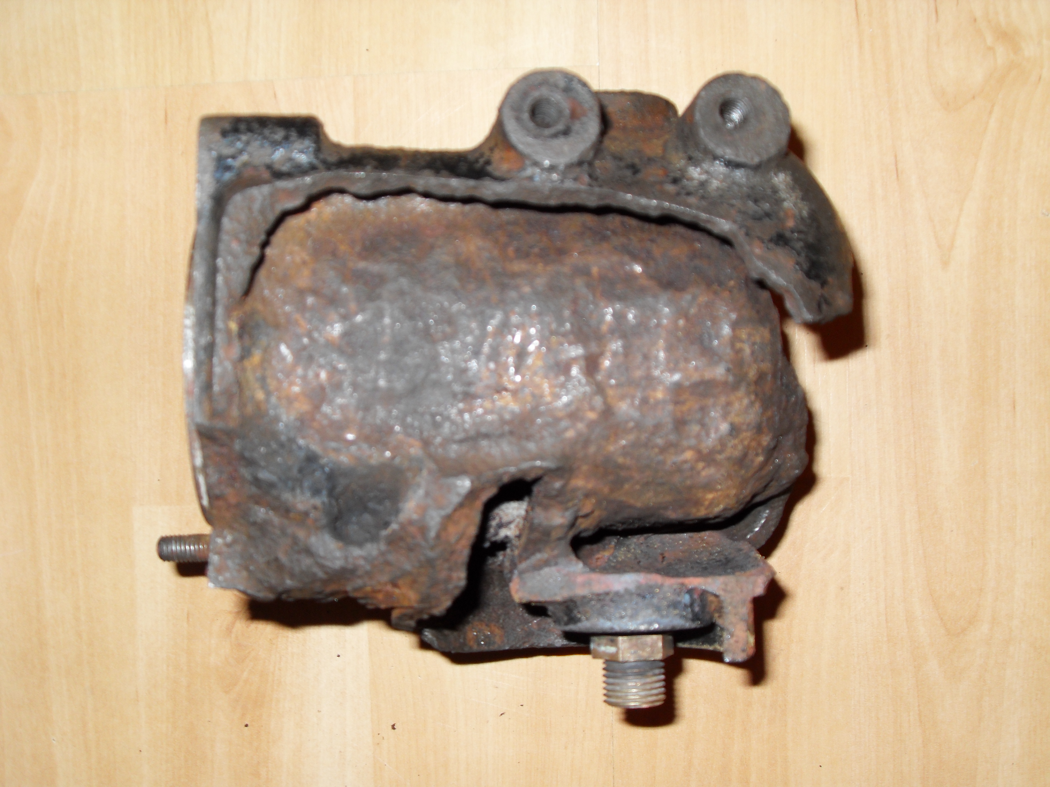

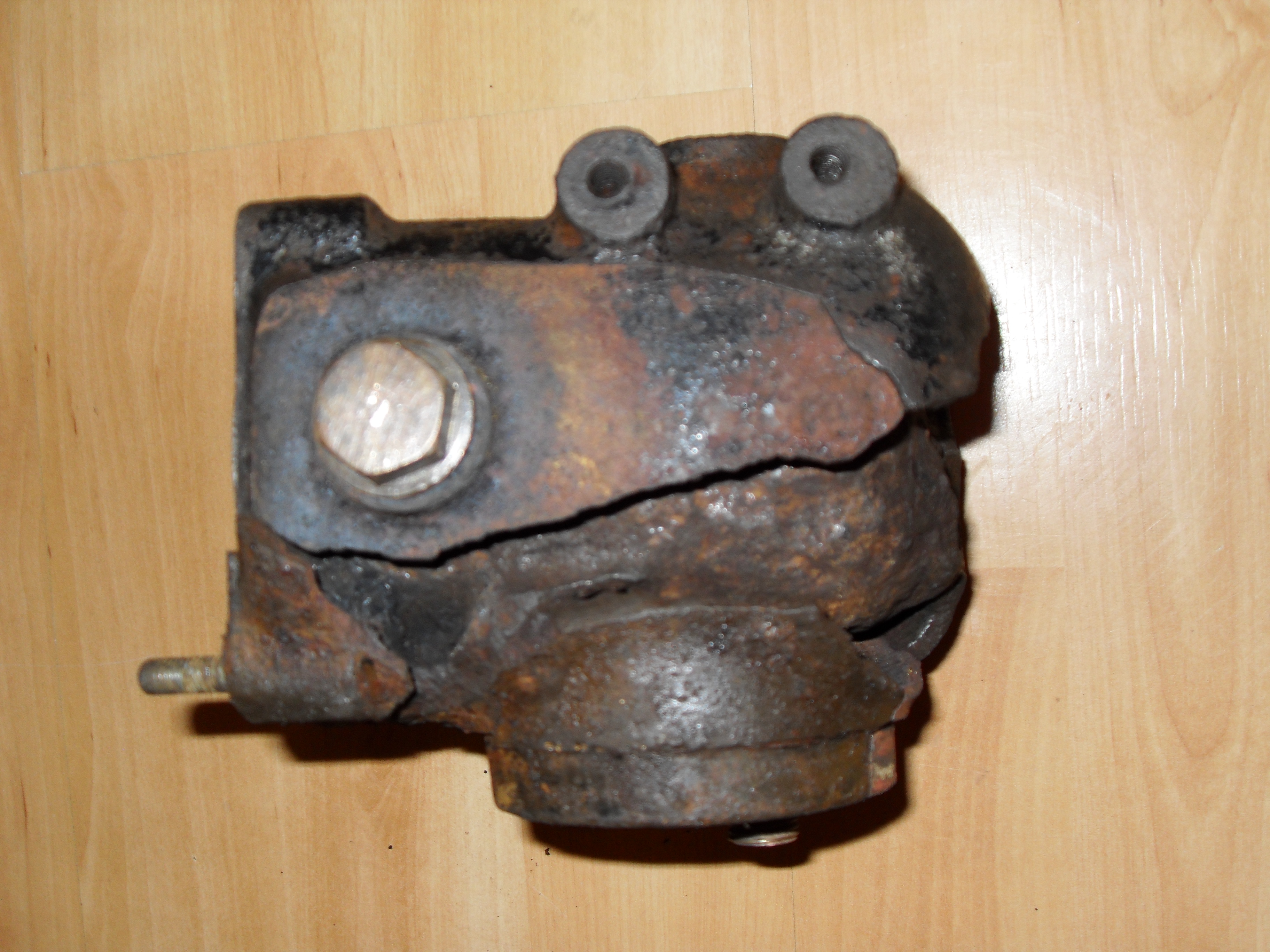

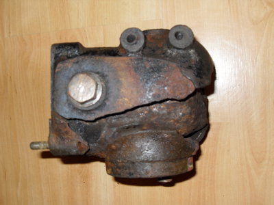

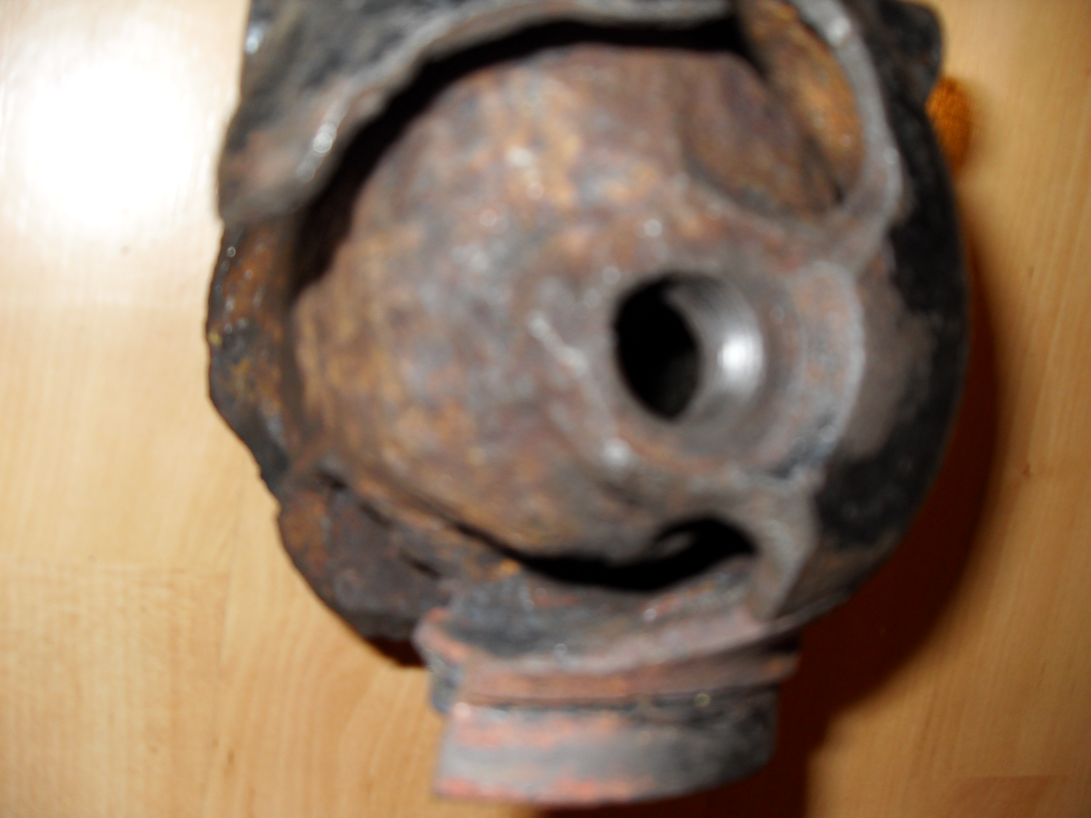

I've taken the liberty of showing a few pics of an exploded 102 cylinder for reference purposes to show where the waterjackets are in these cylinders. It might help someone else with the same predicament. :P
water jacket extends right around the spark plug area. difficult to get at but stiff wire helps for those hard to reach areas.

this was in a very bad way when i got hold of it, but it provides a useful source for reference.

with the bottom water pipe fitting removed you'll often find encrusted rust. this acts like a restriction and shouldn't be there.
