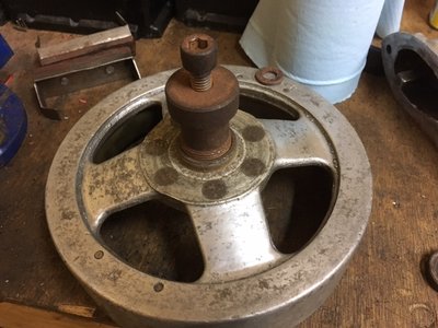

Has anyone seen and or tried this method of flywheel removal? Comments?

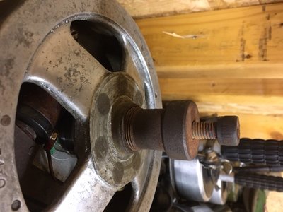

That probably would work but i woundnt recommend it. Do it this way on villiers MK1 and wipac mk2:
https://www.youtube.com/watch?v=ahfY2POTOfQ
Also here is how a coolie flywheel puller works for those who don't know.
Remove the flywheel nut, rope pulley and coolie cover. Next you thread in the flywheel puller all the way so it has more grip and wont damage the thread in the flywheel (this is a left hand thread). After that you use a long allen key or allen bit on a ratchet and turn clockwise till it tightens, you will feel a tight spot then 1/4 turn later the flywheel will pop loose.
Don't forget the grease the flywheel nut on the reassembly process as you don't want it to seize on the future!

Re: stuck flywheel
Above, the right tool, for the right flywheel, pullers are not recommended for later flywheels, I myself have never had a problem removing a Villiers flywheel, never used a puller on one and have seen first hand what can go wrong, with just the boss attached to the crank shaft.
I don't have much experience with wipac flywheels, as I don't collect late seagulls, but they seem more problematic than the earlier Villiers.
But I'm also aware that the early wipac flywheels are much more fragile than the later ones, just something to remember.
The hold up and hit technique has always worked for me, using a copper hammer.
The reason for a lot of different flywheels having threaded holes around the centre, other then for mounting the rope sheath and so on, is also for mounting a puller, to pull at the centre of the flywheel and nowhere else.
I used a puller on a jap engine once and it pretty much knackered it.
If you are frightened about damaging the nut, use another.

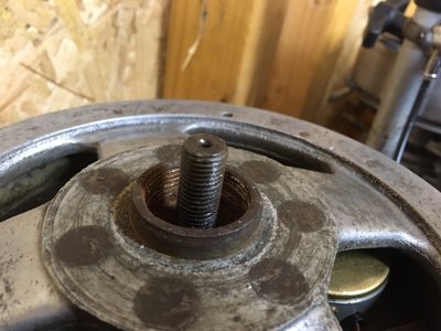

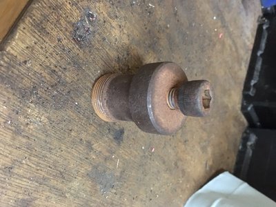

Re: stuck flywheel
My two early 1930s Britannia engines have a puller built in to the flywheel, which uses the nut and the rope pulley to allow the nut to be unwound and to hopefully pull the flywheel off. Quite a neat design
Not sure if the Anzani did the same?

Re: stuck flywheel
The Anzani SS has the same setup, but not the old ones, they have a villiers flywheel and ignition.Not sure if the Anzani did the same?

Who said special and expensive tools are required to remove a seagull flywheel? Nobody did. The joy of seagull is they can be worked on easily with a minimum of special tools. The puller for coolie hat flywheels is of course a wise investment if you have one of those engines.
The key thing to remember is that the cranks have a precision ground taper, so avoid dressing it with emery paper, because if you do there is a good chance you will introduce high and low spots, and then the flywheel will never fit well.
Clean and remove any burrs and that’s it.
