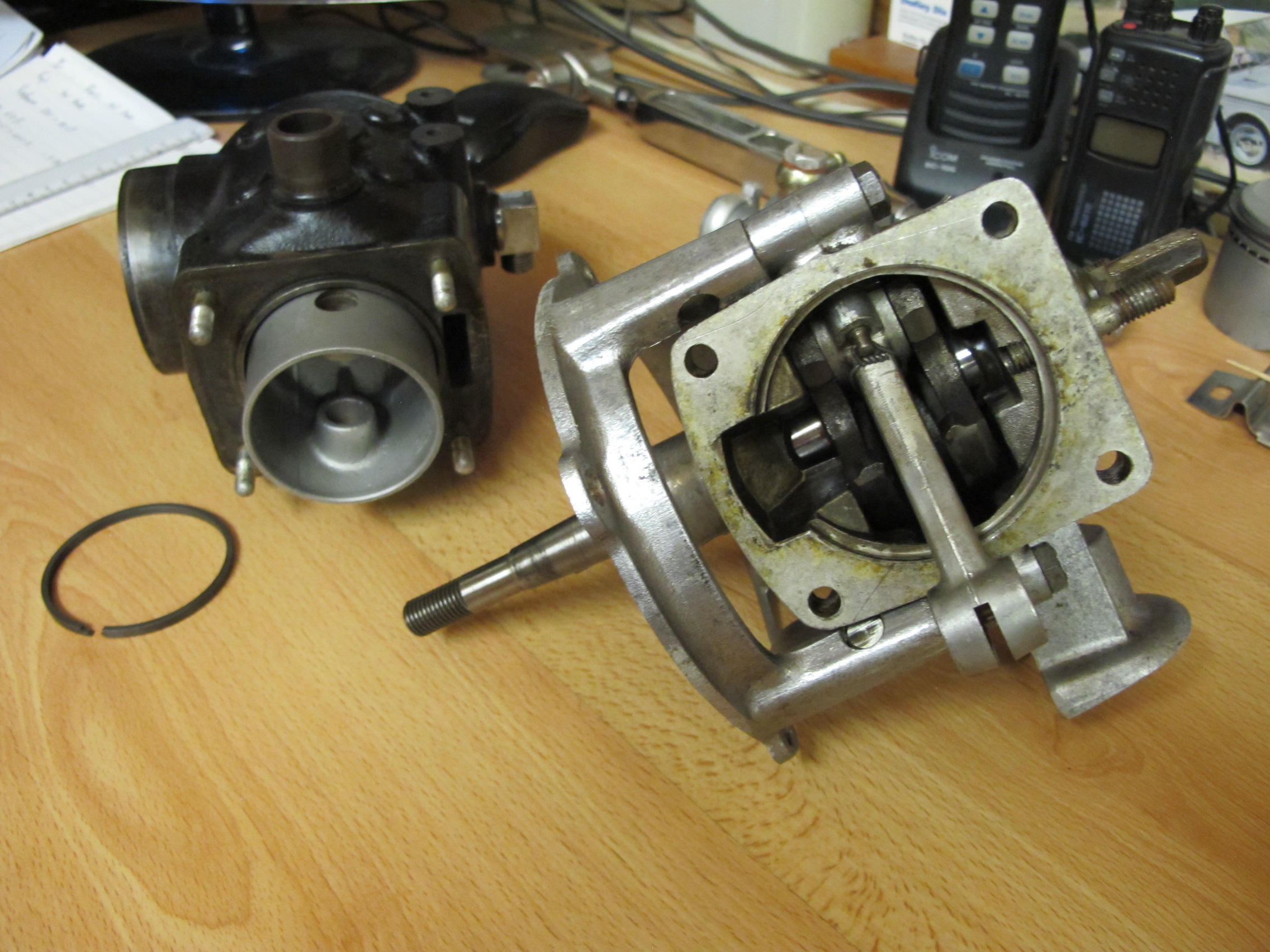

The crankcase stripping on my 102 engine was the first such event since I started restoring the Seagull engine.
This engine had a seized top piston ring but the motor was in other respects in good condition, in some ways like new?
Can someone please post a picture of the other options for Seagull cranks.
The engine number on this one is WHCH 144R8

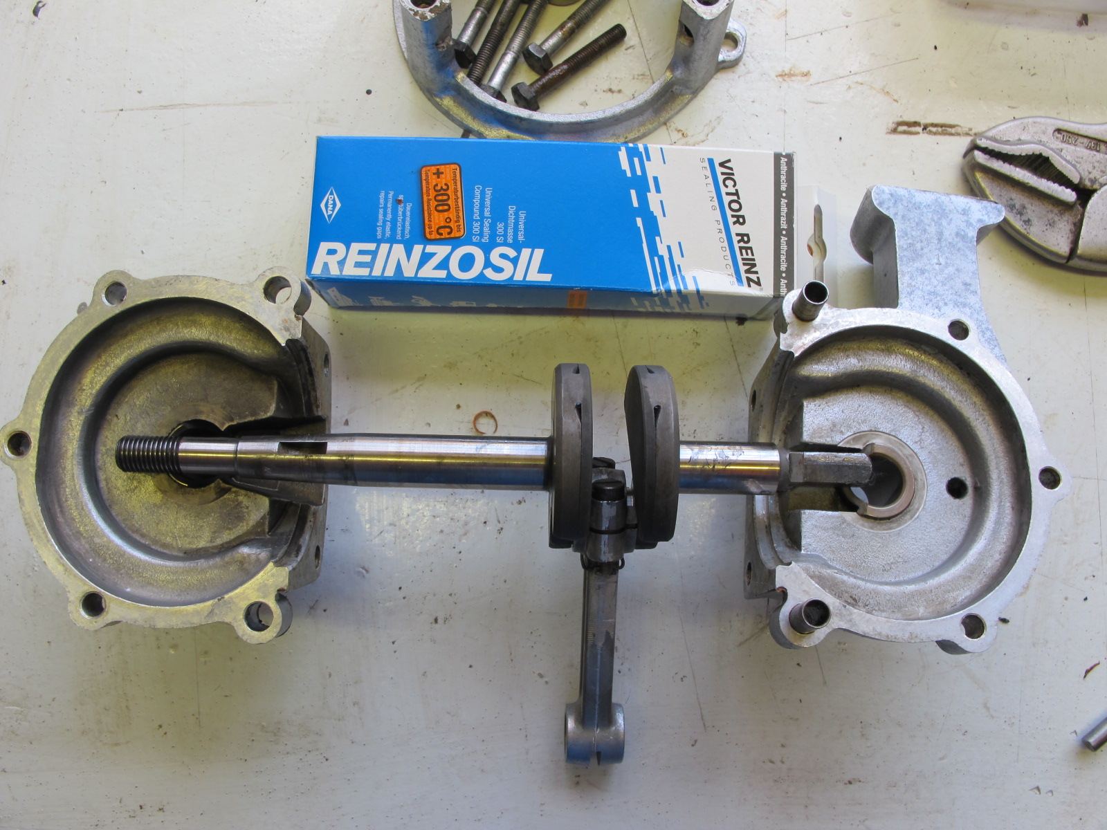

Another view of a 102 series crank.

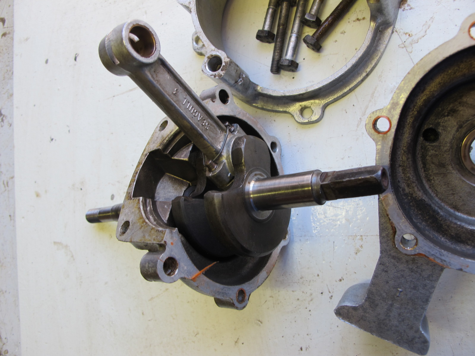

Post by african imp »
Another image of the same engine, when re assembled and I tried to start it, there was ignition on the second pull of the starter cored, it was running on the third pull :P
