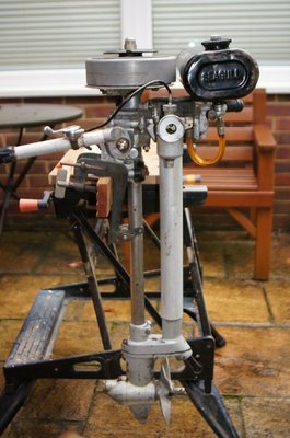

The more I look at this the more it seems a bitsa. The engine code makes it 55-56...so the tank, fuel cap, throttle lever, ignition, all wrong - unless the SOS identifier is way off. But it has a 'bobbin' instead of a thrust block. Can this plausibly be an original part?

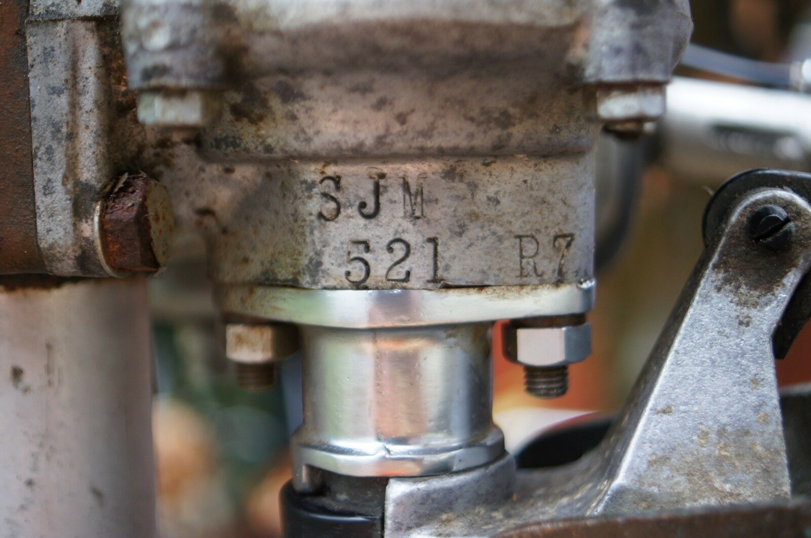

To be fair, It is difficult to mis-read...
What I reckon since posting is that this is a bitsa made from a 70s featherweight but using the early cases (look at the contrast between the cases and the top of the driveshaft tube) - and an old transom clamp, perhaps originally belonging to the cases. Because everything is consistent with a 70s offering except the serial...which the SOS identifier doesn't like.
Anyhow what I want an opinion on really (already asked Jeremy!) is whether or not anybody thinks it is plausible that a cotton-reel thrust block would have appeared on a fifties SJM!

If it's an aluminium cotton reel then it's possible mid 50's.
It's the 7 that's confusing.

The "R" does suggest a return to British Seagull for a rebuild at some point during its career. I would be surprised if the chaps at the factory didn't swap the cotton reels out for the later component at that time. They had, I'm told, a fairly generous policy of "new for old" parts.

Your comment about the serial number is a little intriguing though - are you saying (if you are right about the refurb stamp) it would have originally left the factory as SJM 521?
charlesp
Posts: 2568
Re: SJM 521R7
Post by charlesp »
Yes, that's right.

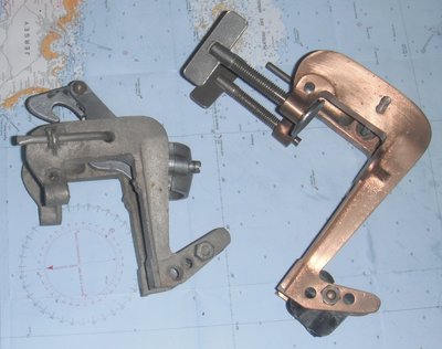

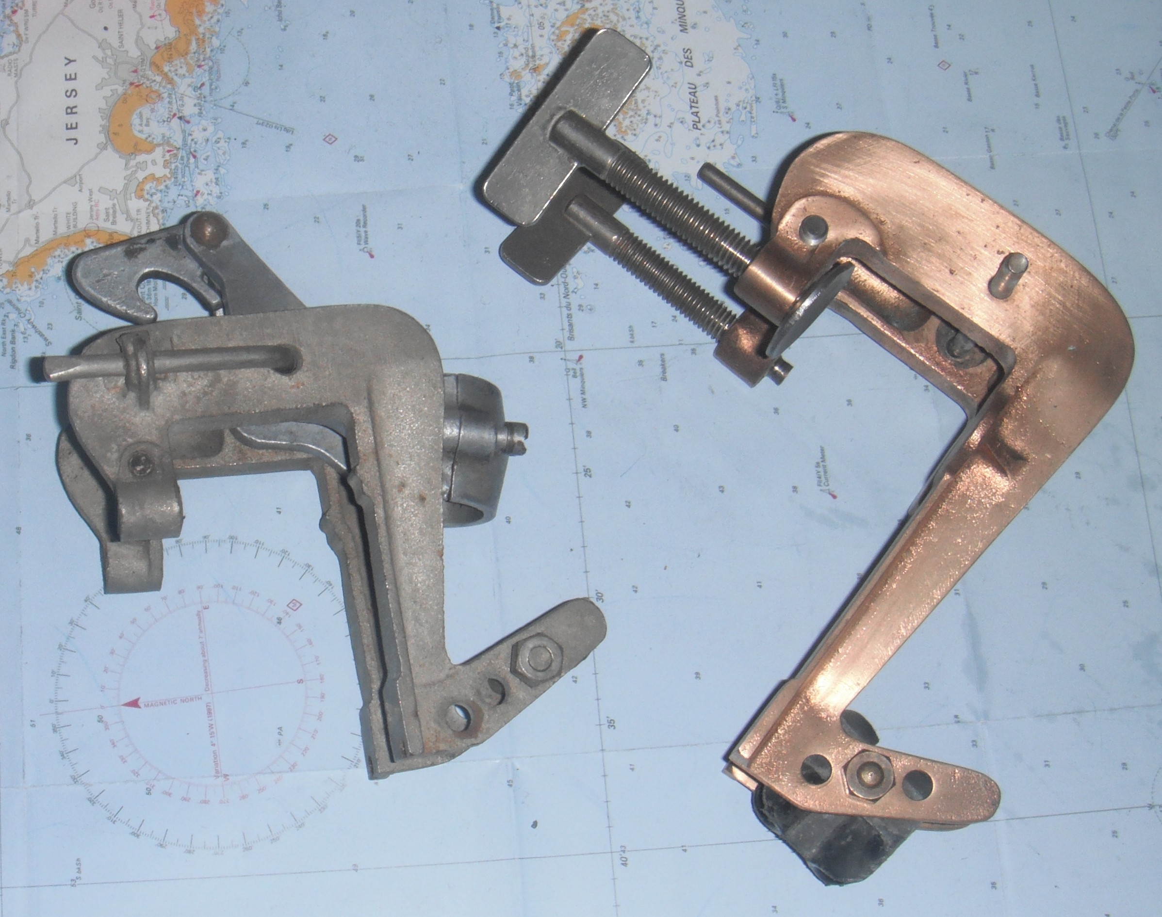

Here's two transom clamps I have...
The one on the right is the later one (obviously) and I've had a go at cleaning it up a bit.
The one on the left was fitted to an FV. It is obviously smaller, but the finish seems odd to me - it is definitely made of bronze but appears to have some kind of plating...or is it just tarnished? I've never seen that before, they normally come to me in a interesting shade of green.
And the other question is...would it have been fitted to an SJP or is the later type more likely?
Thanks.

Martin,
The transom bracket on the left would have probably, I believe been nickel plated. Most, if not all of these smaller 4" ones were plated.
The engine support lug, which it has been fitted to, was introduced at serial number 10000. So that would indicate it was fitted to FV (and possibly FVP and LS) until about serial number very approx. 16000, when the longer 5.4" version was being used. Whether in the period 10000 to 16000, the smaller 4" version was used for just FVs, I do not have the information to know.
Was this bracket originally part of the bits off FVP 10359?
