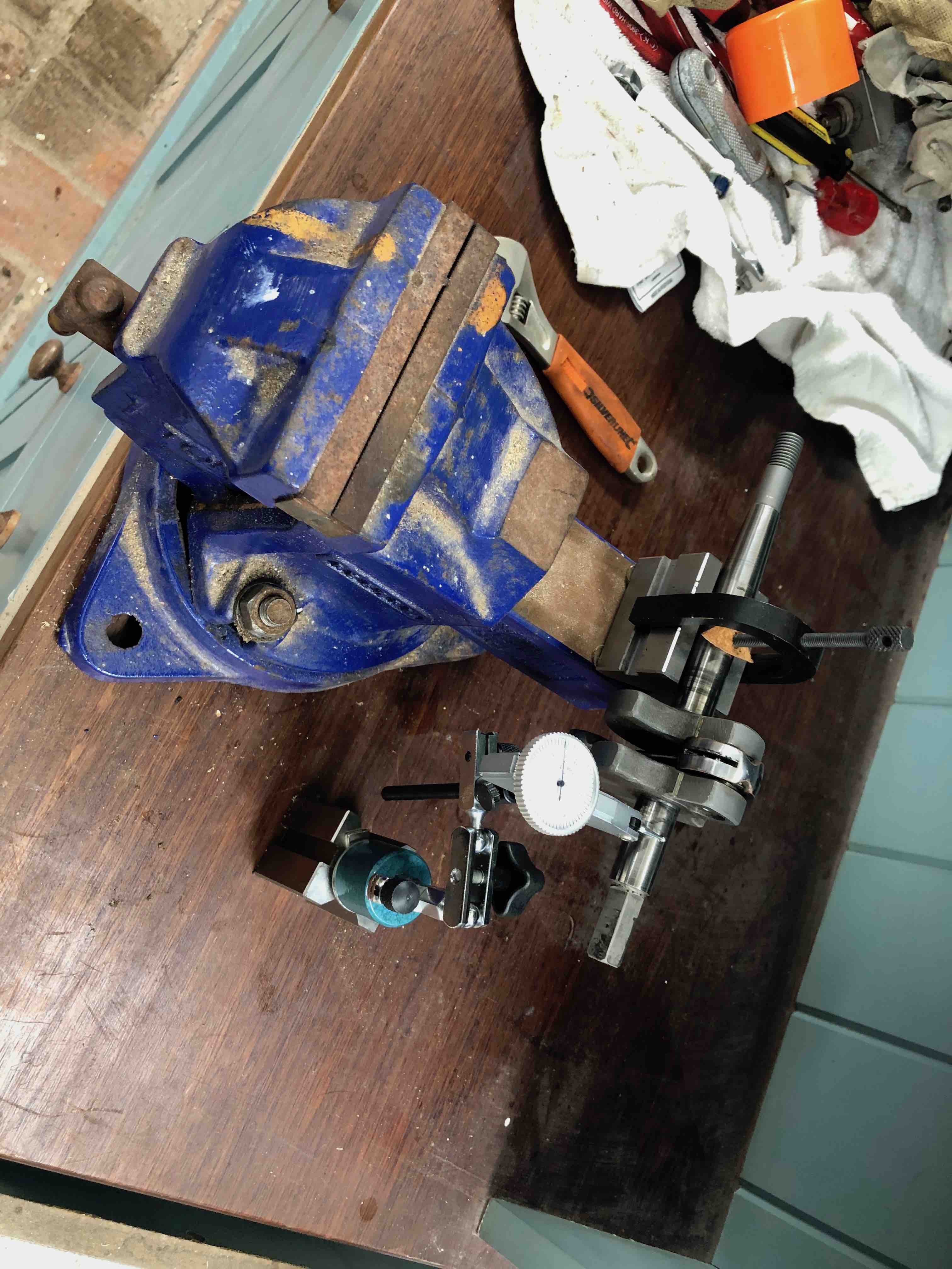

The "rig" is as simple as it could be. 2 vee blocks and a dial gauge. One vee block is mounted on a heavy vice with small neodynium magnets, the other supports the adjustable arm (I think it came with one either the gauge or the blocks) that the gauge is mounted on, again with magnets. The vee block is oiled and the crank clamped down with a piece of oil-soaked leather under the bolt end, tight enough to hold it securely but so you can still turn the crank. In the picture I have the flywheel end in the vee block and am measuring the runout on the driveshaft end. I then turn it end for end and measure the flywheel end.

It is very much a lash-up - it should all really be on one solid base. But its a start. I try to compensate for the random error caused by the rig moving by a thou when I rotate the crank, by taking multiple measurements at different points along the shaft. Bend should show up as increasing runout the further you get from the bend. Rotational misalignment should give a constant reading along the shaft. (Assuming the shafts themselves are not bent).
If you are starting from scratch I'm sure the engineers on the forum could offer some better advice. See earlier in the thread.

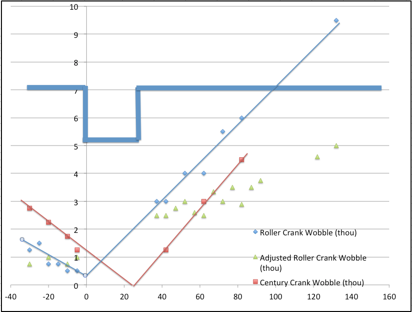

I had a go at measuring a "new old stock" century crank
I have drawn lines on the graph and you can see that the distortion in the roller crank starts where the crankpin enters the driveshaft end web, but for the century crank it is at the other end of the crankpin. I think there is also about half a thou of run-out on the roller crank due to rotational misalignment of the crank web pin holes as the point of intersection of the lines is not on the x-axis.
I gather from the seagull service sheet that the runout should be less than 0.1mm / 4 thou measured between the bearings.
And the century crank is surprising bent given it a supposedly "new" item.

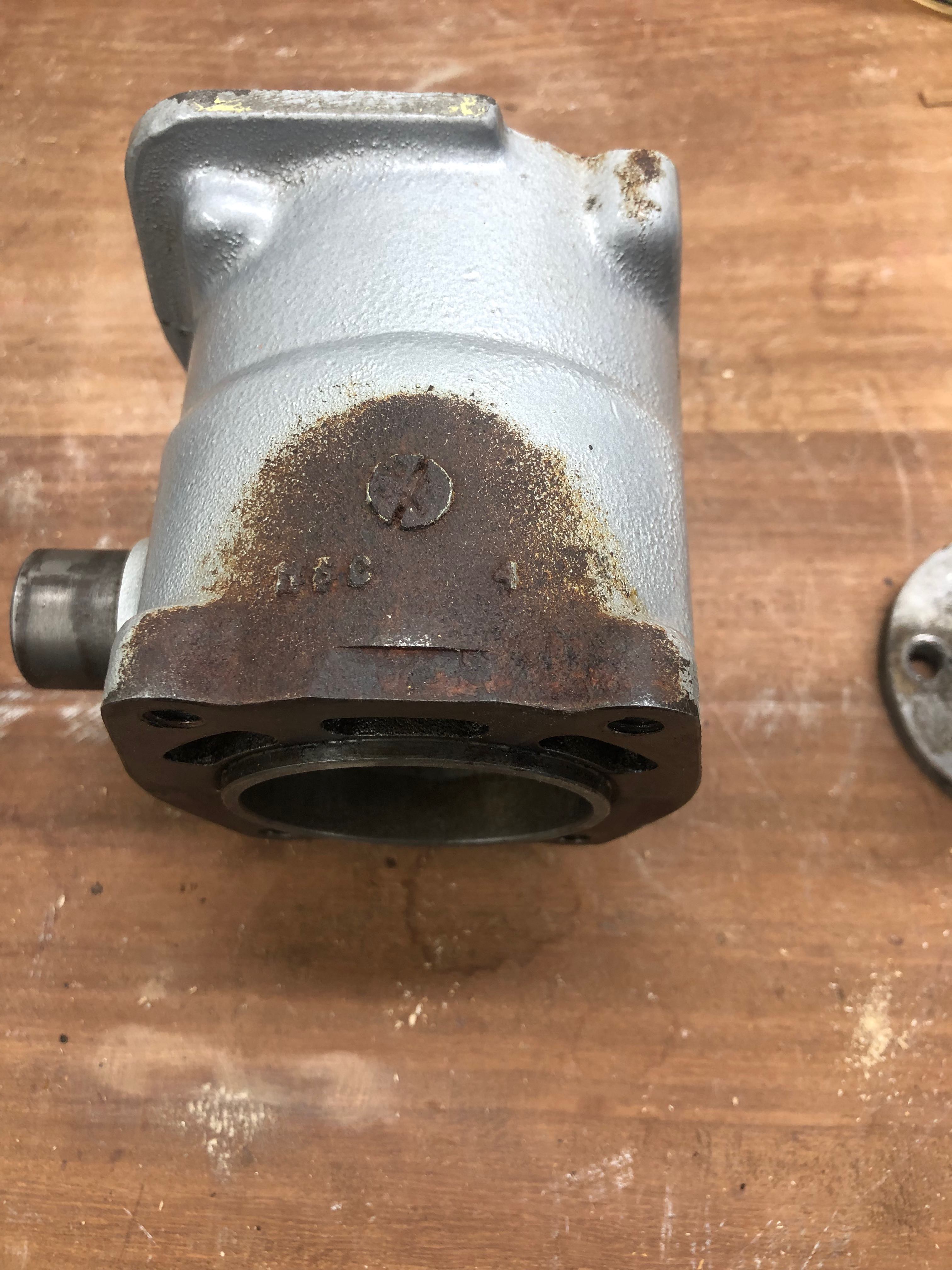

The block has some scorching to the paintwork over where the transfer ports run presumably indicating some past overheating - I can't see how there could be waterways around there so perhaps not surprising but is this something I should be worried about? And what is the core plug for? A casting mould feature? Or does it hide a tiny waterway?

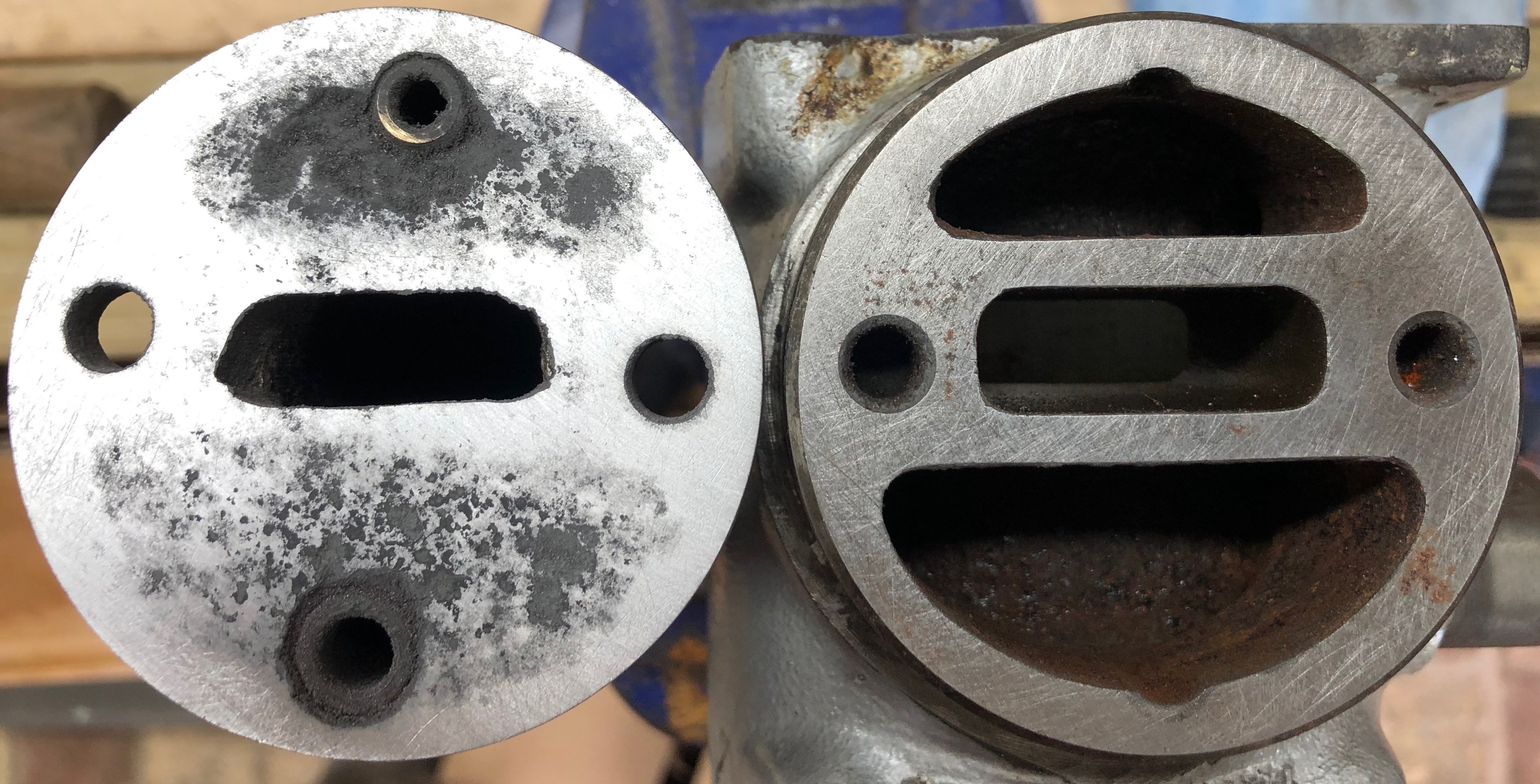

What do people use to seal the inner exhaust flange to the block? The "gasket" such as it was disintegrated on dismantling. The replacement part no. TRN KF 010 does not seem to be available from Sheridans. Any idea what material they are made from?
The replacement plain bearing crank I have is from a Kingfisher and is identical to another one I have from a Curlew. (It is also wonderfully straight with no detectable runout!) The parts book shows them as the same part number for Curlew and Kingfisher. Also the flywheel balance weight is also the same for both in the parts book. This seems odd when the Century and 40 series cranks have different weights on the crank web. Oh well, it makes for better interchangeability but it is a bit of a puzzle.

Put the top half of the crankcase back onto the cylinder , then you'll see why there's no paint in the transfer port area!

Thank-you Charles, I see the problem. The scorched area is crowded by the flywheel housing. I can just detect similar scorching on my (still fully assembled) Osprey if I look carefully, although it is hard to see given how tight it is.

I have also tracked down the material for the exhaust gasket by comparing with the part for the Curlew. It was "Flexitallic SF2400 compressed fibre sheet", ca 1mm thick. Described as an "aramid and inorganic fibre sheet sealing material bonded with nitrile rubber". Rated to 225C & 51 bar. I have found something similar on the RS components web site (albeit pricey). Any thoughts on cheaper alternatives anyone?

Cut a coloured paper gasket using a scalpel & the cylinder exhaust flange as a pattern, then take a photo of the paper lined up with the inner exhaust bolt holes to show your readers how disgracefully this inner exhaust fits.
The gasket doesn't need to be made from any material that's too sexy, it's only hot around the exhaust & must not be damaged by water as it's fully immersed.
