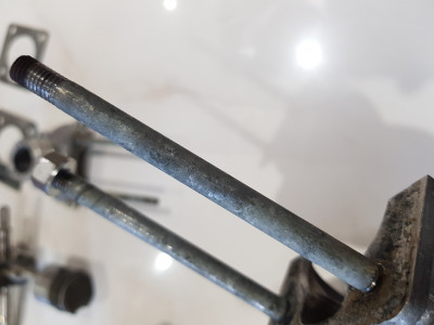

Galvanised studs have no rust and gaskets are rust free, look like they are galvanised or tin plated.

If it was Zinc on these gasket plates it would be the first thing to corrode galvanically.
Do any of our readers have ready access to an XRF so we could find out for sure?

Yes that's right, but as soon as you have some reactive iron available to the electrolyte then the Aluminium will also become an anode & we've all seen what that does to the head & crankcase.
It's very difficult to say for sure, we're talking about the very late 1940's early 50's, severe material shortages, if these plates were hot dipped individually, then tin becomes a stronger contender as H-A suggested, much lower melting point & almost everything you had in the store cupboard was in a tin coated sheet steel container so the technology was readily available as was the 18 gauge sheet steel.

My FV studs are almost certainly hot dipped galvanized, as you can clearly see the crystaline structure of the metal, also it is a relatively thick coating and irregular.
Gaskets have a thinner coating of grey metal, and the sides of the gaskets are plated. My guess would be electro plating as dipping would give variable thickness, not what you want on mating services.
The cylinder was also plated under the black paint, this was not primer but dull grey metalic plating.
Was electro plating being done by seagull or did they farm it out?, I have transom brackets that are plated, and don't forget lots of the nuts and bolts are plated.
I would not rule out Zinc on the gaskets, but analysis will be needed to be conclusive.
