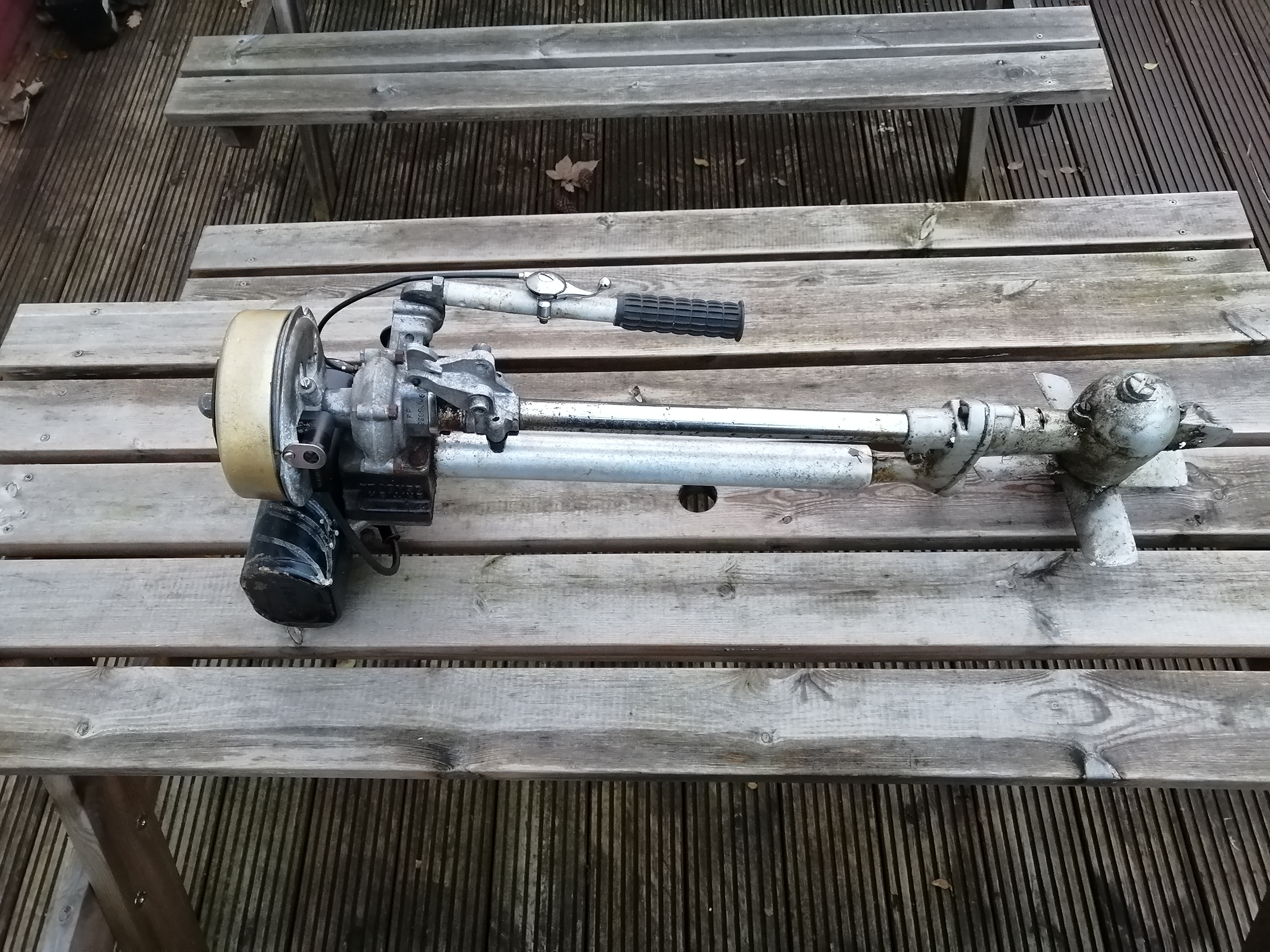

- I am hoping to find a manual for the 40 Plus, so I can read a bit more about it. In the meantime, could you please let me know what material is the seagull made from? Is it aluminum on the shaft? Is that brass on the top spinning thing (what do you call it? )

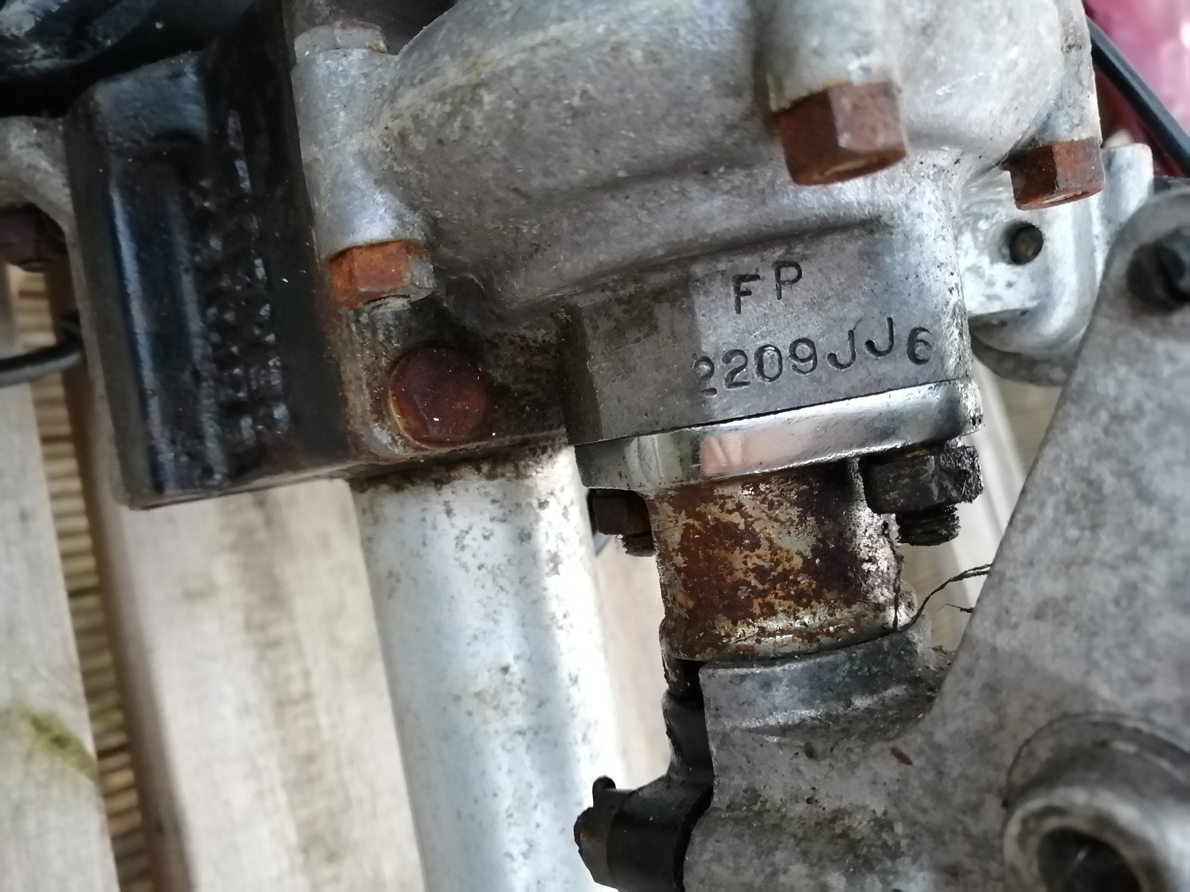

- What would you use to clean the oil ? What would you do to remove the rusty spots (for example in photo N7)?

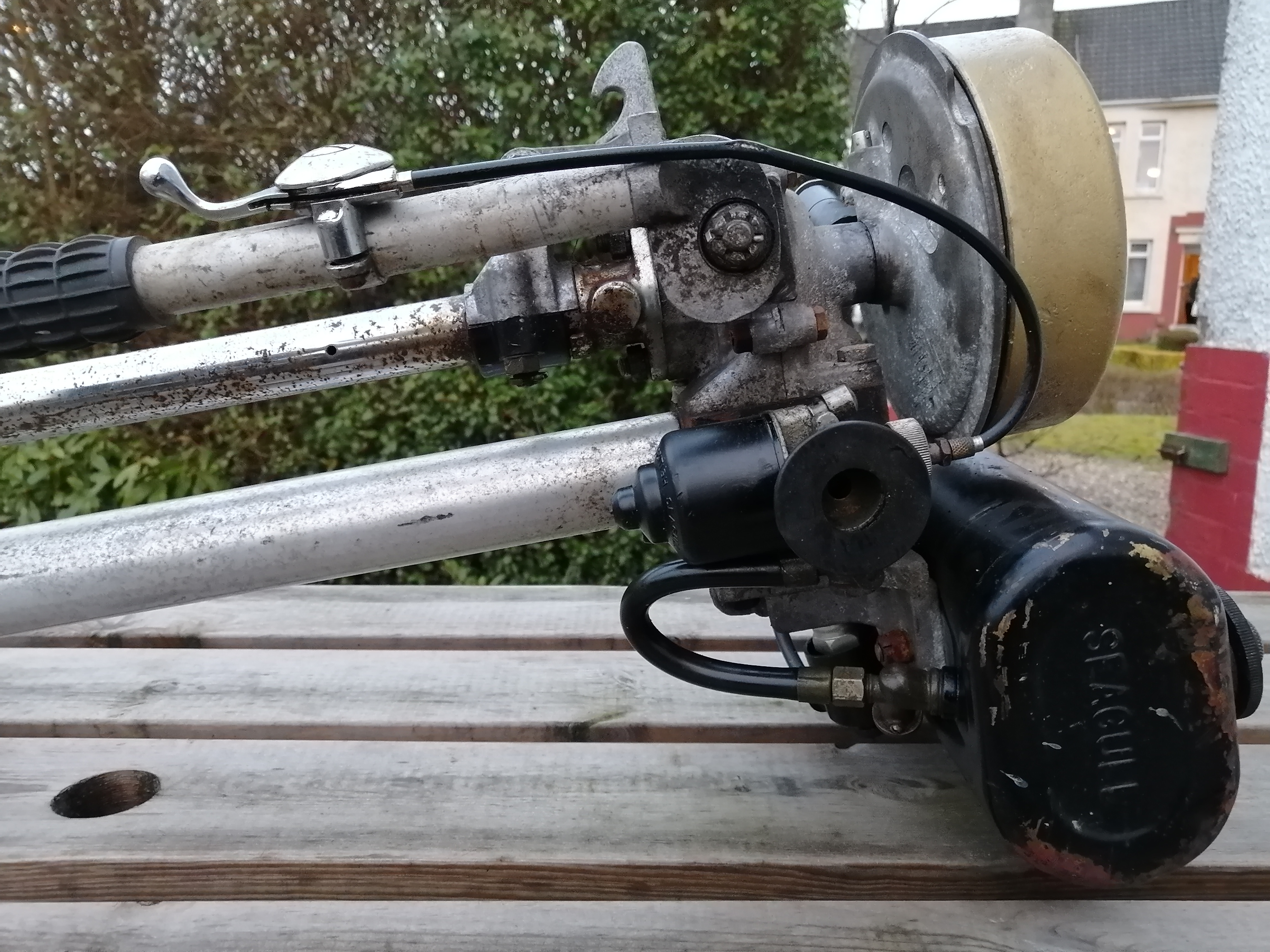

- I read a lot about the Villiers carburetors, I believe mine has this type - correct? Is there a choke on it?

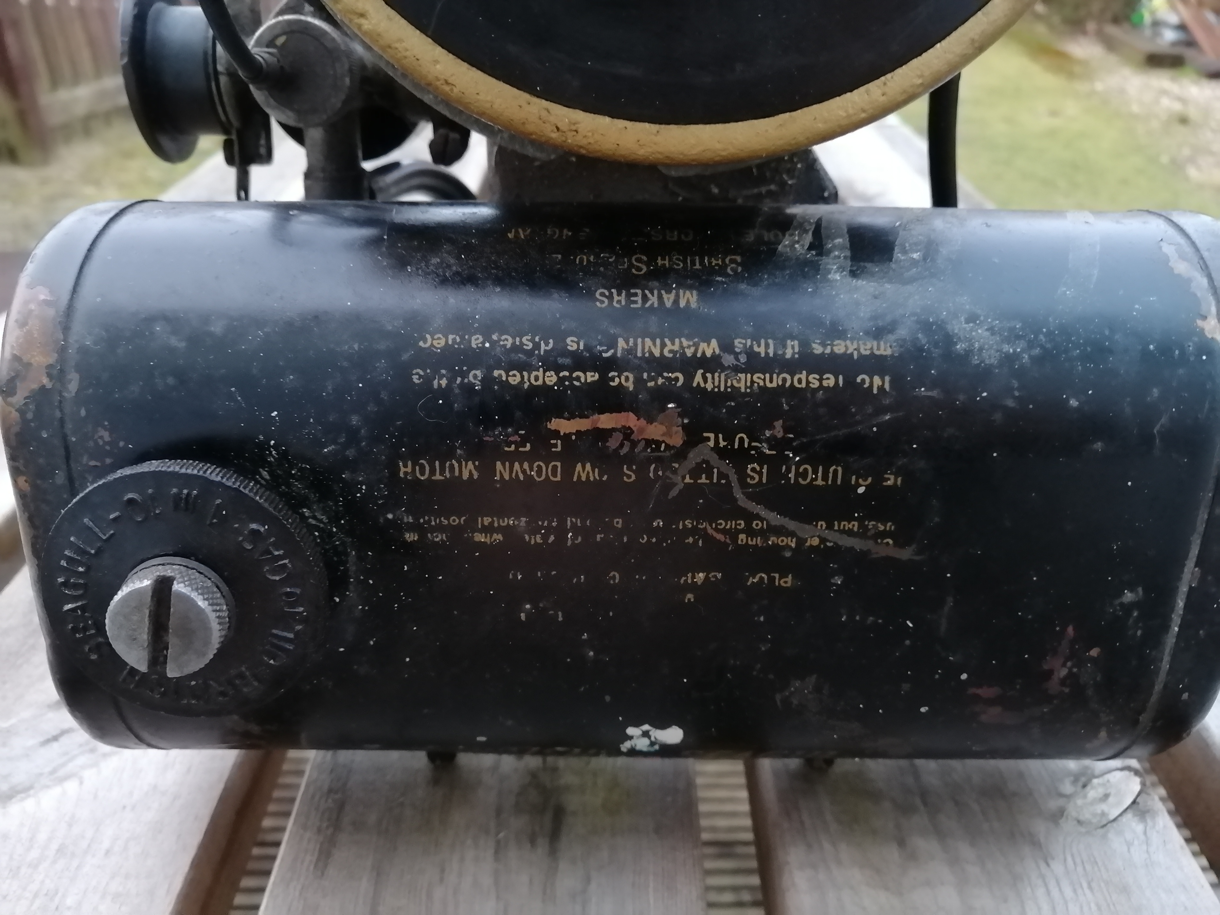

- Does anybody know what it used to say on the top of the fuel tank?

Your motor has a Villiers carb, the choke is a flat metal plate that pivots between the air intake and the main body of the carb. In the closed position it covers the air intake (choke on). Pretty much as soon as the engine starts open it fully for the motor to run freely.
There is no clutch on your motor. On models with a clutch there is a short lever attached to the crankcase and a linkage rod to the gearbox.
Both my motors were in a similar condition to yours, when I acquired them. I cleaned them up with a rag dipped in the same fuel and oil mixture that you put in the tank. That got most of the gunge off. Because I intend to use my motors on boats, I will not be trying to restore them fully. I polished the worst of the rust away with AutoSol chrome polish.

The top spinning thing is the Flywheel, it’s made of aluminium and is painted a sort of Gold.
It is the Magneto and contains the points (that you can clean and set,) the coil and associated magnets.
The large diameter exhaust tube is made from aluminium, the smaller diameter tube houses the drive shaft it's made from chrome plated steel, it acts as a torque tube.
Yes to stop the engine you just close the throttle.
As you suspect no Clutch, when you are on the water you are away as soon as she starts!

The writing on the top of the tank is just the name and the fuel mix, again John can supply new transfers if you want to repaint the tank.
